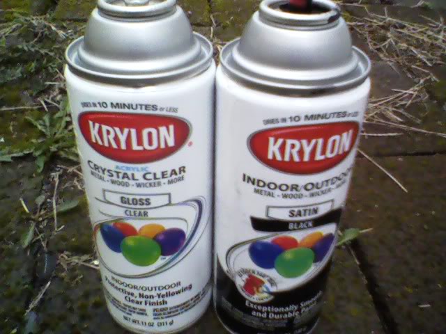

PAINT
I heard of this paint called Nightshade thats meant for the purpose, but I just used regular Krylon spray paint and clearcoat.

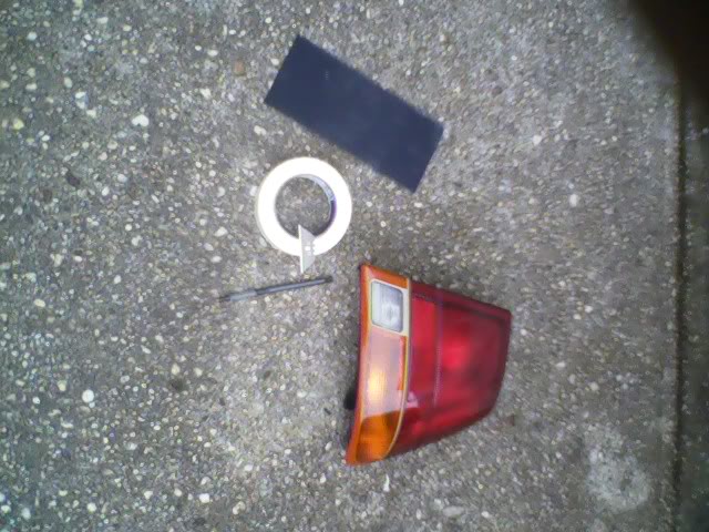

SANDPAPER
Use very fine sandpaper, 2000 grit or so
MASKING TAPE
RAZOR BLADE or Xacto knife
GLOVES(opt)
PEN

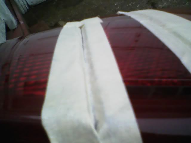

4. Put a strip of masking tape IN the grooves. This is so that paint doesn't flow into them and ruin the design. Do this by pressing the tape on one side of the groove, pushing it down with a pen, and then pressing in to the other side.

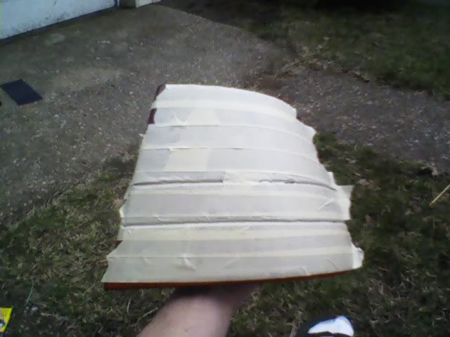

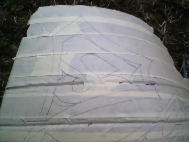

5. Mask off the surfacee of the light, overlapping by about 5mm.

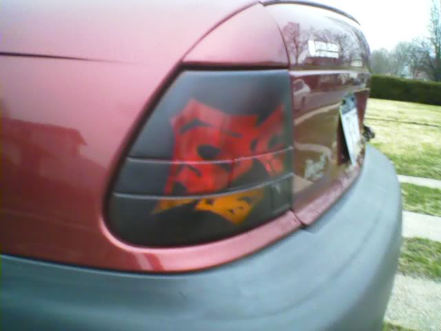

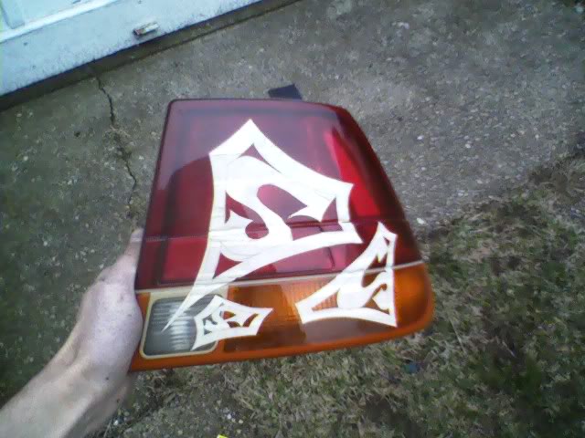

6. Draw the design so that a part of each light (brake, reverse, turning, etc.) is a part of it and will not be painted. I'm going with a superman theme for my ride.
7. Cut out the design with a razorblade and take off the rest of the masking tape.

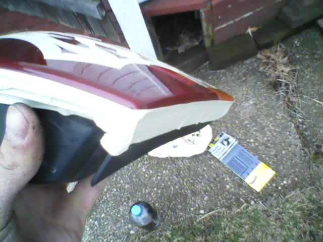

8. Mask off the edges of the assembly. This way you will have a neat line around the edge and will look professional.

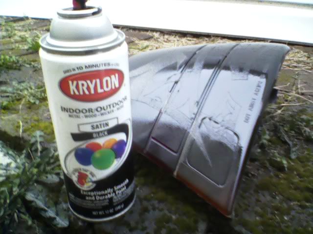

10. Spray from a distance, using quick passes. If you spray too much in one area, it will be too dark or worse, drip. Do 2-3 coats, let each dry 15 mins. Then, take off the masking tape.
***Before doing another coat, hook up the lightbulbs to test how bright the look.***

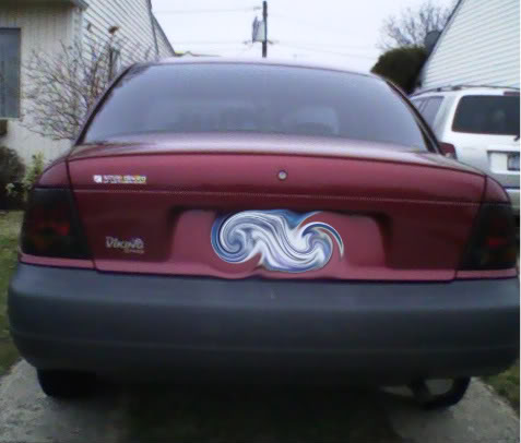

Some more pics:
