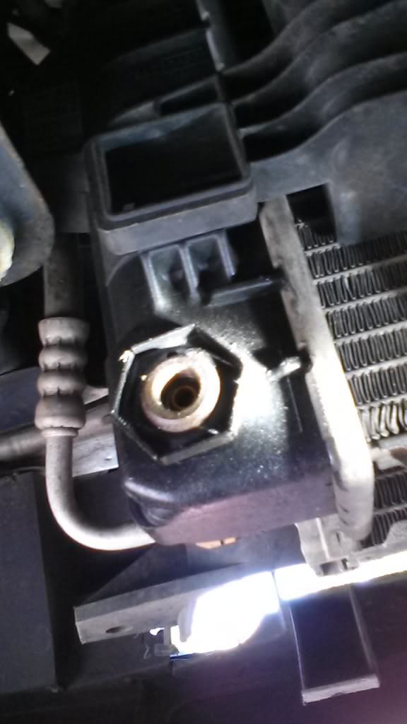

I don't have a plastic tank on the drivers side that I can see. The only fluids that I can tell aside from some wet around the head is on an opening near the bottom of the radiator. couldn't see to well today.

If not the bottom one shown above then probably the top one that failed on my son's car.

You must have a manual transmission unless you disconnected the AT cooler line. That is the bottom port for the cooling line form the AT and it is in a plastic end cap. To the right you see the fingers of the aluminum core that are clamped around the plastic end cap and there is a rubber gasket between the plastic and the aluminum.
Even the manual transmission cars come with the AT cooler, you just don't use it. I guess it is cheaper to use a radiator for AT across the board instead of stopping production to switch over to a manual transmission version of the radiator. All manufacturers seem to do this now.
I can't tell from the picture where the actual leak is.

The pic I posted was the only wet spot under my hood around anything to do with the coolant system that I could find. And yes, mine is manual. I keep forgetting to specify that I'm just so used to only driving them sometimes I forget there can be differences.
