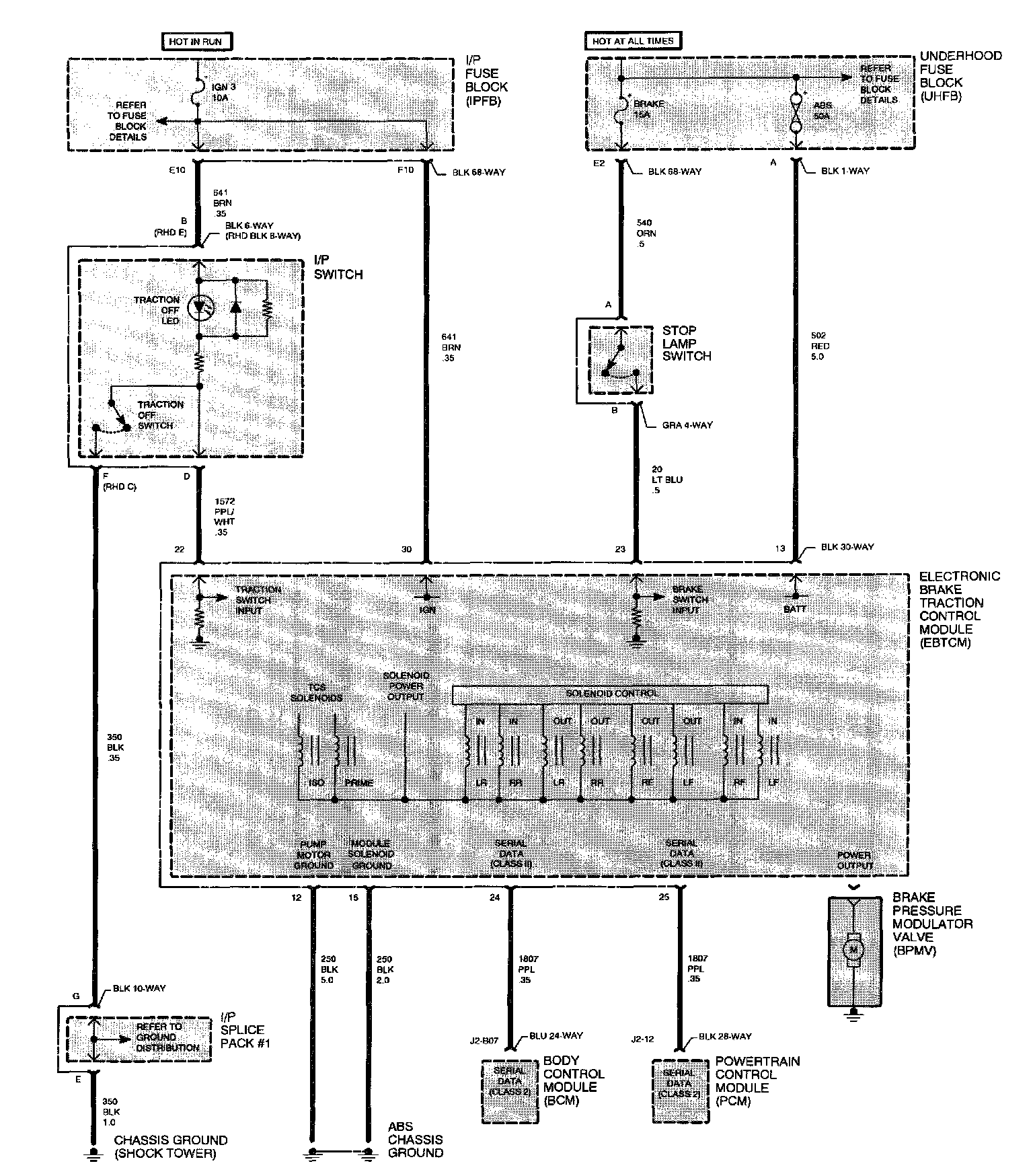

I have a 2002 SL1. Both of my brake lights (the ones by the tail lights) aren't working. I've now replaced the brake switch and both brake lights and they still aren't coming on. The blinkers work and the brake light in the back window works, just not the ones by the tail lights.

Fuse?
Home >> Saturn >> 2002 >> SL1 L4-1.9L SOHC VIN 8 >> Repair and Diagnosis >> Diagrams >> Electrical Diagrams >> Antilock Brakes / Traction Control Systems
ANTILOCK BRAKE SYSTEM (ABS) SCHEMATICS (LEFT HAND DRIVE AND RIGHT HAND DRIVE DOMESTIC)
Part 1 of 2
Part 2 of 2
Old Nov 24, 2024 | 06:22 PM
Posts: 12,410
I fail to see any bulbs in those

Fuse?
Part 1 of 2
That's a good idea. I'll try replacing that and see what happens.
Part 2 of 2
That's a great idea. I'll try replacing that and see what happens. Thanks.
Old Nov 24, 2024 | 07:04 PM
Posts: 3,308
Look here first. If the high mounted brake light works the switch works. Look at this diagram.
Old Nov 24, 2024 | 08:41 PM
Posts: 12,410
How about parking lights.
Same bulbs but different current source/path
Old Nov 25, 2024 | 08:15 AM
Posts: 5,564
I don't see any mention of checking the fuse box. Did you do that?
