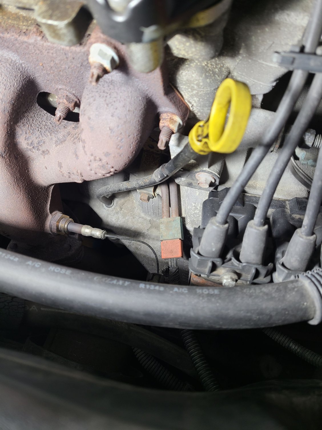

The OEM Saturn block heater for these 1.9 engines was a bolt on style. It is mounted near the oil dipstick tube behind the exhaust manifold.There's an existing bolt hole in the block. I don't know the part number. I bought a NOS one on ebay about 10 years ago for my 2000 SW2. I want to say it was manufactured by a company called Phillips & Temro Industries, but don't quote me on that. They're still in business. I'll post a pic of the heater in the next day or two. Either way, the heater is pretty simple. It's just a heating element with a bolt hole and a power cord. The heating element just sits up against the block. You could probably modify the mounting bracket on one of the readily available ones to make it work.
