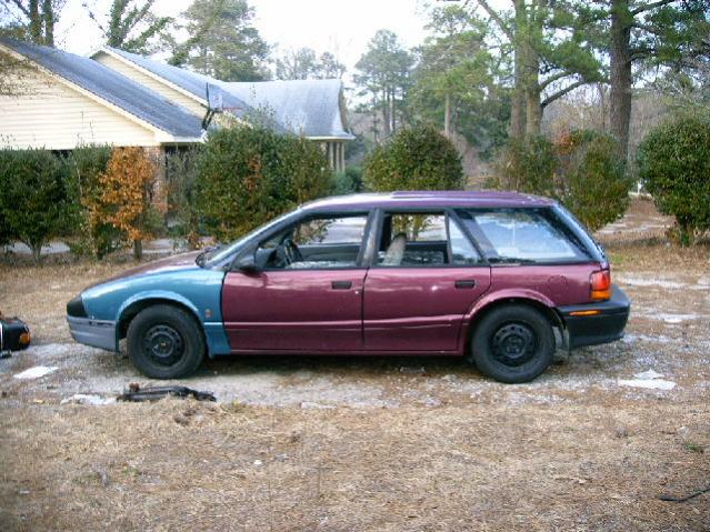

the chain was replaced at approximately 250k or so. about time to replace it again. the reason i want to just get more power from this car rather than get a second one is i like the wagon, alot. i brought 1 complete suzuki titan and most of a second one home from ohio a few months ago, all in the back of the car. i've seen maybe 2 twin cam wagons since i moved here to sc in 99.i figured to get a new motor and trans and rebuild those while still driving the car with the original 1.9l single cam. i've been told that an ecu re-flash might give me the little extra "oompf" i want. any opinion on that idea? again this is the first computer controlled car i've owned or messed with.
