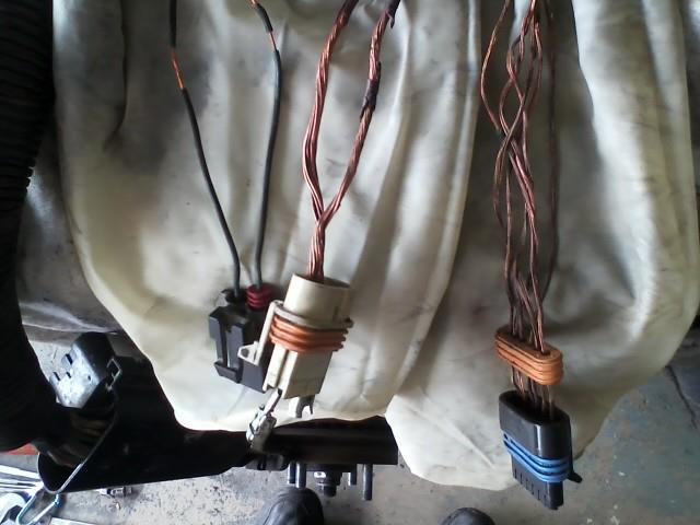

My friend lost 3 and 4 gear to his transmission, so he parked it and shopped around for another tranny. He found a used 1996 transmission locally and I have been helping with the swap.
My question or delema is the Neutral/ Park safety switch connectors have exposed wires. To the point that the 5 to 6 inches of wire past the connector is bare wire on all 6 wires. Has anyone else seen of such issue and causing a transmission problem.

Old Mar 20, 2013 | 02:50 PM
Hmmmm -- I'd hate to have them all "bump together" at once ....
Old Mar 20, 2013 | 04:58 PM
I'd suggest either trying to find another harness at a salvage yard or buying some heat shrink and insulating the wires. I'd tape them individually first and then put the shrink on them.

Found a couple of replacement harnesses at (LINK HAS BEEN REMOVED). Two of them cost $100 plus shipping. They are going to come with higher grade wire as well as 8 inches in length to assist in the repair.

Old Mar 21, 2013 | 03:08 PM
Yep, looking at the photo, I'd have to say you definitely need the new harness'. There's no way I'd even turn my key to the start position with bare wires like those. Let us know how the new ones work out for you.

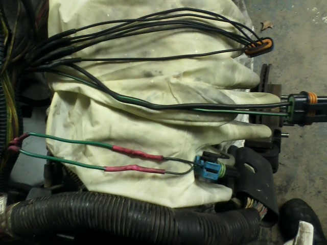

Default Got the new connectors
They came in yesterday morning and was able to install them prior to running to work at noon. The third connector had enough decent wire at the connector so I just soldered in some 16 gage that I had from a previous project.

Old Mar 23, 2013 | 08:15 AM
The big question is whether or not it's up and running and back on the road yet?
Old Mar 23, 2013 | 09:51 AM
Make sure all those soldered connections are environmentally tight and insulated. Would be frustrating to have things go "blooie" after all that work ...
