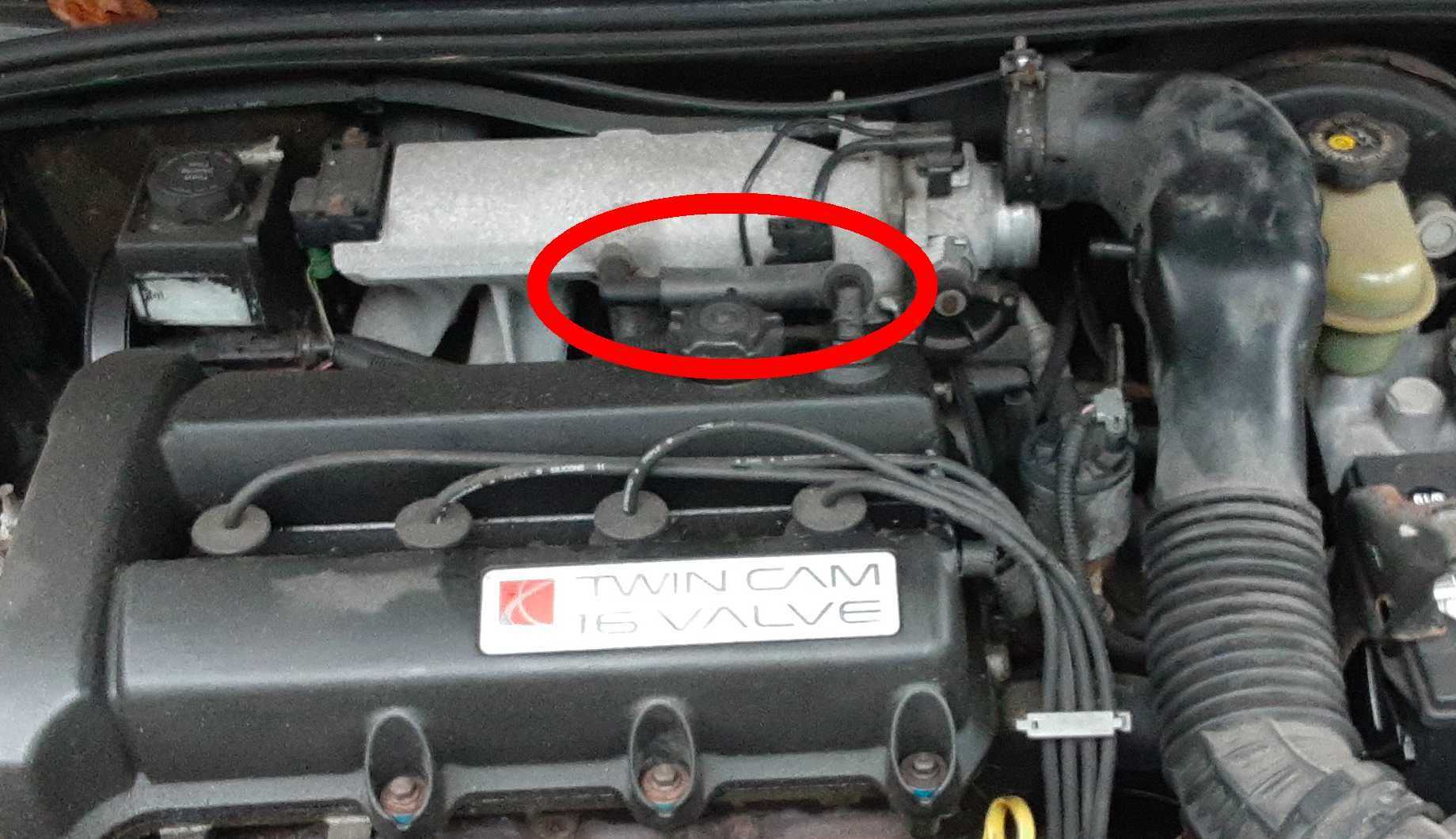

So I thought I'd go ahead and replace the leaking valve cover gasket while I was replacing the dead alternator.
The pcv hose crumbled when I pulled it loose. Too destroyed to put back on.
I'm having a terrible time finding a replacement.
Dorman has one for air duct to valve cover but no one seems to have the one from the pcv valve to the intake.
Anyone have any suggestions?

Yeah, everything seems to direct to that one which is not what I need.
This is what I need and it's as you described Derf:
Unobtanium PCV hose
Unobtanium PCV hose

Here's what I did for now. It's ugly but works.
PCV hose fab
PCV hose fab
The Dorman hose everybody lists is the longer one to the right going from the valve cover to the intake duct.
Definitely not the right part for the PCV.
