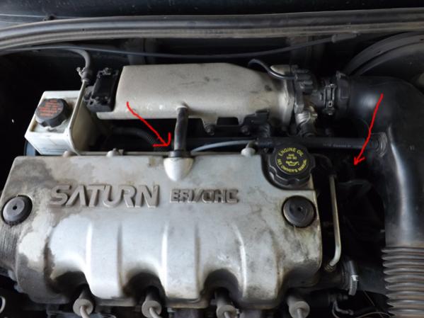

Hello,
I have a 99 SL1 and want to be sure I'm pointing to the PCV valve before I go out and buy one. Also I want to make sure the 2nd arrow is pointing to the ERG valve.
One other question...if I want to clean this engine can I just soap/rinse it at a car wash, or what precautions should I take? Do I need to cover anything?
Thanks!
John

Well I guess it was, cause I already replaced it...
Now I'm moving on to removing the valve cover (as soon as it cools) and replacing the gasket. I'm going to clean it with degreaser before removing it.
Nothing better than working on cars on a holiday huh?
John
