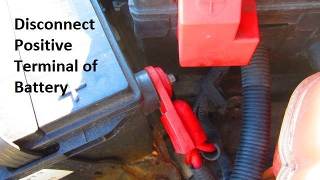

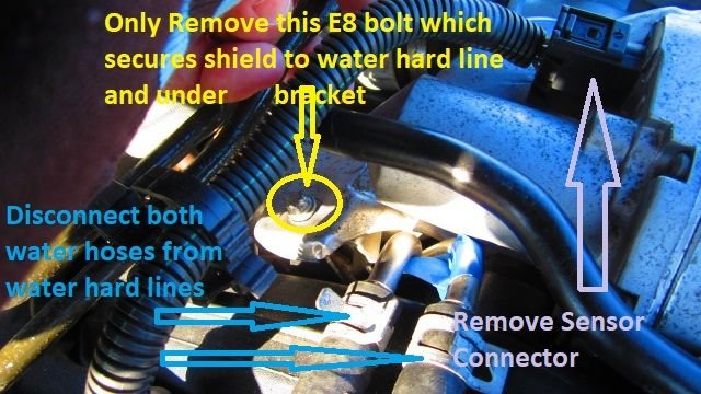

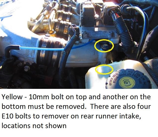

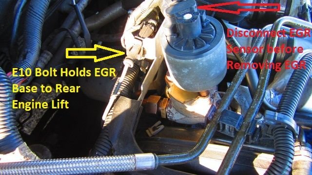

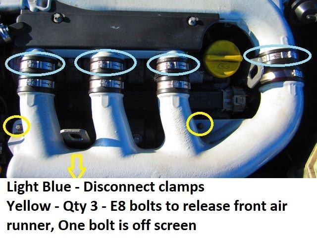

Please note, I referred to the Upper Plenum as the Upper Intake in these photos. Only the Upper Plenum and the runners need to be removed (not the upper intake with the fuel injectors) to gain access to the PCV Module which is located on the rear (drivers side) of the engine attached to the block mid way down. It is tight against the engine attached with four bolts and atv (no gasket). You can see these bolt from the top looking down under bright light.
If your 3.0L Saturn starts to puke oil out of valve cover gaskets and other gaskets, it is likely due to the reed valve inside the PCV Module is broken which results in excess crankcase pressure. I can't tell you exactly how the PCV Module functions but there are two engine ports which the module is bolted above and two vacuum lines to the intake located at the front of the engine. The small diameter vacuum hose has a push on connection to the PCV module routed up underneath items bolted to the top of the rear runner. It is interleaved together so take time to pay attention of the routing(s) so reassembly is made easy. The larger diameter hose is clamped on to the PCV Modular and routed up to the plastic bridge held on with another clamp that is seriously hard to get to much less disconnect.. The plastic bridge connects to a small hose and to the intake on the passenger side of the engine. When the reed valve breaks, these hoses and the PCV Module become plugged with gunk. Once the hoses are plugged, the crankcase pressure blows out the gaskets at the weakest point.
Below are photos showing the location and type of fasteners used for various parts as you disassemble to access the PCV Valve for inspection and/or DIY rebuild. I have more photos on the rebuild process and I will post them at a later date. All the parts interleave considerably and at first you think it is impossible to remove the upper plenum and the EGR base as one piece, but it does come apart just like I say. There are many more items that could be taken apart, but is unnecessary to do so. The few parts you disassemble the better.

When lifting up the Upper Plenum, take your time and if something is holding it secure... there must be another bolt holding it on or something is in the way. It takes some work to wiggle the entire Plenum and EGR base free, but it will come off. All these parts and modules are interleaved together and I believe NO Thought was given toward future maintenance. Hence the lack of detailed information in service manuals. I hope this helps because it was a bitch to learn that much is for sure!
