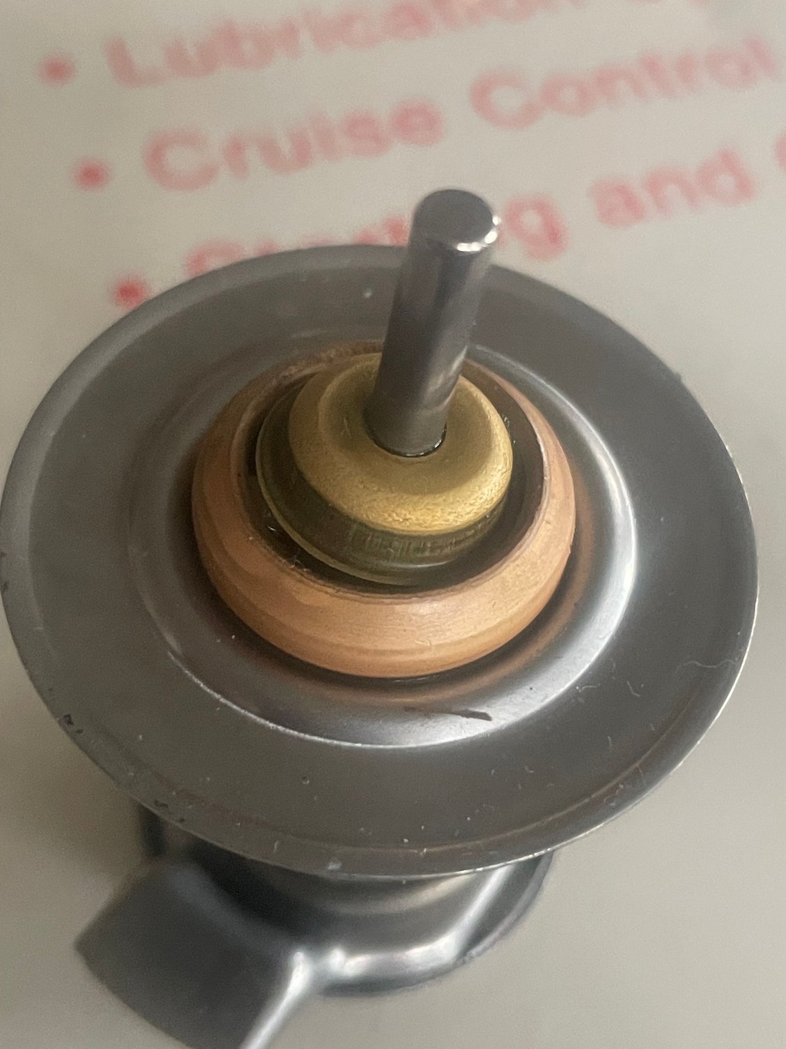

The wagon got hot on the granddaughter this weekend. I was away and they left it at a neighbors house halfway up the hill. Went and got it last night, drove it up on the trailer and brought it home. Runs fine and the coolant returned to the normal level now that it has cooled off. I let it run for a few minutes and the heater hoses felt warm so I don’t expect further issues. This car derates if it gets too hot and it was not driven after derating. The thermostat is in the valley under the intake manifold, so it is another project. More to follow….

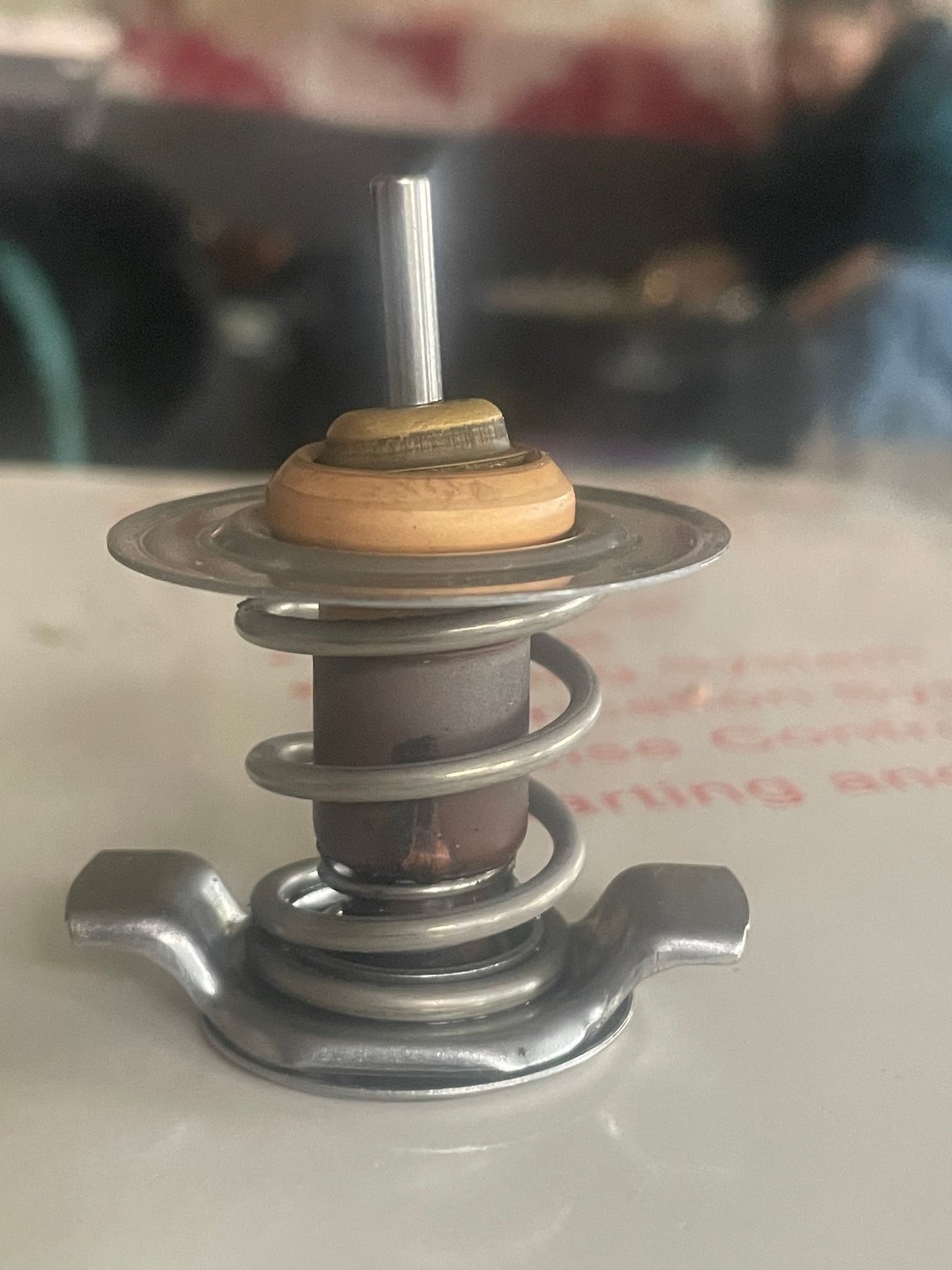

The OEM thermostat is a Motorad, the replacement from NAPA is the same. It comes with the housing, the original failed closed. The top came apart and twisted to the side. The car is back together and 20 mile test drive. The car never lost coolant.
