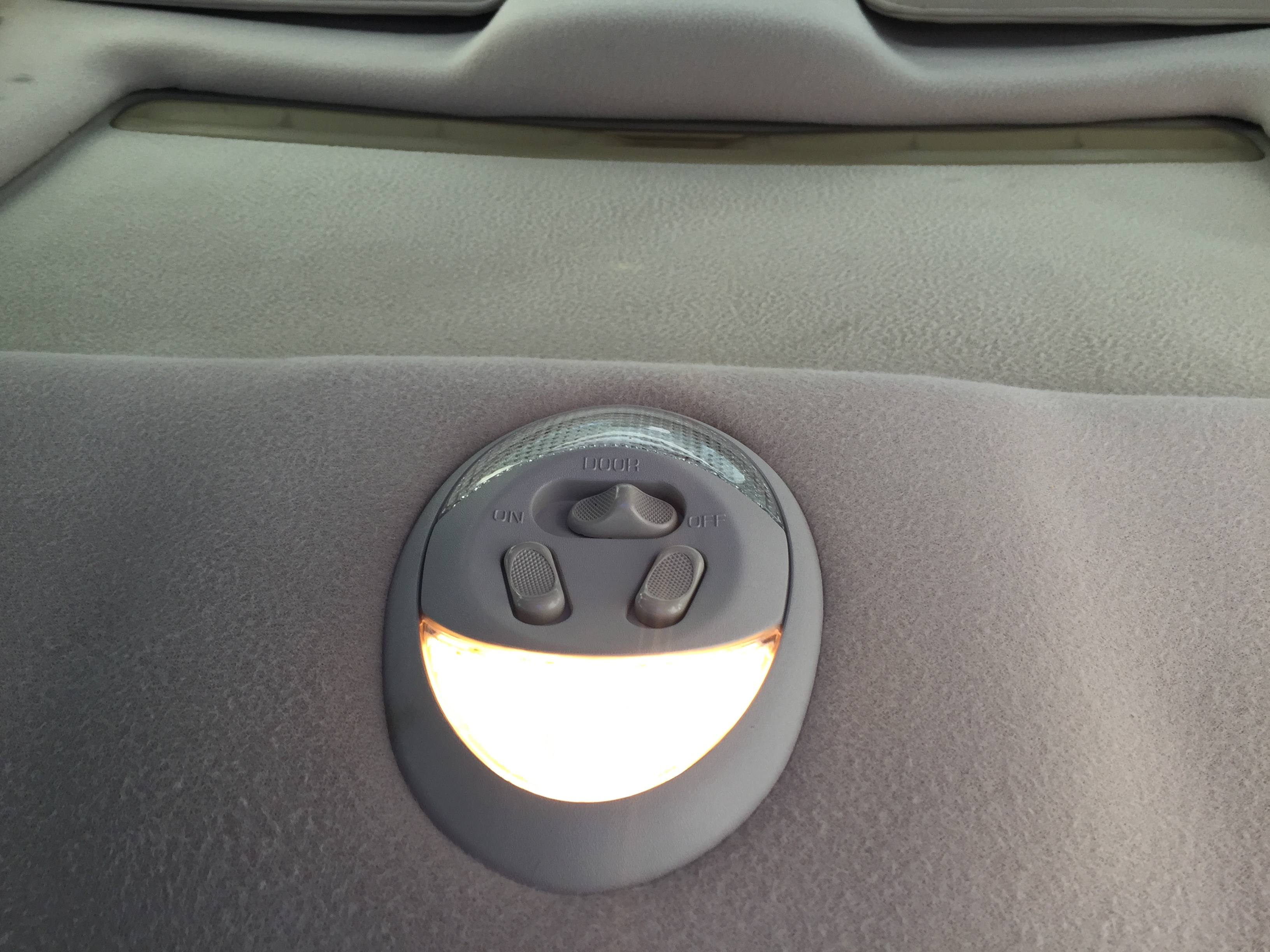

Now the 2 passenger lights work fine. I've checked the 2 BCM fuses in the driver's side and in the front and they are fine. But I still get a 4,5V on the dome light. Does anyone know what happened?
