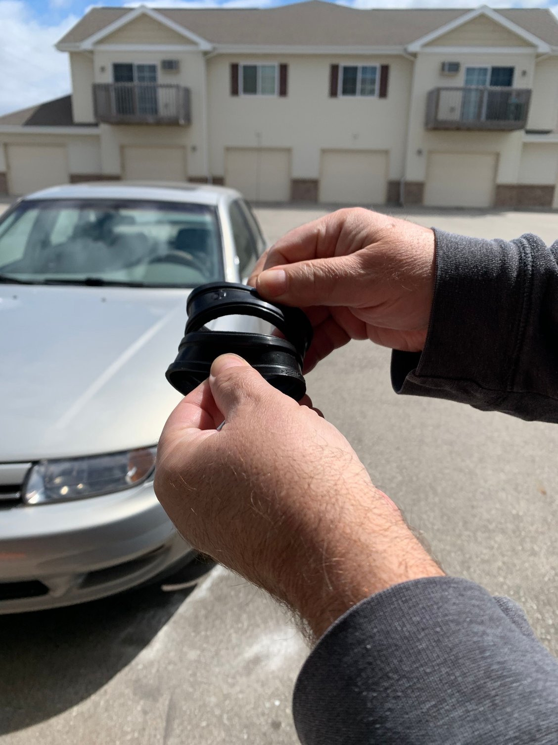

I built a DIY smoke "machine" and found a massive vacuum leak on the front side plenum/runner hose. It had a 2" split in the center on the bottom of the hose. I could see the smoke pouring out. I removed the runner and yes, the hose is split on the seam. I am certain a massive amount of air was being sucked in making all three front cylinders lean and the ECM must have been dumping gas in on those cylinders causing the inability to idle. Hence, the black O2 sensor. When I gave it gas, it over came the vacuum leak and ran smooth, but back at idle it ran very poorly if not stopped.
If you are wondering why I couldn't find that leak by spraying for vacuum leaks? It was so huge of a leak, it wasn't making any hiss noise and I couldn't get the engine to run long enough to spray carb spray around checking for vacuum leaks. IT was a perfect storm, pointing toward the O2 sensor B2S1 when O2 sensor was simply reporting correctly i.e. extremely lean. Thus, constantly lean causing flooding, rich and back firing while running very hot!
Everything makes sense now! Is there any reason why I couldn't simply use a plumbing fitting in place of this hose? It is just air intake and no fuel through this hose, right? What do you recommend?

Splurge for the right size hose designed for automotive use. Can't really go wrong that way. No reason to introduce strange plumbing related variables. My three cents anyway. You've been through enough crap to find this, so go to the last 2 miles of your marathon and put the right vac hose on it. I think you and the vehicle have both earned that right.

Checked four auto stores and none had it. They had 4" intake bellows, but not 3". My final stop was Napa and they provided me with hose that will work for intake purposes. I just want to get it working and then I'll look into get fancy parts for $32 each. I have enough pipe to replace it twice a month for year! LOL I really should cut it and get it done, but I'm too tire from screwing around with baby oil smoker, but hey, it worked!

Default To quote Luke Skywalker... "I T ' S W O R K I N G !!!"
After replaced the main intake hose between the Plenum and the front runner... the engine started and ran perfectly! This is a case of doing too many repairs and Uncle Murphy's (Murphy's Law shat on me numerous times).

I did notice the front O2 sensor was black and the read sensor was white. Everything I was seeing was pointing toward a huge vacuum leak, but where? Symptoms: Engine fails to idle, Runs great at higher RPMs (over comes vaccum leak), black Bank 2 plugs/front O2 sensor. I don't have smoke machine, so I built one! The DIY smoke machine worked okay, but the smell of baby oil was so thick in air as if I changed 100 babies at once! And then I saw it... smoke rising from under the front bellow hose between the plenum and the front runner. I immediately remove the front runner and found a slit about 2" long! WTF!!! The front bank was sucking air like a fish out of water!
Conclusion: The B2S1 O2 sensor was reporting LEAN LEAN LEAN and the ECM was dumping gas into Bank 2 causing the massive rich condition turning everything on Bank 2 black. Also, it was likely causing massive over heating in the exhaust pipe blanching every dip of oil in to dust! It all made sense now. The rubber hose failed and you couldn't see the failure unless you got physical with it. Some days it would run slightly better than other likely based by mere happenstance.. causing me to run in circles!
Before anyone says... How the heck could you miss that? The tear/slit/rip was on the bottom of the hose. When the hose was on the vehicle there was no evidence there was a hole in the rubber. There was no vacuum leak noise as I was rarely was head-under the hood while idling. Also, I was unable to perform a vacuum leak test i.e. spraying carb spray around under the hood because the engine would not run without me throttling the gas peddle and keeping the RPMs well above an idle. Also, the front runner and the plenum, they actually touch and the hose simply bans them together, but this was way more than enough to cause MAJOR symptoms out of happenstance running me in circles for months! I likely ripped the rubber hose just after I found the misplaced front valve cover gasket and never noticed it.
Suggestion: Any time you remove the runners for whatever reason... do a complete and thorough individual inspection to verify their integrity! This hose failure made the engine sound like a bolt was inside the engine as it buck like a wild horse and would not run an idle. Because I dig so deep in to this engine (first ever experience with Saturn), I had my hands full and on so many different things, wires, modules, replacing several gaskets while isolating and testing sensor galore... it had me chasing my tail while under massive pressure before we bought the new car. Well, every 20 years isn't bad between car purchases and I did learn a ton of good information about the Saturn. I also increased my tool crib significantly with Wife's approval... a code reader, air compressor, borescope, compression test kit, misc unique tools for Saturn maintenance and a DIY smoke machine which saved my butt and was the least expensive tool ever! I have to thank my wife for not allowing me to junk the Saturn! If it wasn't for her I would have junked it and believed I kill it. But now I can continue to restore her baby and possibly put Collector plates on her! The Saturn, not the wife! But, she's a keeper! Happy endings once again!
