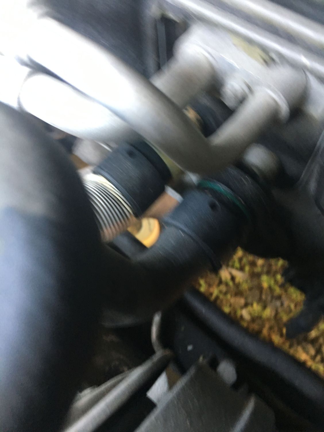

Here’s a pic of the hoses...I think it’s the one on the right that’s leaking!

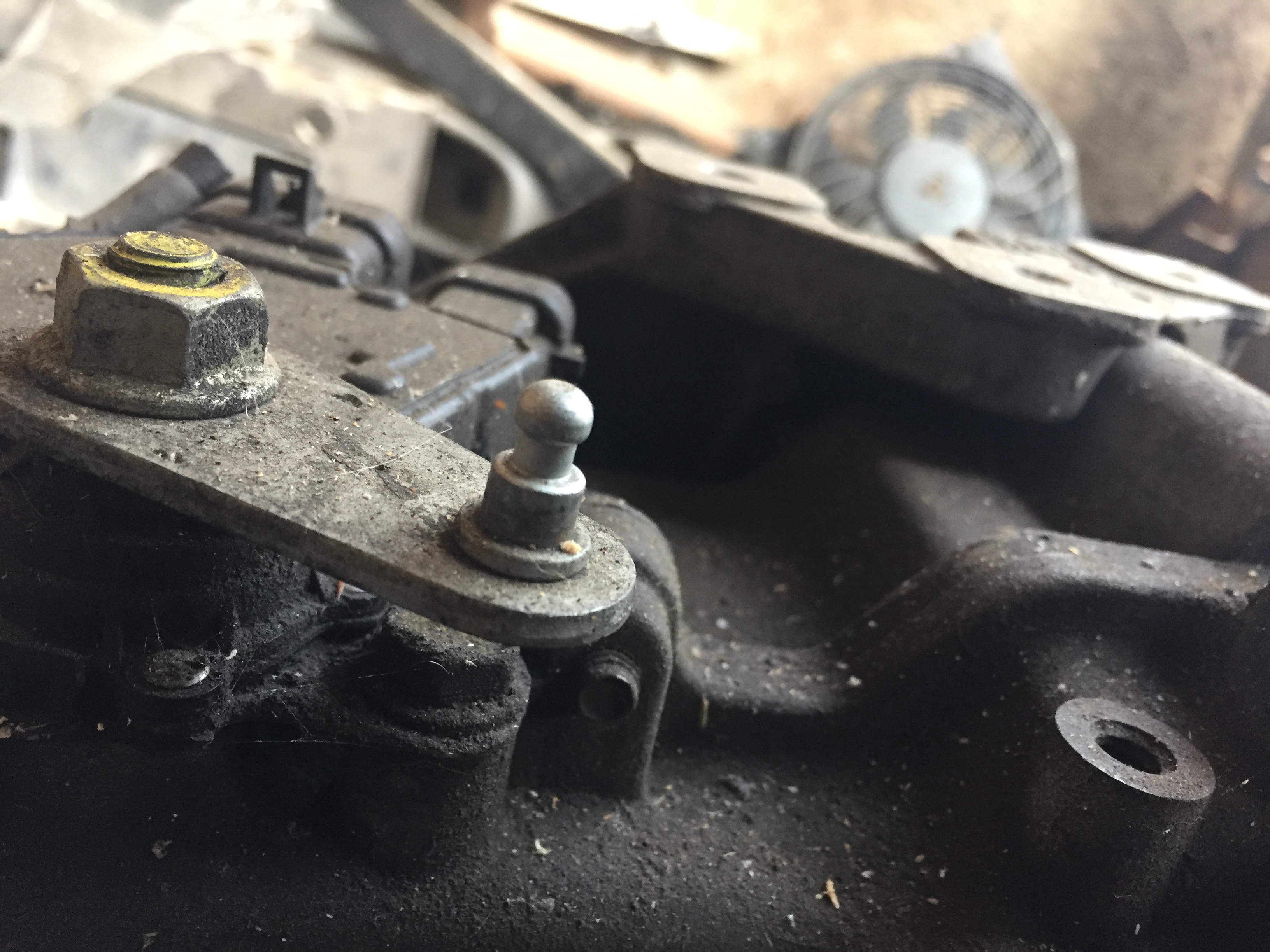

Yes...it looks a whole lot like that one! I actually had time to look at it better today & figures out where it came loose & it was the cable end that is under the hood! I’m not exactly sure what held it on before...I’m assuming some type of cap (of sorts) but I’m working on a homemade solution at the moment! To answer some of ur other questions tho, the car wouldn’t start...the key wouldn’t even turn until I reattached the cable & put it in park! I removed the shifter cover the other day to see if the problem was there & figured out how to move the white plastic safety piece that had the shifter locked in park so when I found where the cable came loose today, I shifted it down to line up with the cable & put it in park which allowed me to actually start the car! I could probably drive it as is but may have issues with it popping off again since there’s nothing really holding it on there! I’ll let ya know if my homemade solution works & thank u so much for responding! I’m gonna keep u on standby for future issues if that’s ok! In fact, I have a question for u...there r 2 hoses that r about an inch-inch & a half in diameter that come out of the “under the hood” side of the dash just above where that cable comes out! One is leaking what looks to be water (sorry I’m not real good at actual terminology)! I’m thinking they may be to the heater core but not sure! Is that something I should worry about...maybe fix right away & if so, what would I need to fix it?

Let me go look, I think there is a clip. The top two aluminum pipes are a/c, the large rubber hoses are heater. The air conditioner condensation drain is between and directly below the heater hoses. It will drain water on the ground, this is normal. If you are leaking coolant which I doubt it will be a different color and the radiator tank will be low.

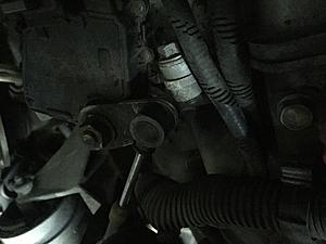

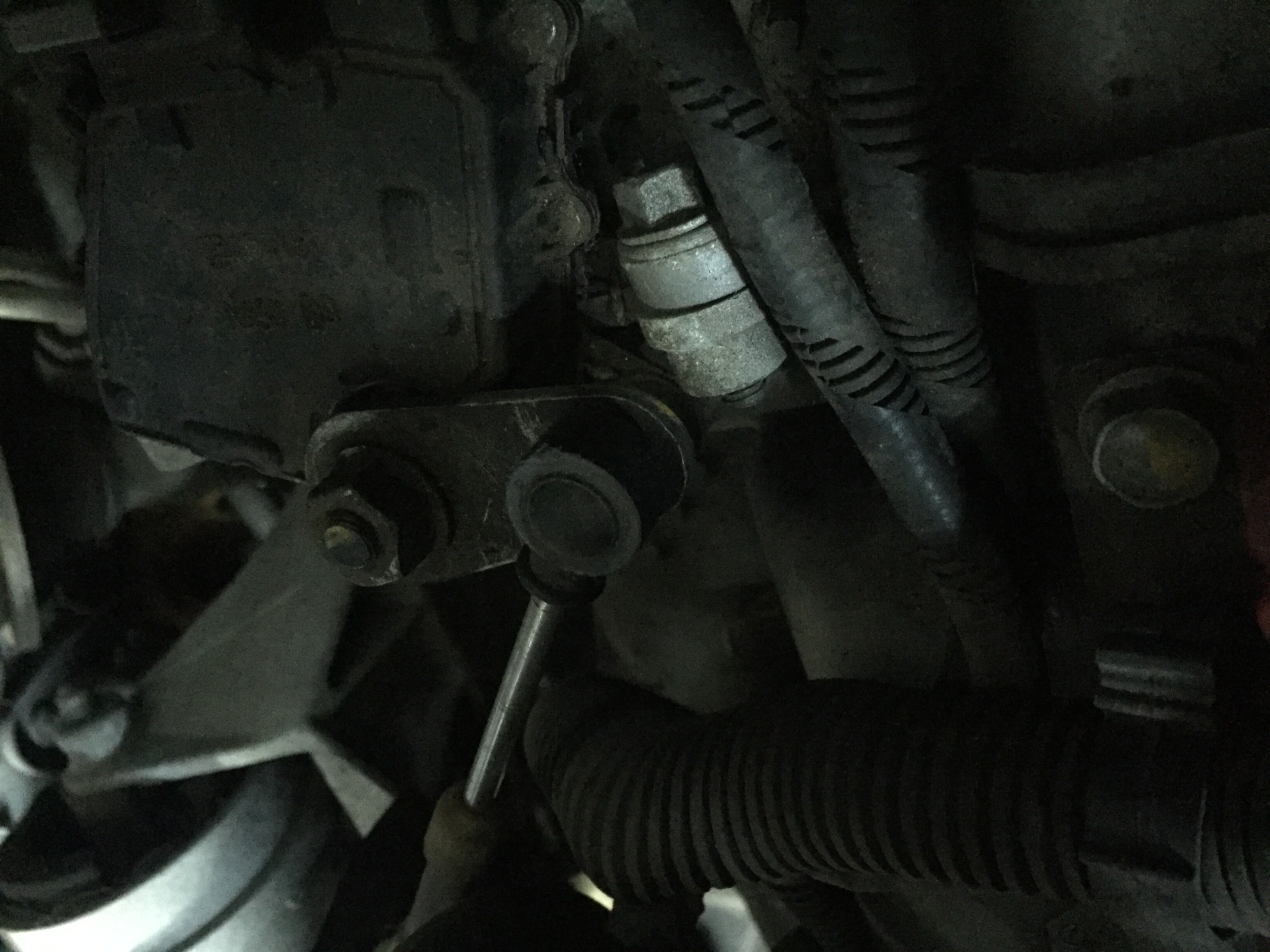

It is a ball.
Attached Thumbnails New member...just checking in!-133b2874-1de3-494c-93bd-f42ea8337ab9.jpeg   New member...just checking in!-9d7fc27c-fa06-4db6-bdc5-63f520f25cdb.jpeg
Old Jul 29, 2018 | 08:47 PM
Posts: 3,308
A dorman 14055 transmission cable repair kit might work. It fits a Chevy Cavalier and they use the same transmission.

As for the hoses, they do have clips on them & I saw the ac drain too but the ac doesn’t work in this one & it does lose a little radiator fluid! Do u think if I replaced the hoses it would stop the leak?

Do you see the leak on the ground? Usually it is the water pump that leaks first on these cars. If it is leaking from that hose it has a release built into the hose end itself. It is sealed by an o-ring at the heater core end. There is a spring clamp at the engine end. There is probably a you-tube on how to release the heater core end.
