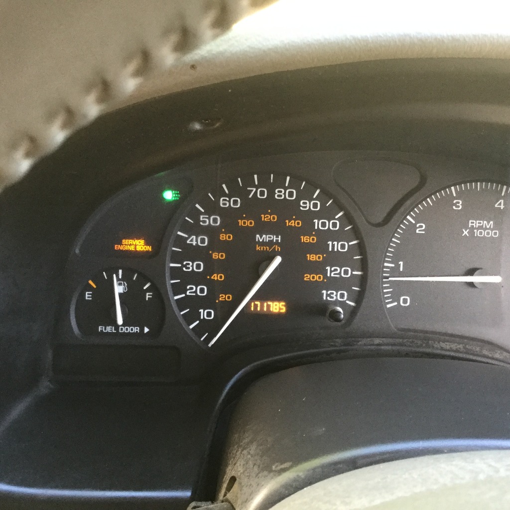

I switched stereos between the gold car and the wagon today. I will sell the single cd stereo with the wagon. The aftermarket stereo has a input on the front for an iPod, I think my grandson would prefer this. I decided to get into the egr issue with the v-6, the car runs great with the egr disconnected but the service engine soon light is on. I removed the upper intake manifold to see how the egr went into the engine. I thought it went into the lower intake and entered near the injector. I was wrong, it enters the upper intake just behind the throttle plate. It has a port that I was able to tap and install a 1/4" pipe plug. I drilled a 1/16" hole in the plug to allow some egr. I reconnected the electrical plug on the egr valve and the car still runs ok and THE LIGHT IS OUT. Now I will clean and list the car on Craigslist.

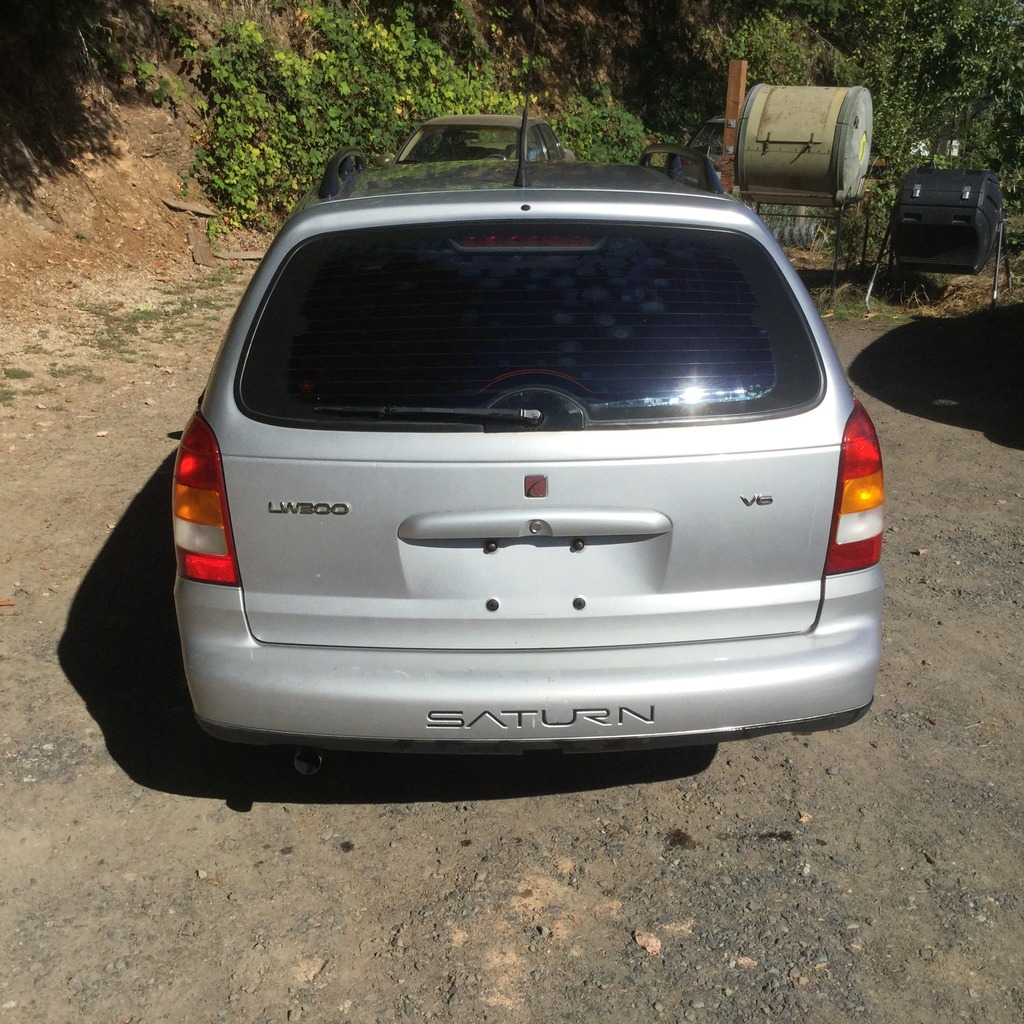

Old Sep 25, 2016 | 08:34 PM
  #58
Posts: 3,308
All cleaned up and listed on Craigslist today, the first reason wants to see it Tuesday.
