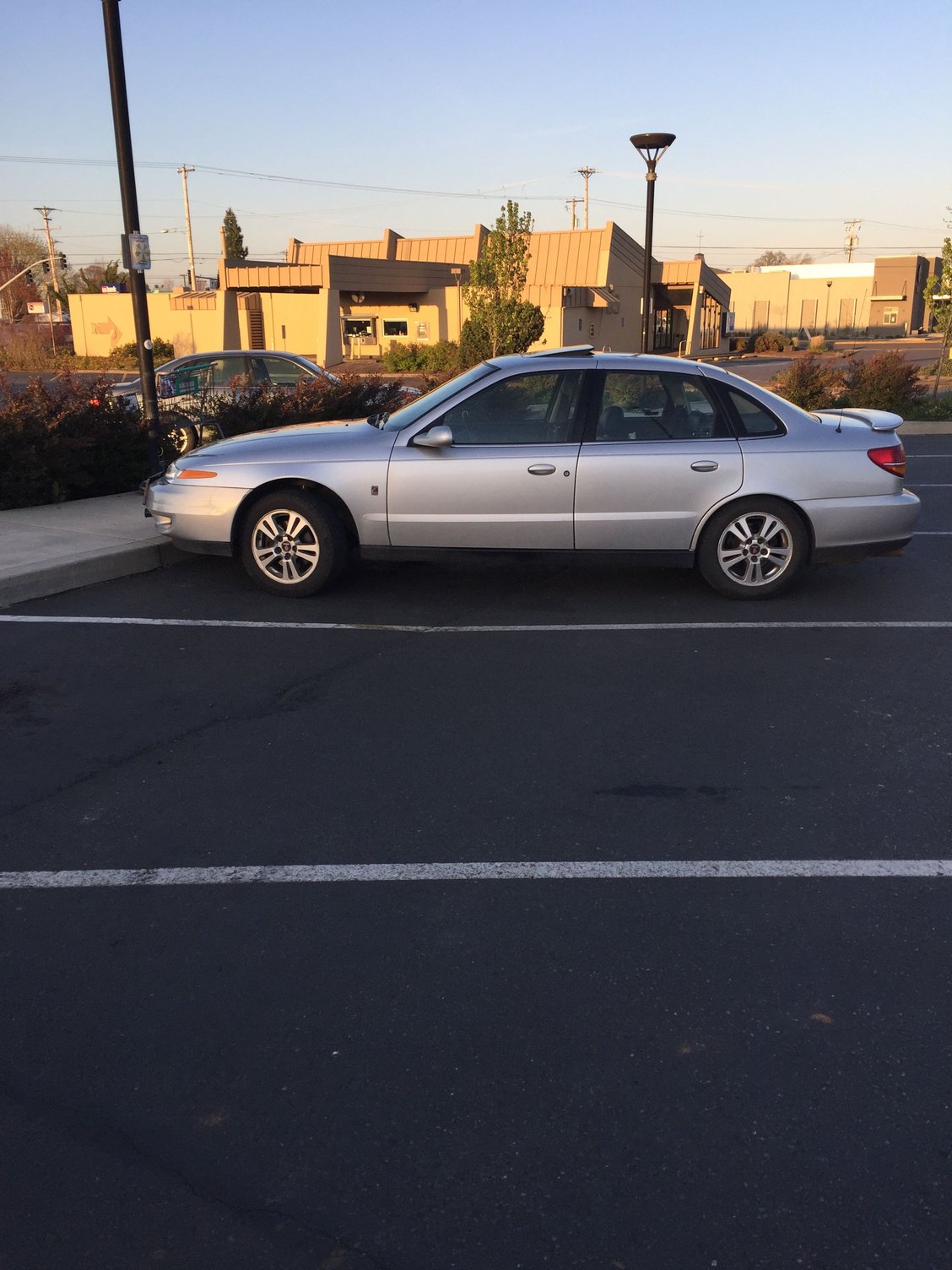

The back can come down one coil easily. Cut the bump stop in half and put adjustable lower arms on it so you can align it. Not much you can do to the front since they hit the stops already. I thought about trying Ion struts since they are shorter but never got there. I only lowered the rear of my L200/5 and I actually put v6 springs in the front to keep it off the bump stops. Very happy with the look and the ride. A set of 16” Saab 9-3 wheels make the look for me.
