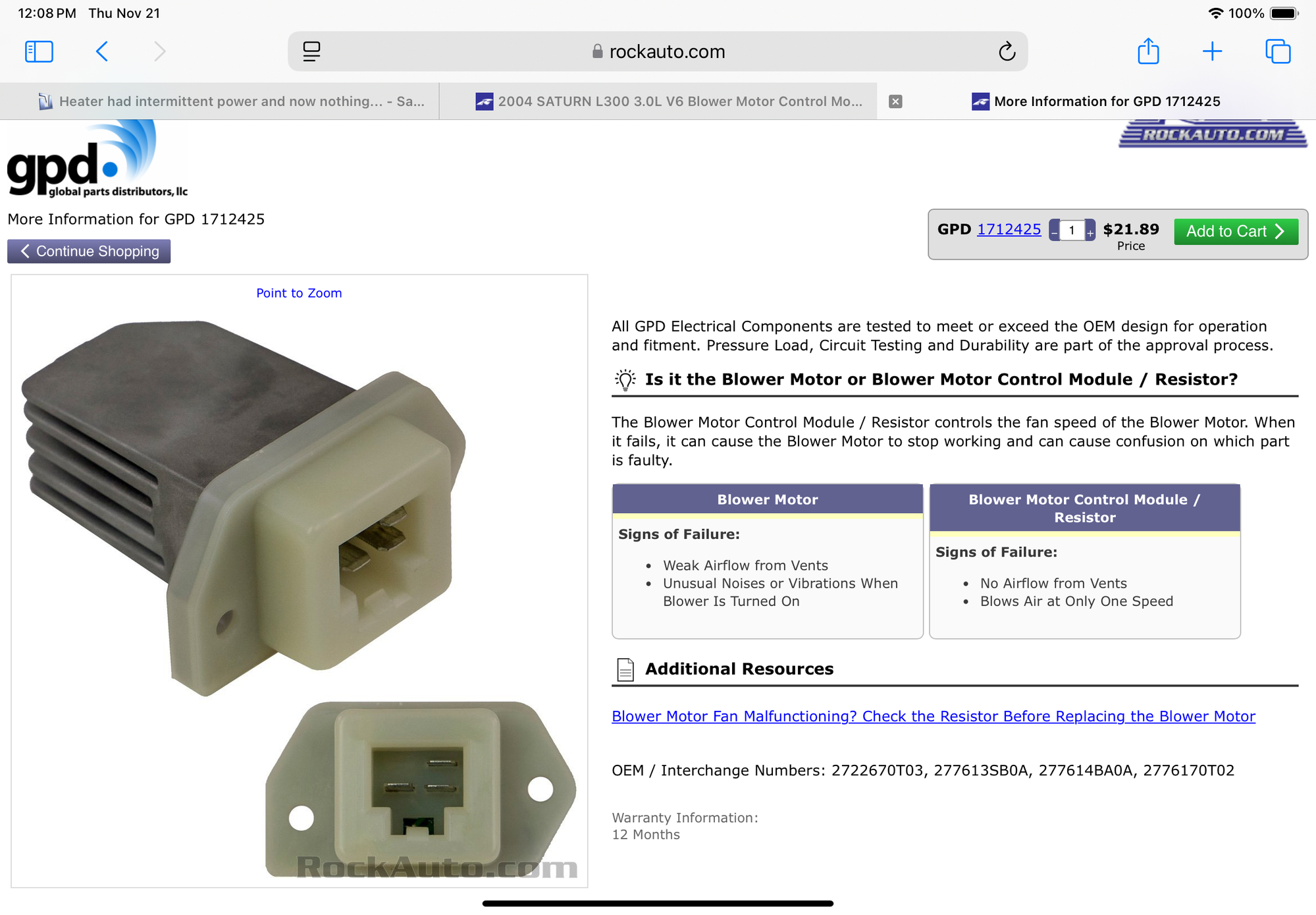

Is this the one?...I have digitalcomtrol.unit and automatic temp.sensor

That will not be the correct one for auto temp.
Old Nov 21, 2024 | 02:09 PM
This is the auto temp blower resistor.
