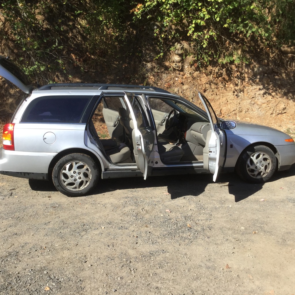

The 2000-2002 alloys are 15". I would love a set of Saab spoke wheels, I just don't want to buy a whole car to get a set. This ugly set of alloys came on my 02 l200/5 speed car.Name:  image_26.jpeg

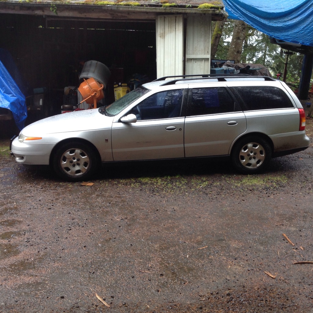

This set came on my 02 lw300, I saved them for my l200/5. Name:  image.jpg1_3.jpg
