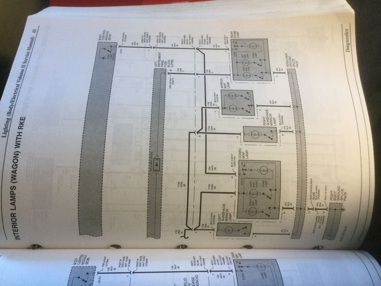

I’ll think about that and look up the schematic when I have time. I have a 2002 fsm set and the dome light wiring should be close. Sedan wiring runs down the passenger side A pillar to that side fuse box and harness.

Old Jul 11, 2020 | 09:28 PM
Old Jul 11, 2020 | 09:39 PM
Old Jul 11, 2020 | 09:43 PM
The lights have a ground splice probably above the headliner near the right visor. I would remove the visors and drop the front of the headliner and look if nothing works. Do you have three position switches off, door and on? Do you have separate map lights that also don’t work? If so check the ground splice and behind the trim panel around the interior fuse panels.
