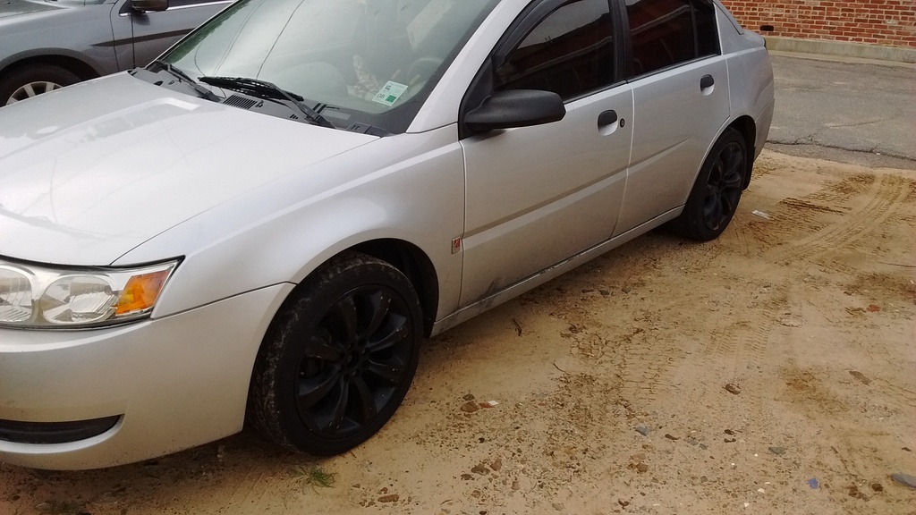

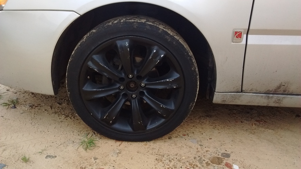

She is filthy, I know. So please excuse that.
I need to pull the dip off.
But thinking either a charcoal grey with a chrome lip like the redline comp wheels or just charcoal grey all together. I'll play with it a bit and see.
