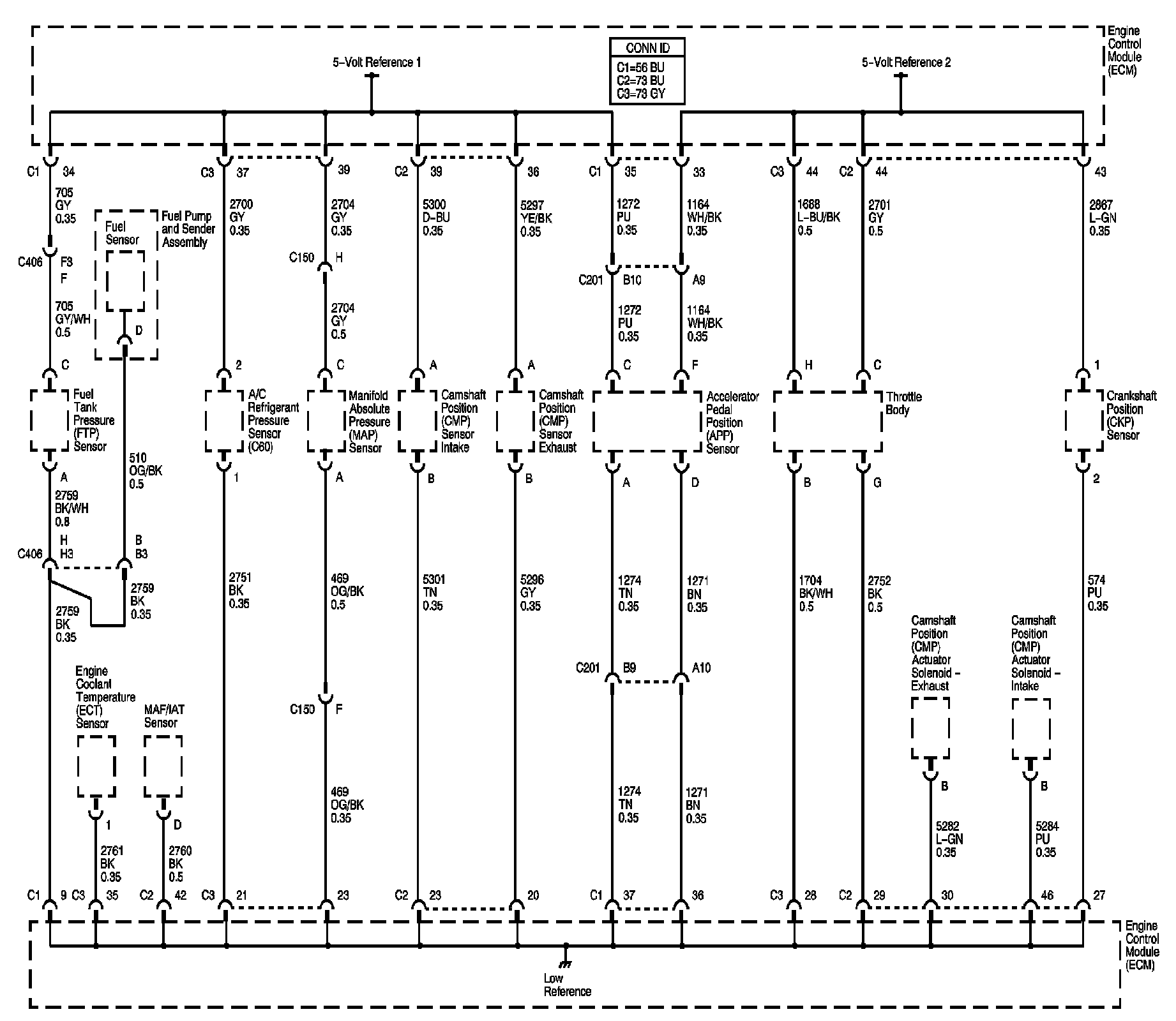

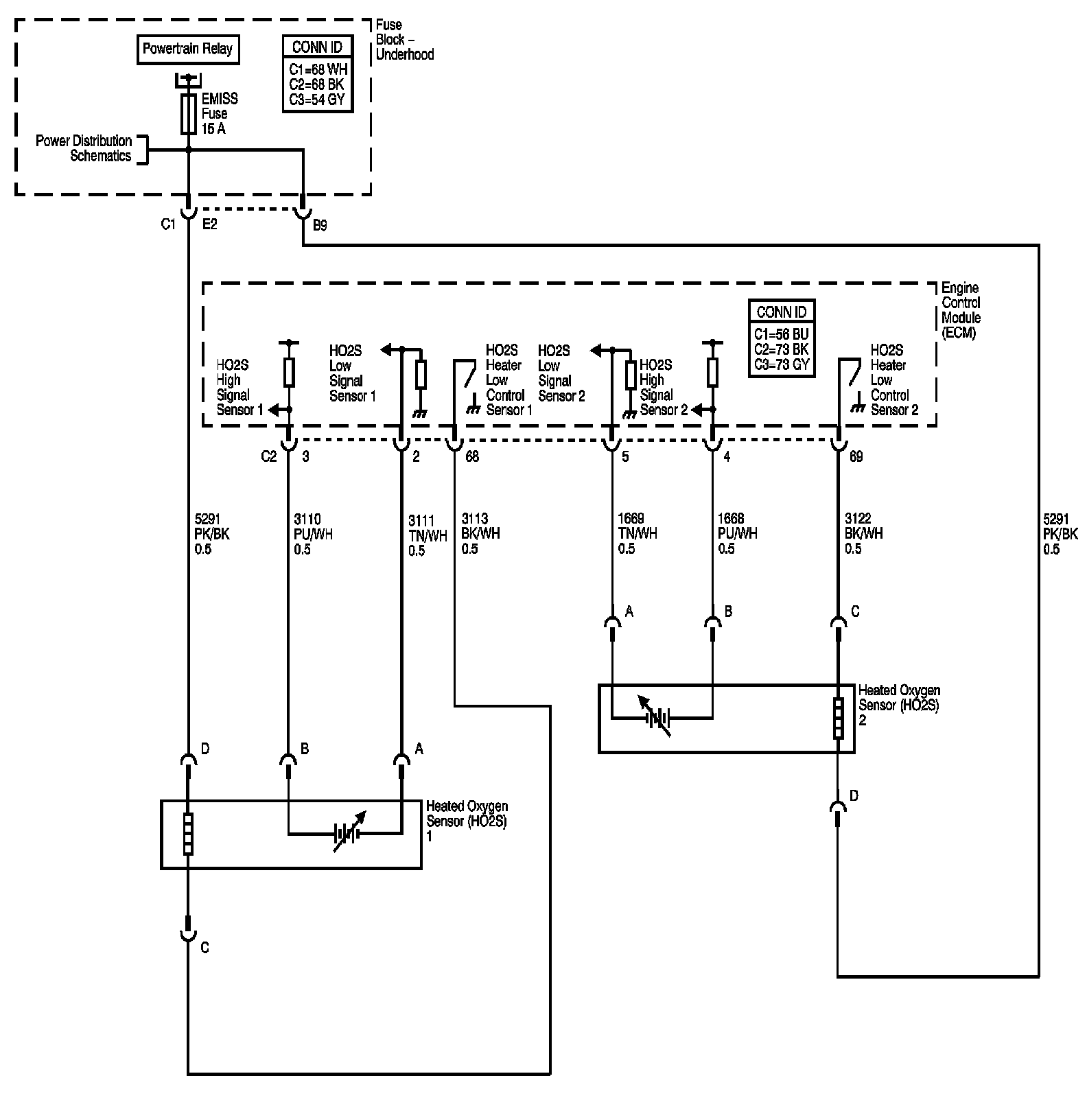

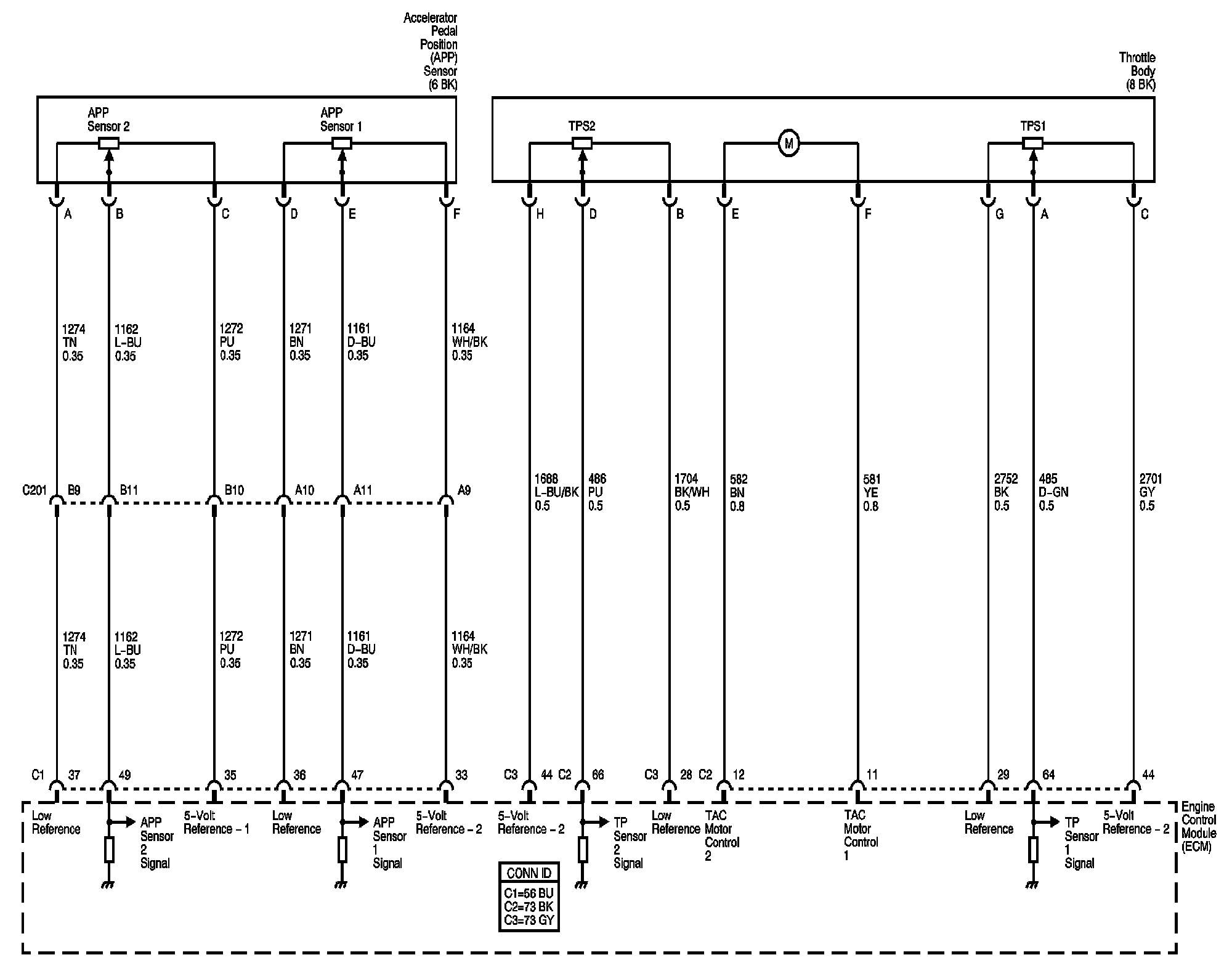

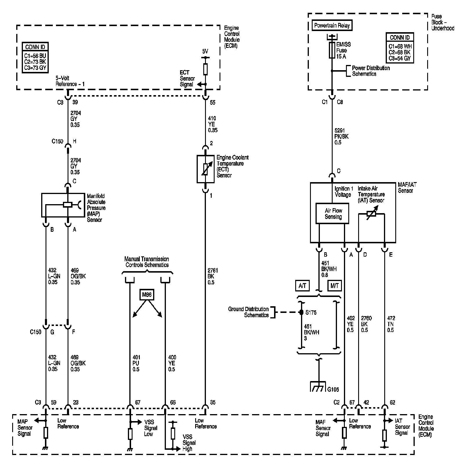

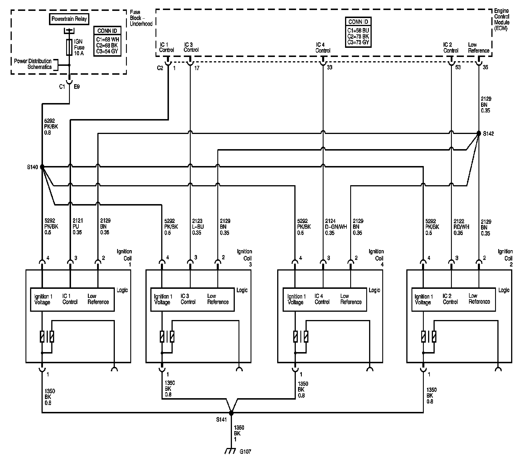

Any "usual culprits"? Which is blowing? Operation CHARM: Car repair manuals for everyone. Home >> Saturn >> 2007 >> ION L4-2.4L >> Repair and Diagnosis >> Powertrain Management >> Diagrams >> Electrical Diagrams Electrical DiagramsENGINE CONTROLS SCHEMATICS Power, Ground, MIL, and Serial Data https://charm.li/images/DM16Q313/gm160/683252516/ Engine Data Sensor - 5-Volt and Low Reference https://charm.li/images/DM16Q313/gm160/683272234/ Engine Data Sensors - Pressure, Temperature, and MAF/IAT https://charm.li/images/DM16Q313/gm160/683288385/ Engine Data Sensors - HO2S https://charm.li/images/DM16Q313/gm160/683300034/ Engine Data Sensors - APP and TAC https://charm.li/images/DM16Q313/gm160/683308235/ Ignition Controls - Ignition System https://charm.li/images/DM16Q313/gm160/683318739/ Ignition Controls - Sensors https://charm.li/images/DM16Q313/gm160/683330214/ Fuel Controls https://charm.li/images/DM16Q313/gm160/683341783/ EVAP Controls https://charm.li/images/DM16Q313/gm160/683353796/ Controlled/Monitored Subsystem References https://charm.li/images/DM16Q313/gm160/683365012/ Locations: The locations for the Connectors, Grounds, Splices, and Grommets shown within these diagrams can be found via their numbers at Vehicle Locations. Locations pro multis · About Operation CHARM |
The Ignition Fuse (10A, Fuse 11) was the one that was blowing. Back when it would actually crank/start.
I'm not that great at reading these, and especially tracing from page to page. I can do literally anything I want to do with the car, except start it. The lights all come on, the radio works, chimes go off, etc. The Passlock is not the issue (I doubt it) as the light doesn't stay on. Just the normal on for a few seconds at the beginning. When I try to crank it, the headlights dim while in the "Start" position, even with jumper cables connected to my running VW SUV. But it never turns over or starts. |
Oh, wow! I just opened up the links with the diagrams.
Those will be super helpful if/when I can figure out what I'm looking for. Thanks! |

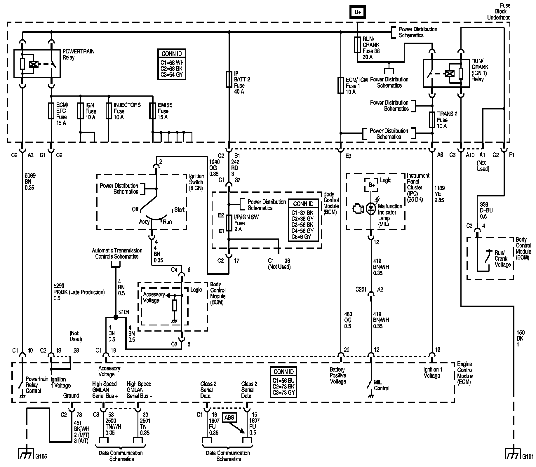

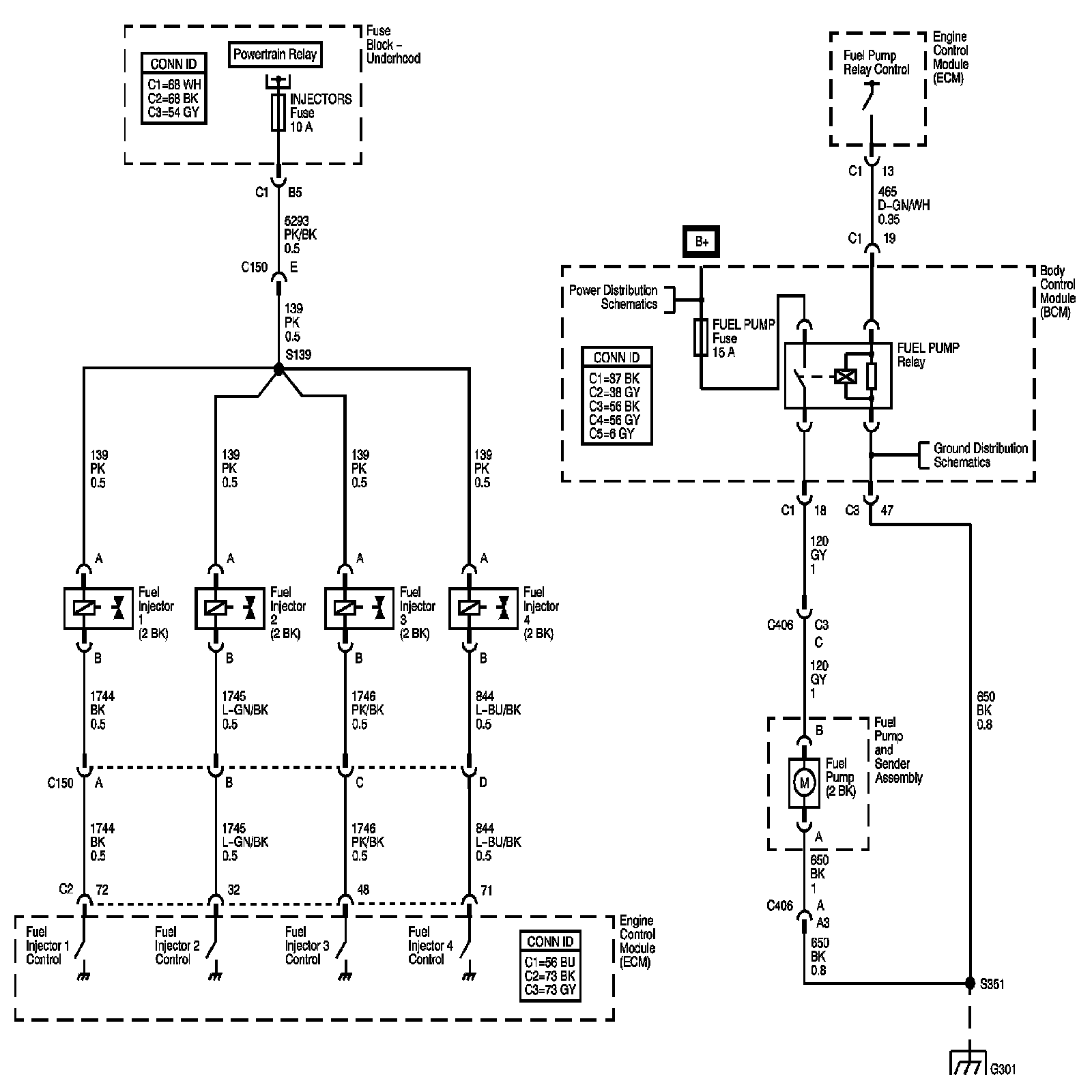

This is the diagram that shows what that feeds.
https://cimg0.ibsrv.net/gimg/www.sat...37a3321502.png |
