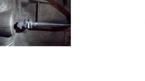

Hi,
I am trying to pull the manual tranny out of my 2004 Saturn Ion 3 and can't get the clutch line disconnected. I am not sure where the separation should occur.
Referring to the picture attached, can someone tell me if the separation occurs to the right of the retaining clip (looks like white vertical line in the image), between the retaining clip and the bleeder valve, or to the left of the bleeder valve?
I have pulled as hard as I dare and there is no movement anywhere and I want to make sure I pull in the right place. The tube will turn slightly (limited by the balance of the tube routed to the clutch master cylinder), but if I try to pull tube off what looks to be a nipple that has expanded the tube slightly, it doesn't come off easily. It also doesn't make sense that it would separate here as there would be no purpose for the clip that I removed.
Any help would be great,
Thanks,
JB

The separation should be to the right of the white tab,according to my service manual. As mine is an automatic, I have no first hand experience with it. It probably will take a pretty aggressive pull to remove it-maybe even a flat-bladed screwdriver at the junction to gradually pry it loose. I'll try to upload a picture.
Here's a pic.Hope it helps.
Old Feb 20, 2014 | 12:42 AM
JBSaturnIon's Avatar
Joined: Feb 2014
Posts: 6
Thanks, I have aggressively pulled there, I used pliers to squeeze on black tubing to rotate and pull, but no luck getting it to separate. I put WD-40 on it in hopes that might help some, and even gently heated the rubber hoping it would soften some. I have some pretty good teeth mark in the plastic tubing from pulling on it now.
I don't see how I could use a screwdriver to pry this out, but if there is a way, please elaborate....
Thanks for the info though, at least I won't apply force in wrong place now!

Ugh, I still am not able to get the line separated. From what people have posted, I think I can grab the plastic to the right of the clip and turn/pull to disengage, but it won't budge. If anyone has a close up of the clutch line connector at the slave end that would be great, even the uploaded exploded diagram is a bit hard to make out exactly how that connector comes apart.

After digging around on ebay, I found someone selling the same tranny that didn't just cut the tube, and had a high enough resolution photo to be useful. Attached is a crop of a pic of the clutch line disconnected.

Default Success!
I managed to get the tube removed once I knew for sure where to apply force. To complete this thread, I have attached a picture showing the data I had sought so feverishly in hopes it will help someone else. It was really stuck, I ended up putting 3 vise grips on the tube right next to each other to keep them from sliding. I think used a screw driver to pry between the plastic housing and the vise grip to push the tube it out. Even with long screw driver, it was some good force to get it come out. You can see the stacked vise grips in the photo, and also see the rust on the end of the clutch line, possibly this is what made it so hard to separate.
