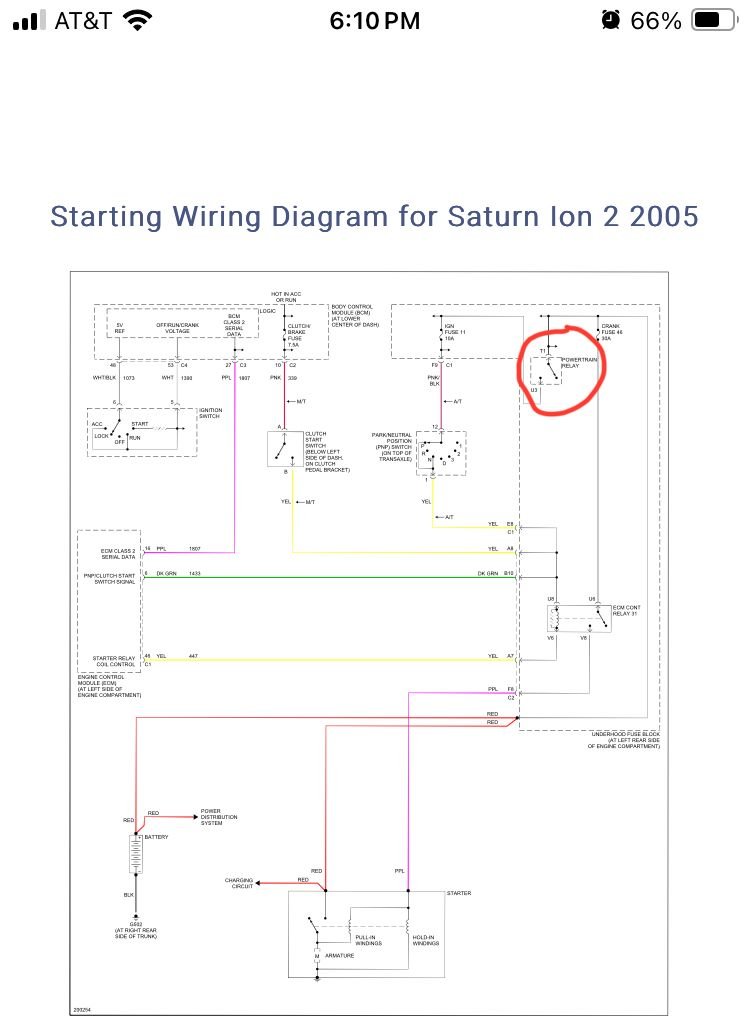

I did some testing and the ignition switch seems good. I found that the powertrain relay is not pulling in. Relay measures fine with ohmmeter. There is 12v present to one side of the coil. I’m thinking a signal applies the ground to the other side of the coil which would pull it in and close the contact.
I can’t find what signal is sent to pull in that relay.

Old Jan 11, 2025 | 09:24 PM
In your schematic it is labeled “powertrain relay”

Old Jan 12, 2025 | 07:58 PM
grcauto8453's Avatar
Posts: 632
From: Davison, MI
Home >> Saturn >> 2005 >> ION L4-2.2L VIN F >> Repair and Diagnosis >> Starting and Charging >> Diagrams >> Electrical Diagrams
Electrical Diagrams
Starting And Charging Diagram 1:
Starting And Charging Diagram 2:
Old Jan 12, 2025 | 08:00 PM
Posts: 632
From: Davison, MI
You see the neutral switch and anything else that needs to be good in order for the relay to energize.
I see now.
thanks for posting the schematics, very cool!
