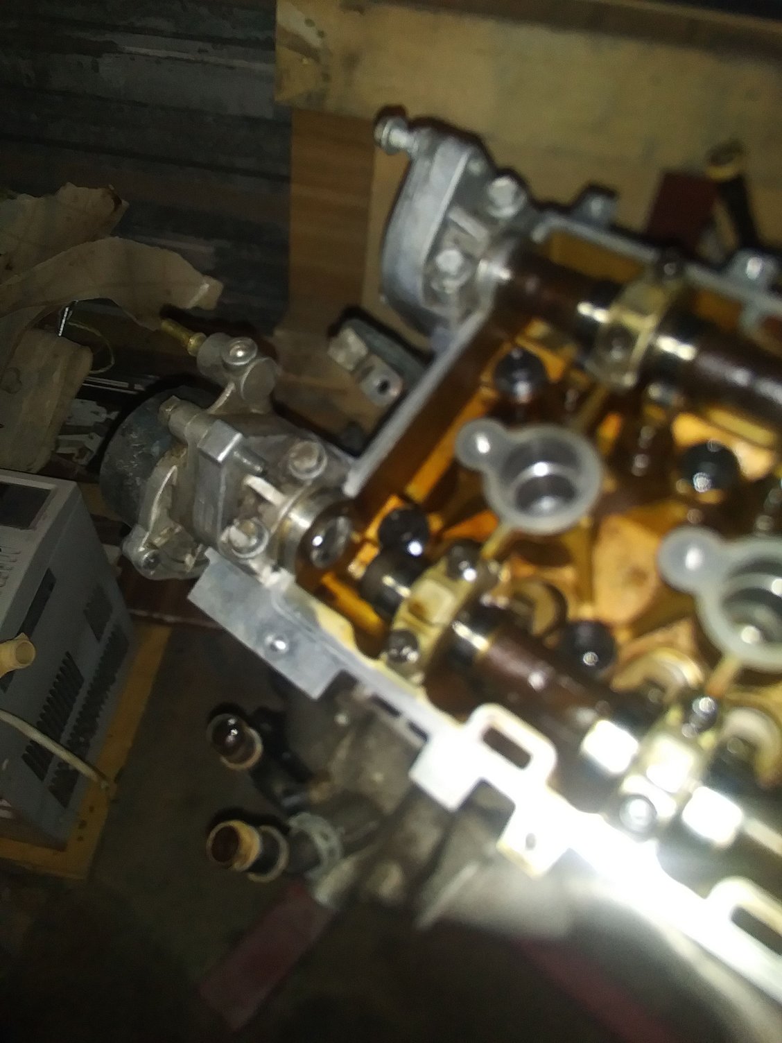

L61 cams installed
Knub to block that oil galley

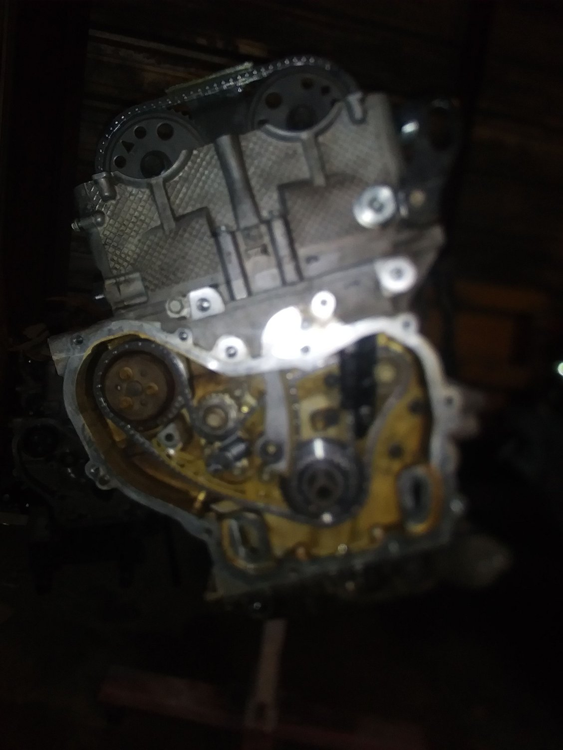

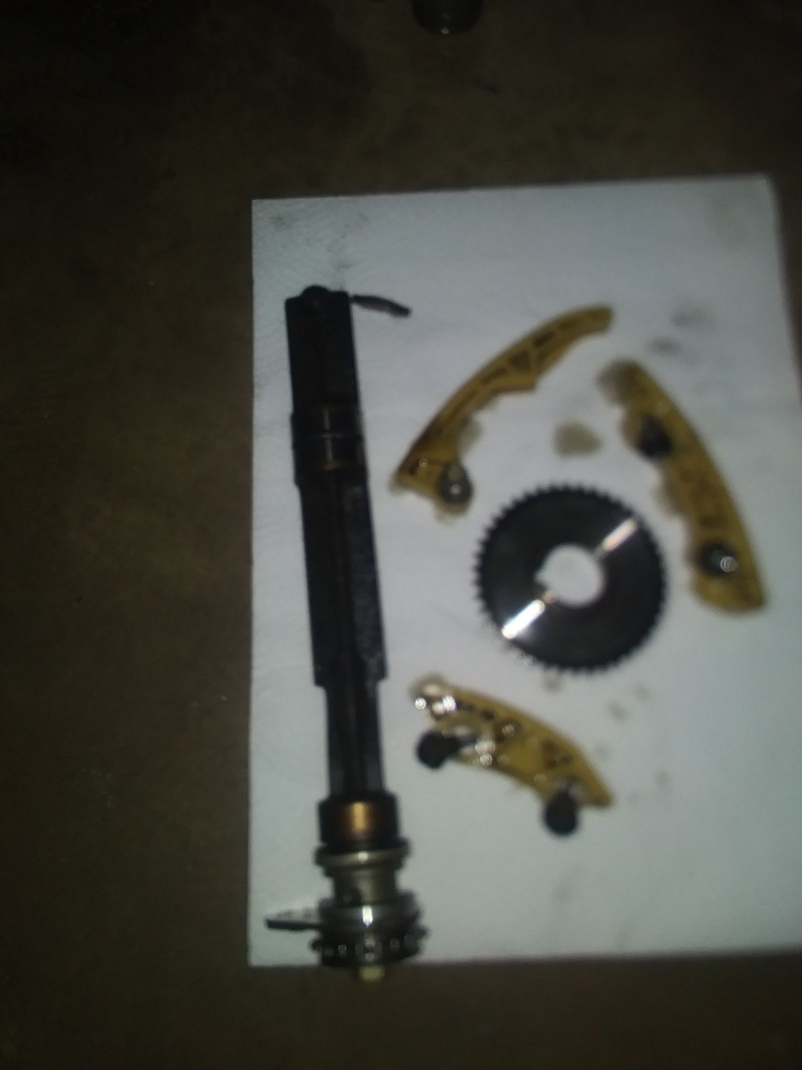

Balance shaft
Unbalanced shaft
All timed. Well. Im off a tooth in this pic. But i fixed it
