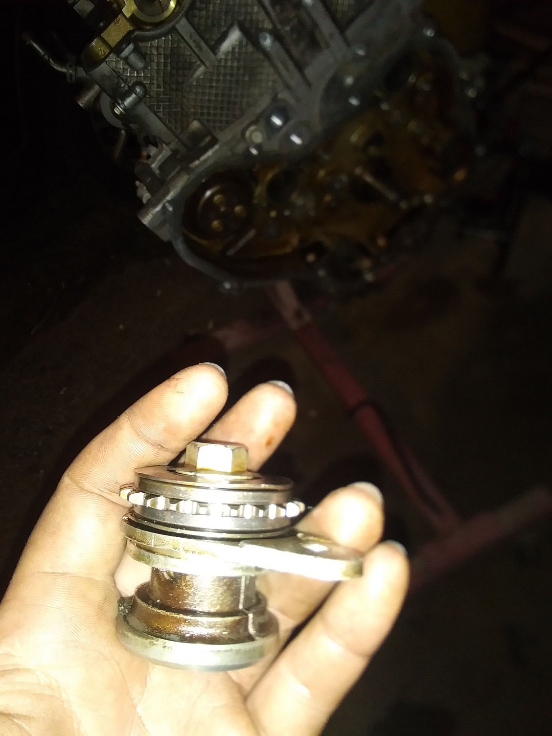

Need to get some oven cleaner to spray the block down. Excuse the background mess. Also working on braking down a pop up camper to convert into a trailer.
Cut down balance shaft for the delete
This pile o' crap. Old engine next to it.
That silver ring in there is the delete sleeve. Theres an oil galley in there that needs to be covered so i can sustain desired oil pressure.
