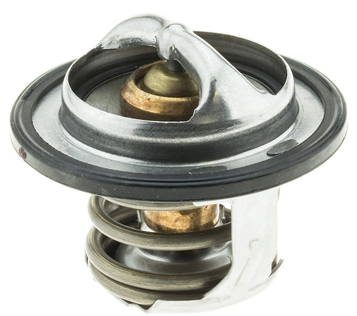

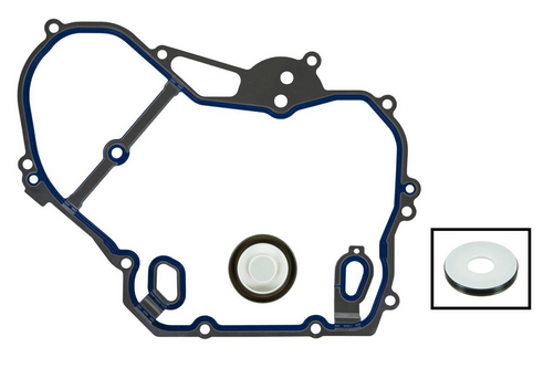

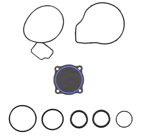

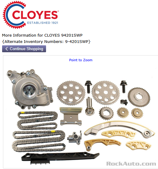

This is what im looking at getting right now. Hoping i didnt miss anything.

Lower engine cover gasket
Spoiler
Timing chain kit
Spoiler
Water pump gasket kit
Spoiler
Thermostat
Spoiler
Old May 25, 2025 | 12:25 AM
  #43
Posts: 12,392
I double checked the rock auto site versus the part numbers you have listed. Everything looks good. Looks like you are going to do the whole shebang with the water pump and thermostat, additional chain, all of the guides, etc. better to do it all at once than to pay for the same labor multiple times doing it piecemeal.
