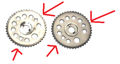

I have, what i hope, is one last question on the timing chain components side of this.
Some of the kits from different brands that i saw, had those two big main gears that had those punch outs near the rim. One of a diamond shape, and one of a triangle. I believe in order to line it up the chain to them.
I noticed some other brand kits, had those two gears all with straight up circles punched out in them. No diamond or triangle. Im curious about that difference. Is there a reason for the difference?
vs
Old May 24, 2025 | 03:04 PM
  #34
Posts: 3,296
The gears on right are factory gears, those marks are used with a factory tool so you can remove the cylinder head without loosing time on the chain. The description of the factory tool and its use is described in a factory service manual. The replacement gears have the proper marks for first time setup. I think the factory overestimated the durability of the chain and guide setup. I have never needed to remove a cylinder head without replacing the chains on one of these engines.

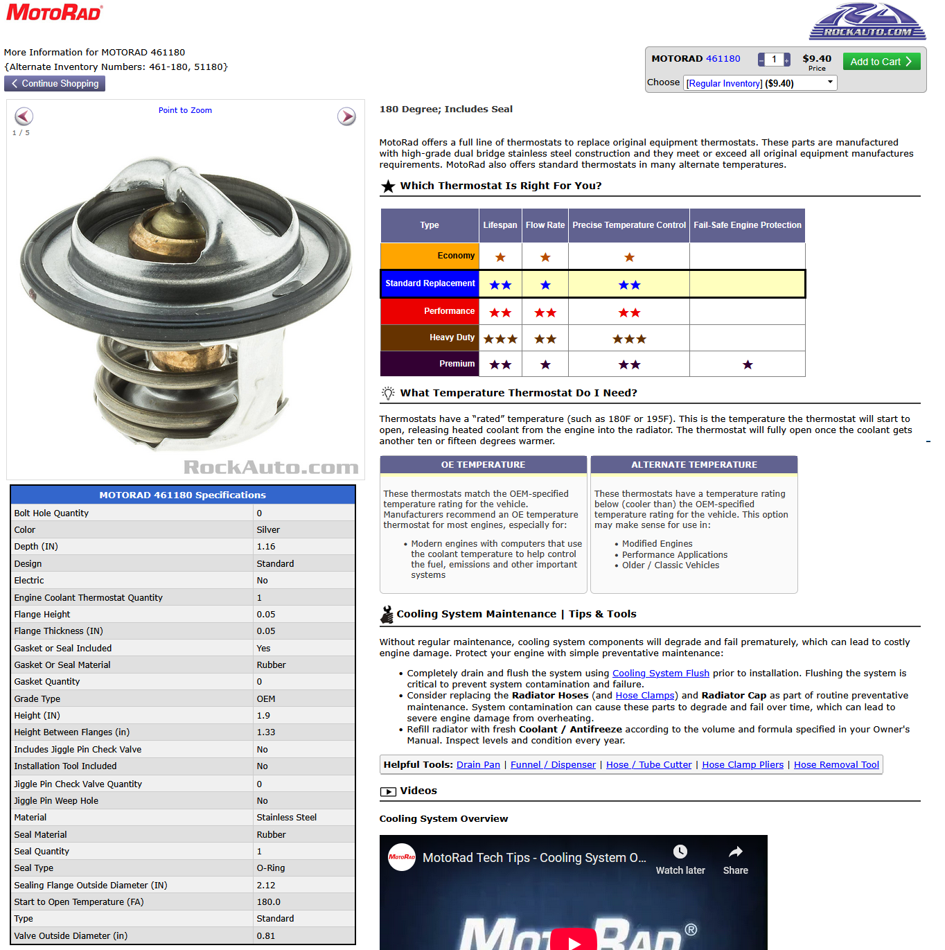

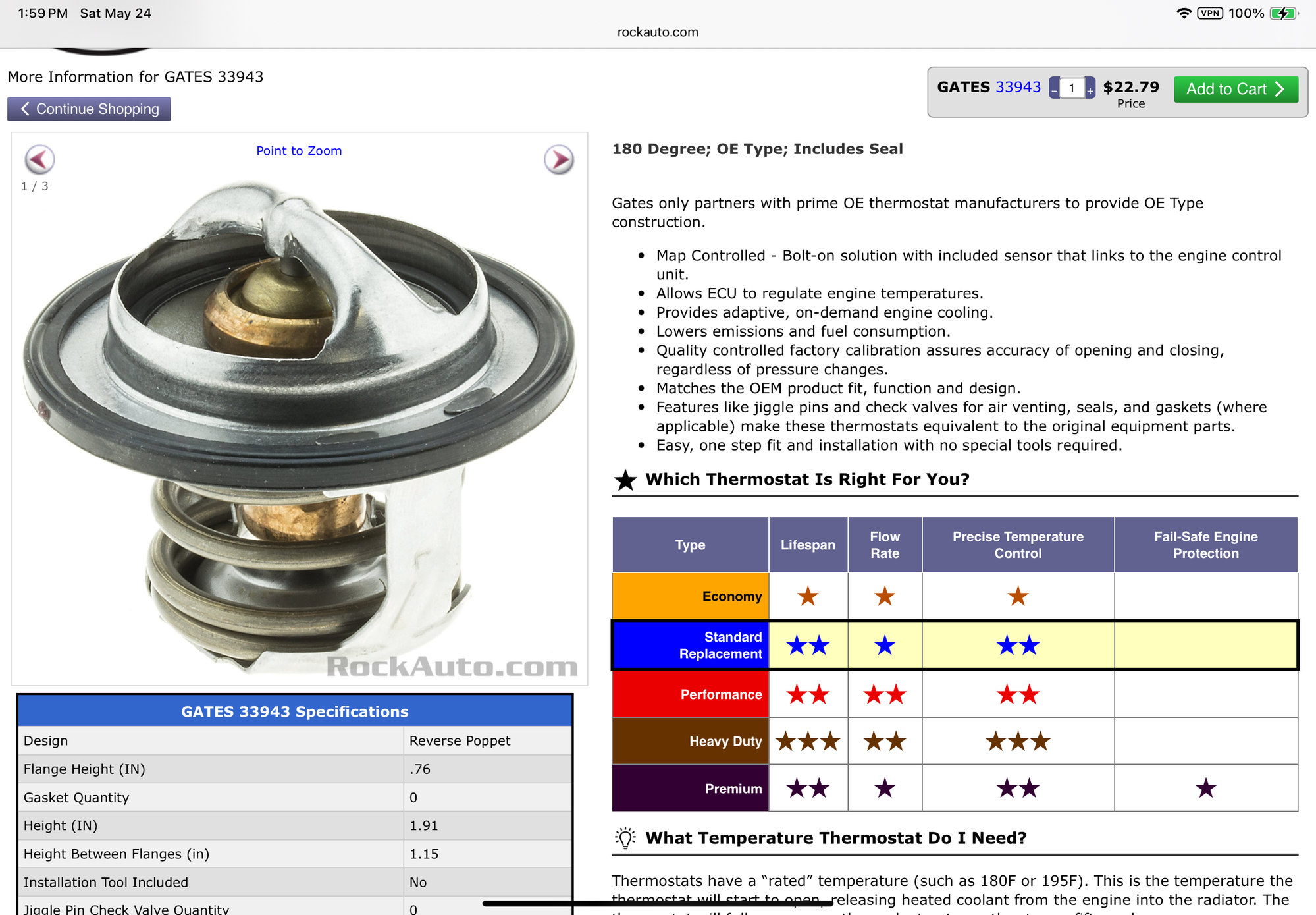

I think this is the last component i had questions on. The thermostat. Iv never actually seen one, even a picture, until you mentioned it and i searched it.
1. Is this the right item?
2. IF it is the right item... i noticed in the specs box it said "Gasket or Seal Included : Yes" and then near the bottom it said "Seal Type : O-Ring" - Is that the o-ring we were talking about earlier? So i wouldn't need to worry about getting another o-ring for the thermostat separately? Or is it something completely different?
Spoiler
Old May 24, 2025 | 04:00 PM
  #36
Posts: 3,296
The seal for the thermostat is a different one than you saw before.

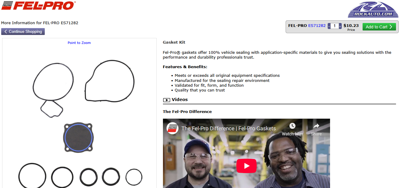

thanks. So if i get that then i still need that o-ring.
This one feels a little stupid of me to ask, but which o-ring am i looking for? The descriptions vary a good bit on each of the listing titles. The pics vary even more. Some look thinner, some look thicker, some look... ribbed? for the water pumps pleasure maybe? i dunno.. And the actual 'info' pages dont seem to say much at all.
I was considering this one yesterday. A couple more dollars then getting the water pump gasket and o-ring separately. But the kit has several extras in it. So hopefully one of the o-rings would fit... Would hate to get everything and have the work done only to find out my one little o-ring doesnt fit.
Spoiler

The seal comes on the thermostat, that gasket kit is needed to replace a water pump
Ok, now im confused. You mentioned earlier that a thermostat needs an o-ring when replacing it. And you said the o-ring seal that comes on the thermostat is a different one.
Perhaps a misunderstanding somewhere?
Let me reset the question so i can get this straight in my own head.
So the gasket kit is for the water pump. Ok. - If the thermostat is to be replaced, does the thermostat need anything else with it?
