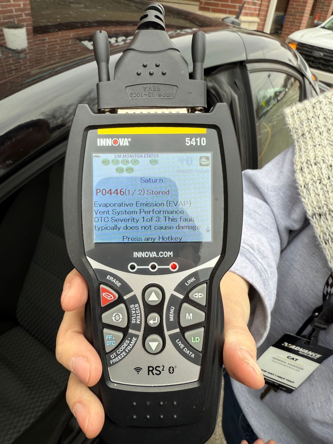

Got it scanned, said P0446, it said it was the EVAP. Still gonna get it fixed of course because I’m not trying to ruin the car, even if it might not entirely “cause” anything terrible, it’s cheap.

If you don't have emissions testing let it go. It's not hurting your car at all.

Should you ever have issues where it becomes difficult to put gas in the tank, where the pump keeps clicking off immediately, you may need to address this. Otherwise, per Gary, it does no harm.

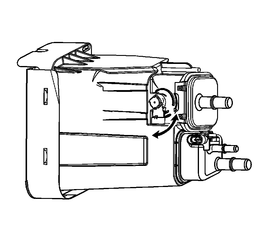

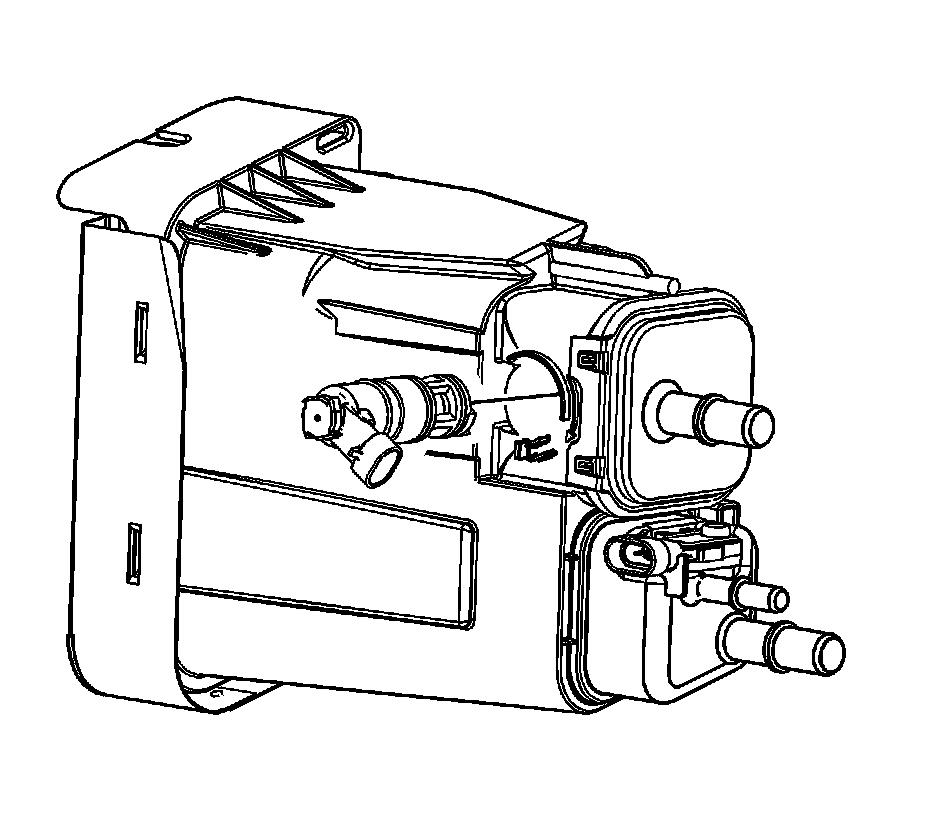

Home >> Saturn >> 2007 >> ION L4-2.2L >> Repair and Diagnosis >> Powertrain Management >> Emission Control Systems >> Evaporative Emissions System >> Evaporative Emission Control Canister >> Canister Vent Valve >> Service and Repair
Canister Vent Valve: Service and Repair
Vehicle Lifting.
Evaporative Emission Canister Vent Solenoid Valve Replacement
Removal Procedure
1. Raise and support the vehicle. Refer to Vehicle Lifting.
2. Disconnect the evaporative emission (EVAP) canister harness electrical connector (2) from the EVAP vent solenoid valve.
3. Clean away any debris that may be present around the EVAP canister vent solenoid valve.
4. Remove the EVAP canister bolt.
5. Lower the EVAP canister.
6. Rotate the EVAP canister vent solenoid valve counterclockwise in order to release it from the locked position.
7. Remove the EVAP canister vent solenoid valve from the canister.
Installation Procedure
1. Install the EVAP canister vent solenoid valve into the EVAP canister, with the valve aligned to the released position.
2. Rotate EVAP canister vent solenoid valve clockwise in order to secure it into the locked position.
Notice: Refer to Fastener Notice.
3. Install the EVAP canister and bolt.
Tighten the bolt to 10 N.m (89 lb in).
4. Connect the EVAP canister harness electrical connector (2) to the vent solenoid valve.
5. Lower the vehicle.
