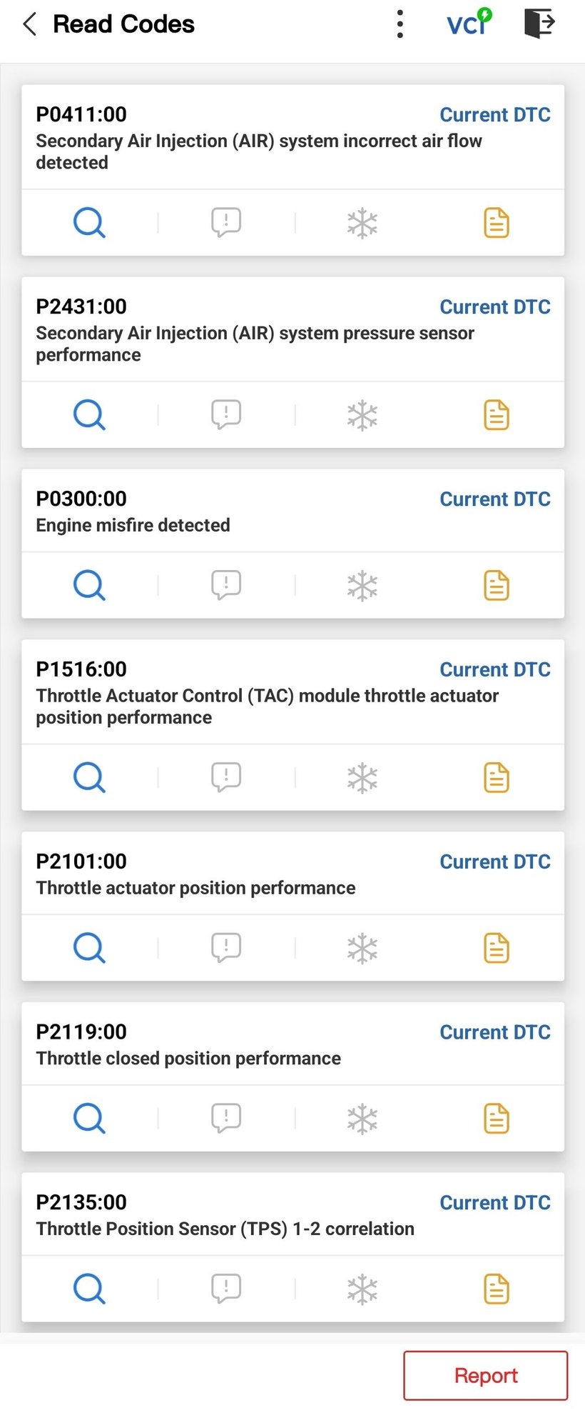

Today, while sitting parked, it went down a tiny bit, then shot up in rpms as if I pressed the gas pedal and sounded off chimes. The engine light lit up. Not the usual one but the one all the way on the right with the down arrow in the middle. I immediately shut the engine off. Like 5 minutes later, I started it back up, and everything was fine. I had already had some throttle position codes pop up a few days ago, but what happened today added more. I have a total of 5 now. Do you know what the issue might be? I attached a screenshot of the DTCs

I've been having this issue for some weeks now where my car goes into limp mode and throws throttle codes. They don't all come at once. It'll eventually reach a total of 4. There in the screenshot but they are:
P1516
P2101
P2119
P2135

Update: Turned out that my throttle body was going out. The relearn, according to Google AI, is basically automatic. You just start the engine and let it idle for 10 minutes. Cars driving like normal again 😀
