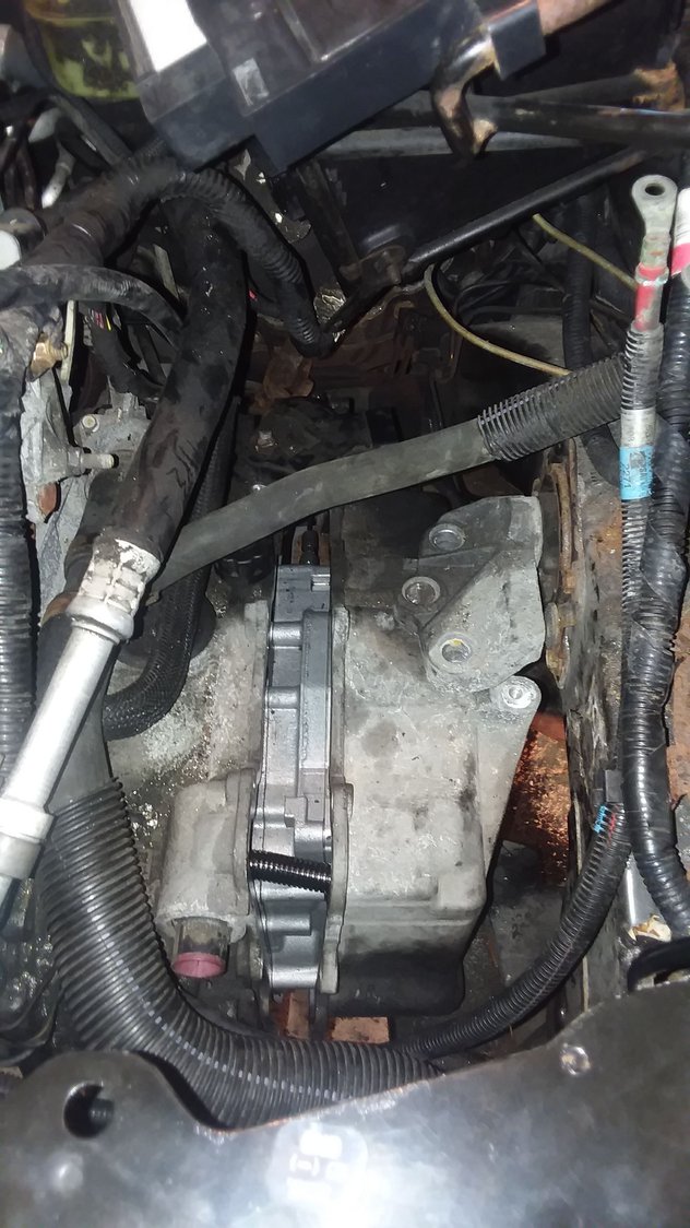

I keep this as simple as I can without getting too far off topic but after everything I've been through with this vehicle this year I'm about like. I think they screwed up the name they were trying to find a close translation 4 struggle at turn and run. I'm new here I will try to be descriptive and informative where I can because I've done a lot of research and may have learned some things that will hopefully help other people. Okay new friends from what I know after 2006 Saturn had to start making their own transmissions in Canada the 4t45e. It took me at least a week or two to figure that out after my car broke down. Now my issue is the B shift solenoid. My code is po 977 2 to 3 shift solenoid circuit high voltage. I thought I had a transmission mechanic coming to work on it and he said he knew these Transmissions but never showed. He stated that the code does mean that it is either that solenoid or a wire running from the PCM to the transmission case connector. I purchased a shift solenoid/transmission control solenoid. And some wiring. I managed to scrape up enough work that to survive and come up with $200 cash which according to research is supposed to be a little more then expected labor cost for this. According to 1 Saturn related website cost of labor for this should be like a hundred 2 177. Anyways I finally managed to get a mechanic willing to come out after spending a day on the phone with him trying to educate him on these Transmissions because he was interested and he bought an Alldata subscription for step-by-step repair procedure. After two days at my house he finally tells me today that he can't get the transmission moved enough to get his hand in there to work on it like I read on another Saturn forum. A guy managed to get the transmission positioned just enough to get his fingers into change his solenoids. So of course he's left at this point and I paid him $150 but he's going to call some people and like I am right now trying to figure out how to finish this job. because I'm also bartering some things with him to get him to come back. So my car is torn apart I'm still in the same position and I can't even get my car out of my garage now to do anything with it and I have to start a new job Monday. Any kind of help or information how to get us that extra room because he can't figure out how to even if you takes a couple other Mount bolts out how to get it up high enough for position or supported or something. So sorry for this long post but I guess this is my dilemma and any help would be appreciated. Thank you

Derf, thanks man but you wrote too much to quote you. At this point I'm kicking myself in the *** because instead of being nice and trying to not bother this guy while he was working I should have been out there making sure all the right things were being done. Haha. Slow start on it today but like you said taking my time and having to figure out what tools I need whatever but making me take way longer than what it should somebody but I've already made a lot more room up top.
Didn't move none of the stuff out of the way better. Didn't unbolt the battery cables from the fuse box which gave a lot more room to pull the whole set up out of the way they didn't disconnect the shift positioner all the way or whatever that things called. Took one bolt out of the main unit in the back what might have been the sensor for that but still can't get that little black part off. But I don't necessarily think I have to be concerned about it yet. and I've got a picture where you can see down in there or not easily but where are there some Mount bolts still in. I believe no attempt was made to support and reposition the transmission a little. I believe that's kind of where I'm at.
