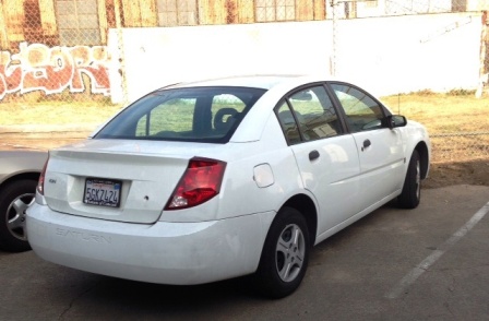

Here's a picture of the beast:2004 Ion 1 weird starting issue-saturn.jpg

That's a nice looking car. I can see why you've gone to the efforts to fix it.
Old Dec 18, 2013 | 06:05 AM
Plastic Saturns hold up so well it's crazy. A little elbow grease and most of them can look like new. Thanks for sharing the picture, add a few to the ION picture thread.

Old Dec 18, 2013 | 08:11 AM
Thats a nice little ION-1.......I do like em in white.

Thanks,guys-its nice to be finally down to cosmetic stuff. I have to get one wheel cover, and touch up the paint on the bumpers. I also have to steam clean the interior.
I'll post some more pics once I wash the thing!
