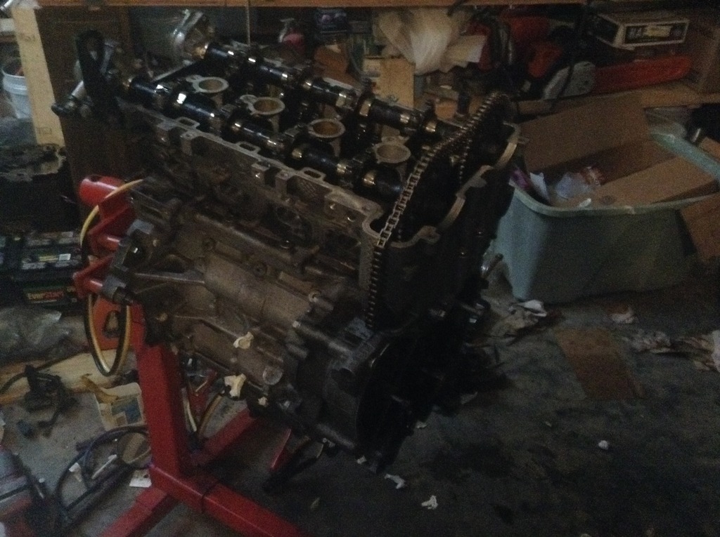

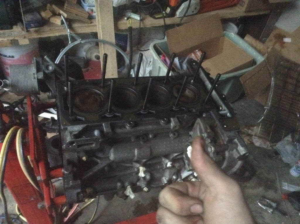

So, I made some progress with my LSJ...
Mating surface clean, new gasket laid down, and ARP studs ran in, hand tight, with Lucas assembly lube
Head is on and to final torque... I went in three steps, 25,55, and then ARPs spec of 80lb/ft of torque(using Lucas assembly lube), using the head tightening sequence in the repair manual I bought... Engine is also in time, but with no chain or guides on it for now...
Timing cover and valve cover need put on(after engine is timed), the crank pulley needs cleaned up and a new bolt ordered(stupid TTY bolts), and then it's ready for transplanting, after I get flywheel and PP bolts and a new TOB...

Is the cyl head pic w valves the final assembly pic prior to install?
The left hand intake valve on all four cylinders does not seem to be fully seated based on what I can see from the picture. Not sure why that would be ??

They looked fine before I bolted them onto the block... Yesterday, I got the timing chain on and the engine timed, but I can't get the friggin chain tensioner to work... I reset it, but it wouldn't release when I hit it
