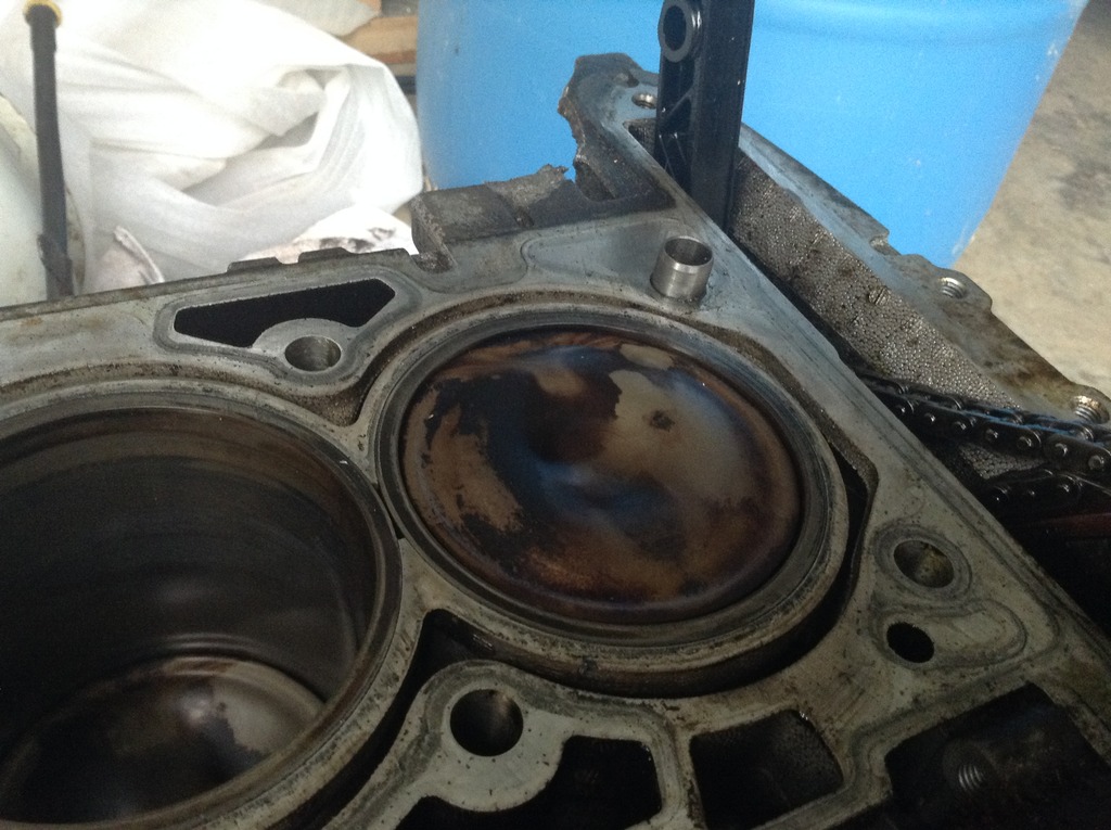

So, I got some work done on my spare LSJ...
I took off the head and tossed the gasket...
Cleaned off the tops of the pistons with trans fluid on a rag... A petty big improvement, considering they were covered in soft carbon deposits
3&2
I also wiped the bores out with trans fluid, on a different rag... There were no big gouges, and some original cross hatching was still visible; I think she'll make decent compression when all buttoned up...
I then turned the crank until all four pistons were at the same height in their bores, and poured a capful of ATF over them and sealed it up for the time being...
I need three nuts for my ARP head studs and the major gaskets, and then this'll be ready to transplant into the car!

lookin pretty good. Bones.
One question---from the piston pix, it LOOKS like the top edges of some of the pistons are closer to the bores in different places around each piston top. I know you are taking the pix at a slight angle, so there will be some parallax error, but it is not always at the front edge in the pictures.
I fully understand that it may be the opposite of what I mentioned (gunk is creating too wide a gap)
Have you checked the clearance betw the top of the pistons and the bore for uniformity?
