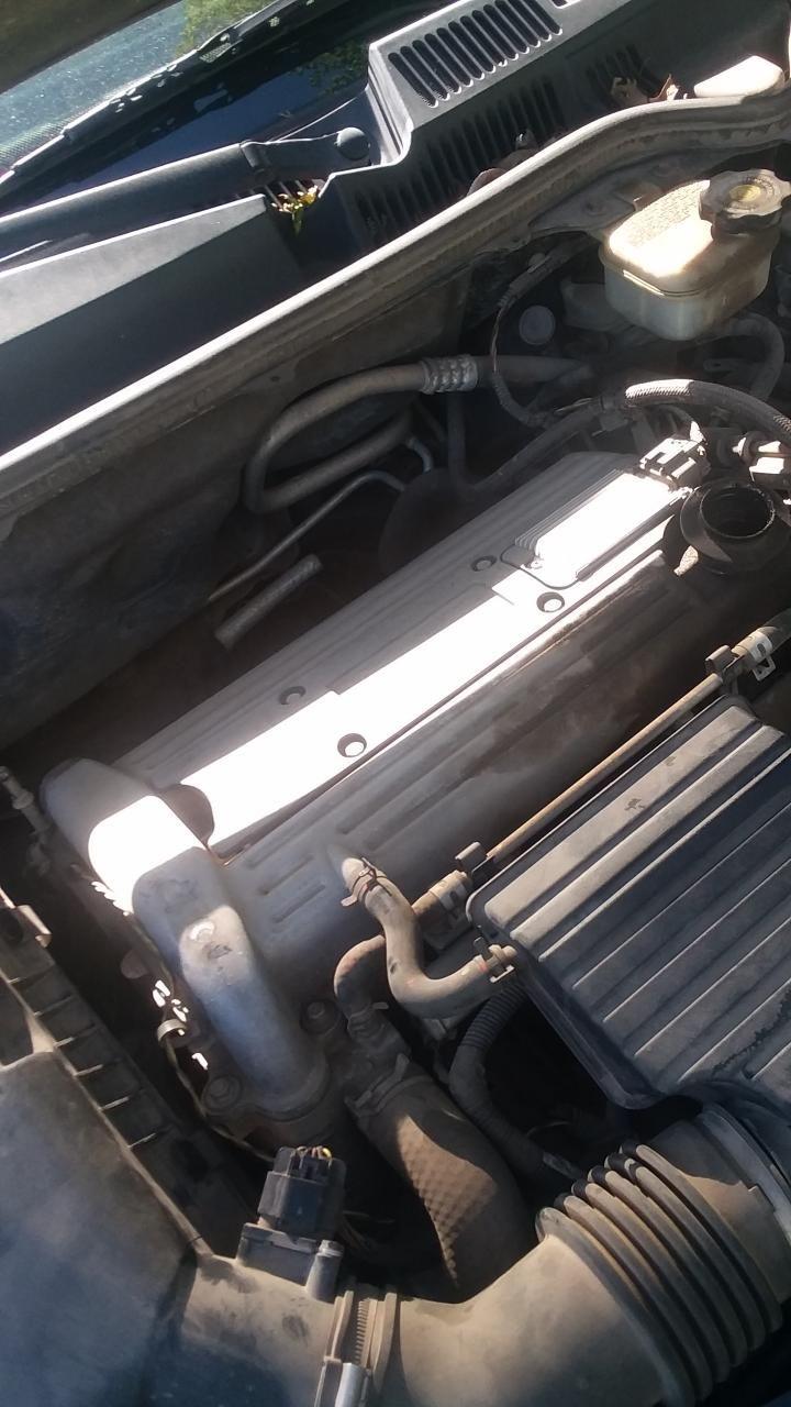

Can y'all tell if its ported or not? Idk if these pics help, but thanks again!

This is looking down on the cylinder head with the valve cover removed. The egr port is at the bottom of this picture with the 4 holes showing.
Old May 13, 2020 | 09:21 PM
This is a picture of one without the egr port.
Old May 13, 2020 | 09:46 PM
ionic_Mando's Avatar
Joined: Feb 2020
Posts: 6
From: Oklahoma
Alrighty thanks for the help the EGR port is basically like a little tail with a few holes in it?
Old May 14, 2020 | 10:41 AM
Yes, and I don’t think any Saturn uses an egr valve. However this engine is used by many car brands and in many countries.
Old May 14, 2020 | 05:13 PM
The s series used EGR valves but that is a totally different animal.
