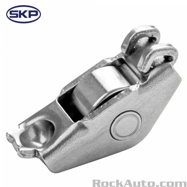

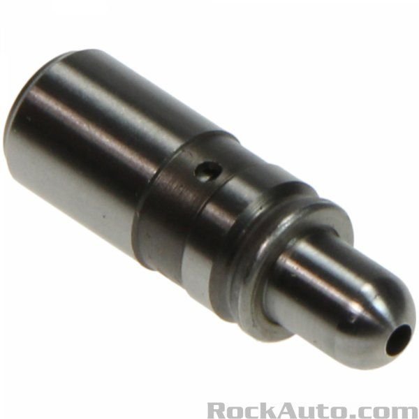

I was doing more searching, since I've never worked on one of these engines. I saw a few posts online about how this OHC engine doesn't have lifters, and I have worked on other OHC engines where the cam sits directly above the valve stem, separated by a bucket style "lifter" with shims. I assumed that's how the 3.6 was set up.
I saw Rock Auto has a listing for lifters and valve springs, so I'm assuming there's some kind of rocker arm arrangement under the cam, with a hydraulic "lifter" on one end, valve on the other?
I'm not familiar with this engine, and not finding decent pics online. I'm guessing it's possible to have a collapsed lifter.

I would pull the back cam cover and take a look. The wheel on the follower could be bad and the cam lobe or just the lifter. You will be able to see if the oil has been changed on time.

Chrysler 3.6 is notorious for cam follower/ lifter failure, the dealers keep the parts in stock. There is not great knowledge in the Saturn forums due to the short run near the brands demise. You might find a deeper knowledge base on a different GM forum. I have never worked on any of the v-6 engines newer than the 3.0 L81.
