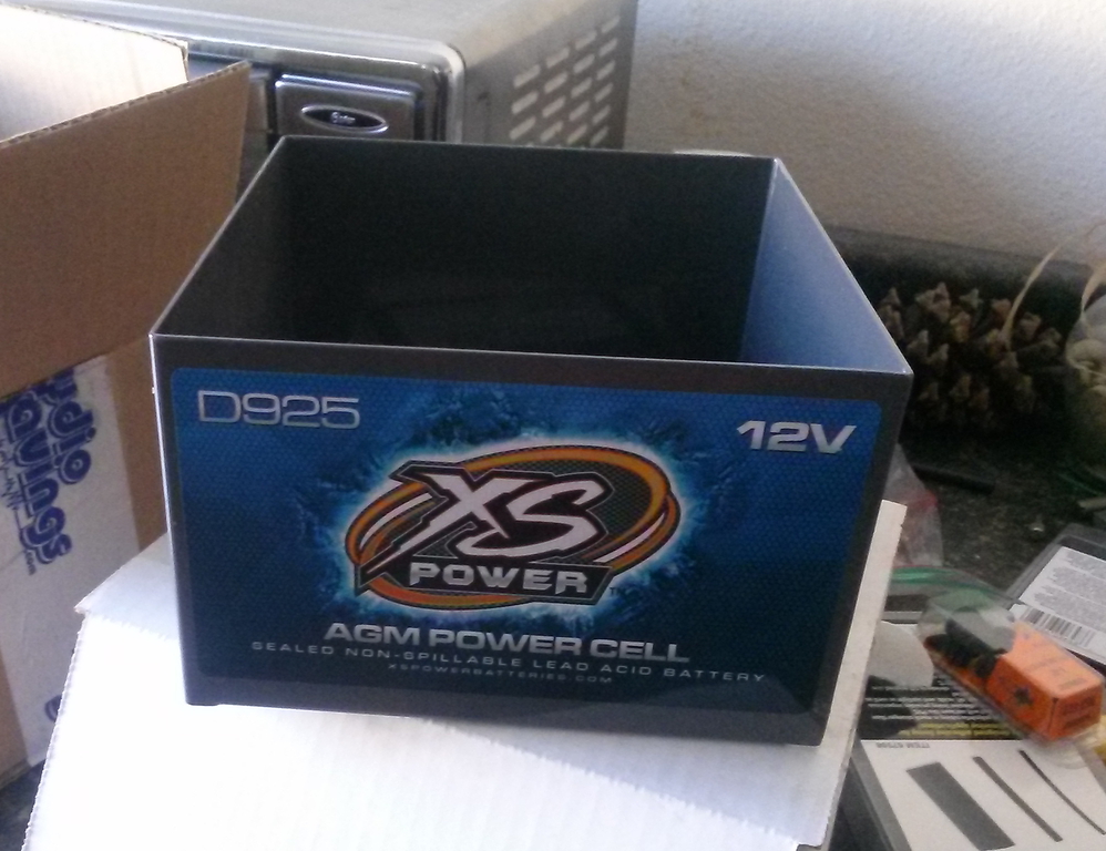

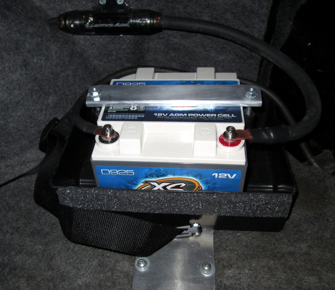

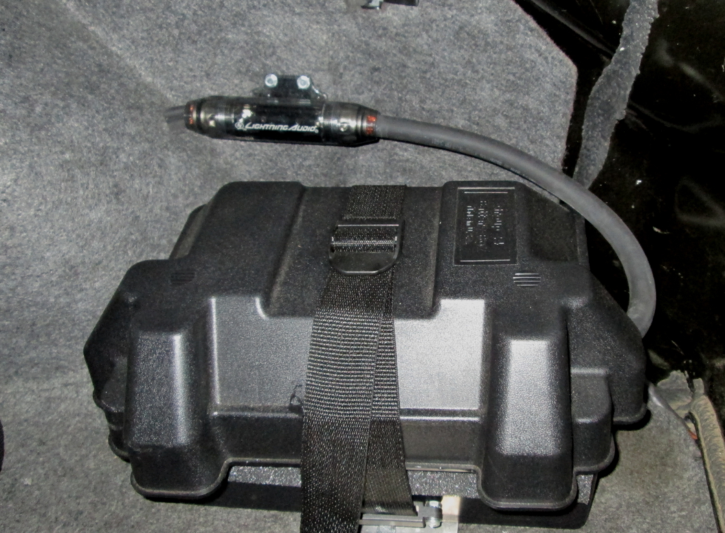

Here is the last piece of the I-Beam, 2 holes drilled into it and I had a tie-down for my new XS Power AGM Battery. I took a standard battery box and cut it in half, drilled some holes in the bottom and placed an aluminum bar and ran to standard threaded posts thru the battery box, I placed 2 pieces of vacuum hose around the threaded posts where they made contact with the battery.
