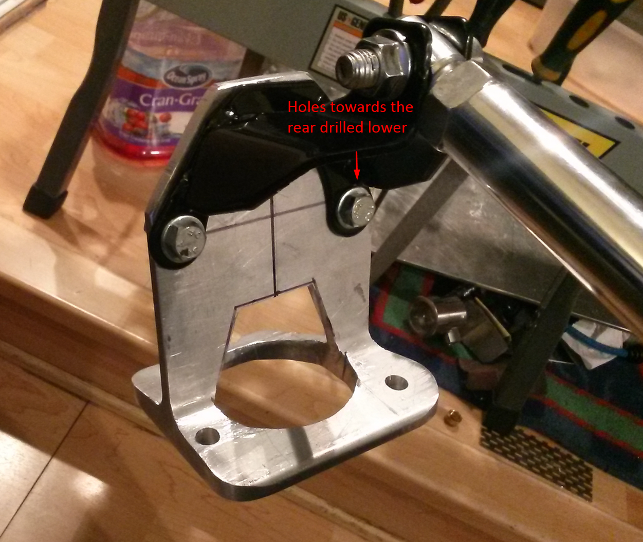

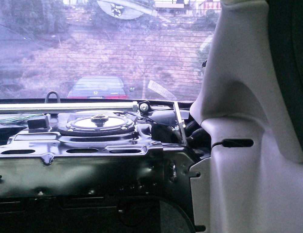

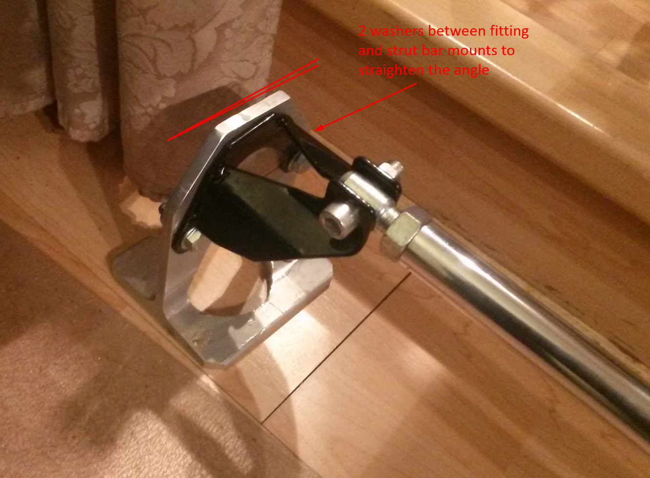

I almost forgot an important point: I bought an adjustable upper rear strut bar for a late 90's Honda from eBay. I cut about an inch and half off of the length and mounted it to the aluminum fittings. The mounting holes were drilled at an angle to compensate for the angle of the strut mounts. I also placed 2 large washers behind the rear hole to compensate for the angle of the strut mounts.

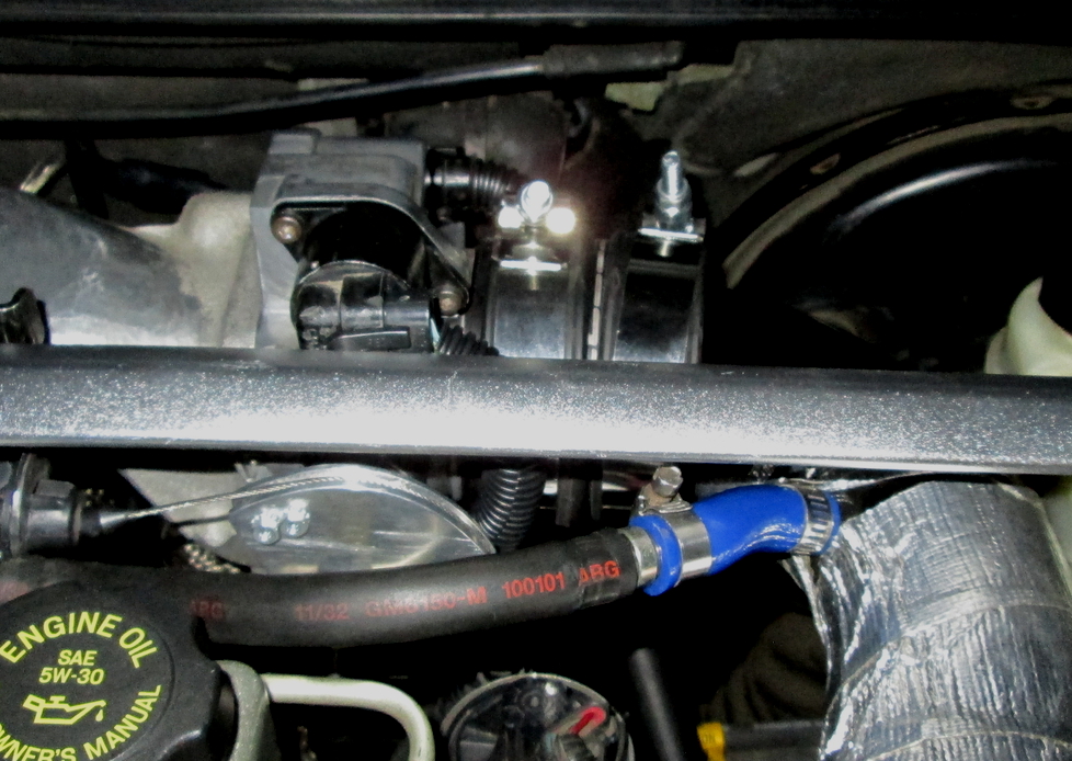

I have a cheap eBay front upper strut bar but it does the job. Beneath it you can see a custom throttle body pulley I made for a Storm TB.
