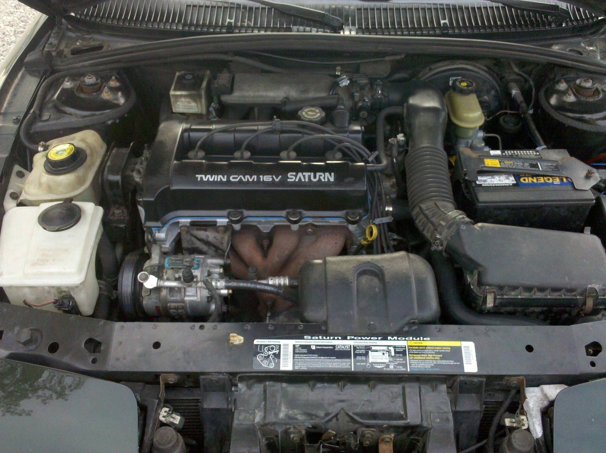

Here's the setup under the hood.
PCV valve itself vents directly back towards the intake. But there is another unmetered line connected to the intake air ducting between the throttle body and the air cleaner.
And of course, it slopes downhill towards the air filter. So I understand that if the PCV is not properly relieving the pressure, it's being relieved by pushing oil or vapor to the intake ducting. The combination of the unmetered positive pressure and the engine vac pulling on that port as the intake air heads to the throttle body make for a mess if the PCV is malfunctioning.
