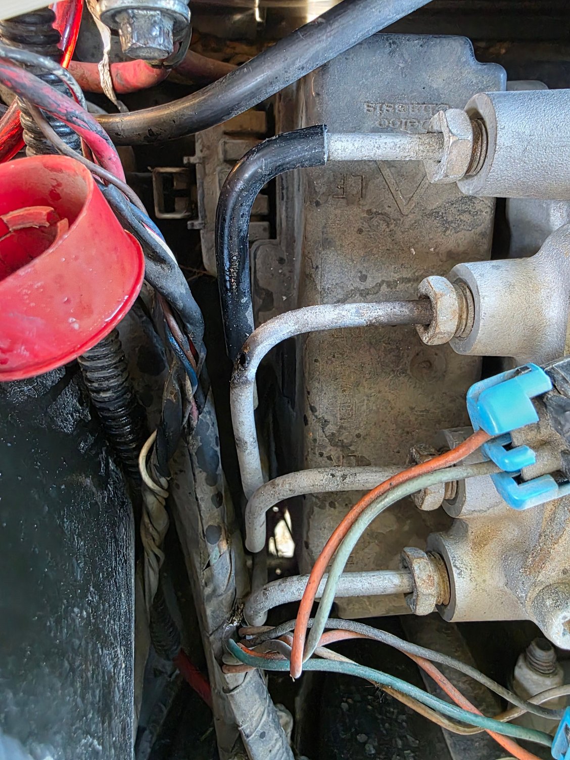

So i have a 98
coupe with abs and im trying to find a brake line replacement but I cant find a car with abs. I tried to use the vin reader and all the cars (including mine) just says "abs 4-wheel brake". So idk if its possible or im just gonna go around like a bum looking for the right one?

Pretty sure you will need to buy a length of brake pipe, bend it to fit, and add the connectors on the ends. I know preformed kits may have been available back in the day, but I doubt you'll find one.
Personally, I would not want to add scavenged 27 year old brake line to my vehicle. It's probably been drained and rusting in the yard.
Also, consider that if the brake line is failing in one location, the rest of the lines are probably also disintegrating at the same rate

Good advice Derf. Easy bend brake tubing is also available.
