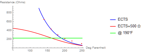

The cooling fan never seems to switch on when the car is already plenty hot, and perhaps it just waits too long. Here's my idea for a solution to lower the switch temperature, but I haven't tried it yet. The chilton manual says that the PCM uses a voltage to measure the resistance of the ECTS in order to decide when to switch on the fan, which is supposed to be at 190 degrees. My idea is to put a 500 Ohm resistor in parallel with the sensor, which has the effect of lowering all the resistances, and thus it should fool the PCM into switching on at a lower temperature.
I want to adjust the sensor because I think that the car is really much hotter than what the PCM is gathering. The temperature gauge on the instrument panel will show past the 1/2-way mark and the fan still doesn't switch on.
I think the measurement is already flawed, so I'm trying to compensate. I believe the gauge on the panel is more accurate than the ECTS.
