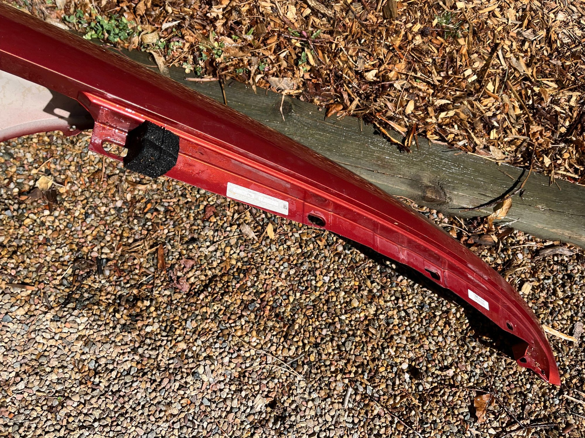

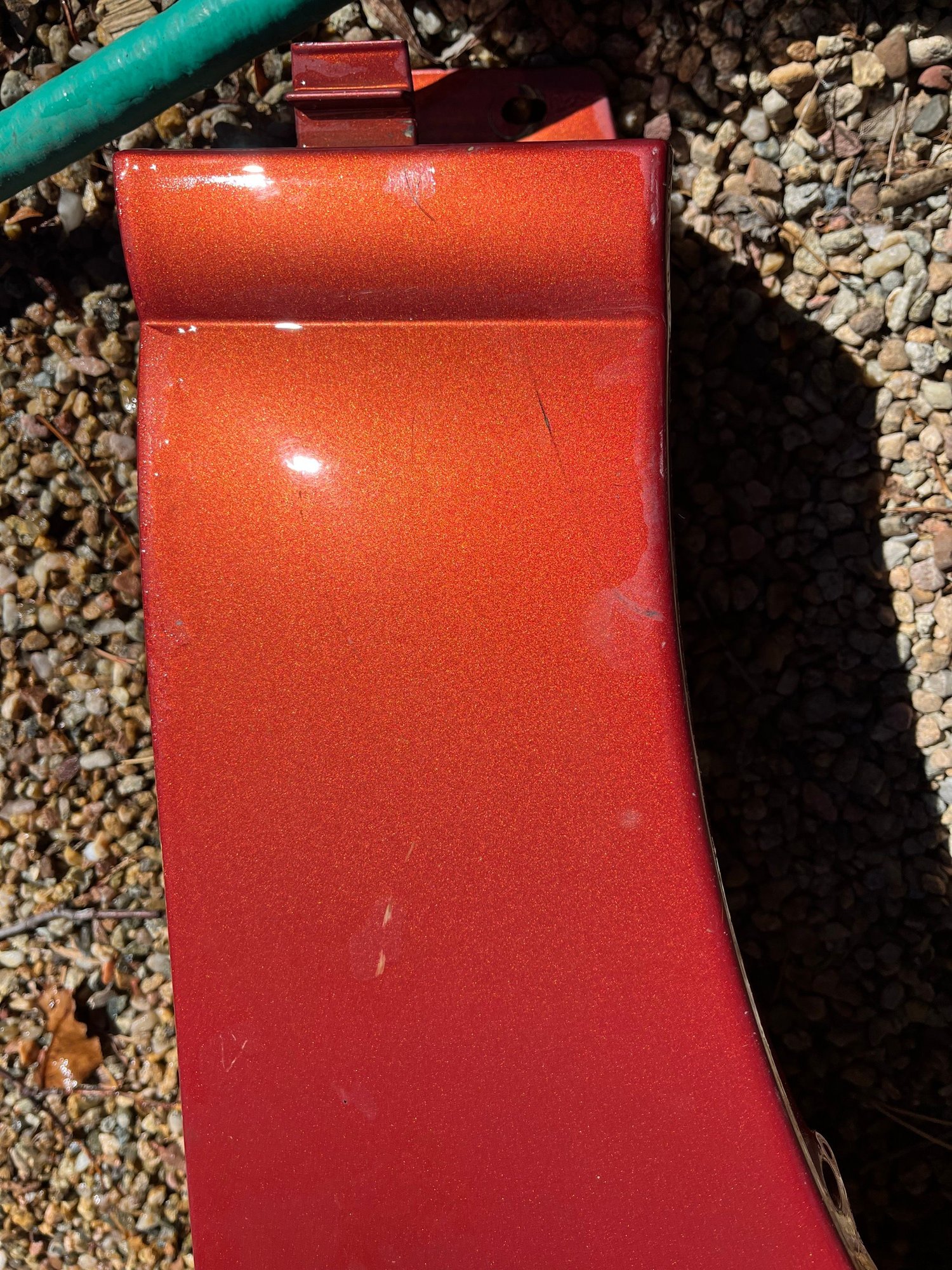

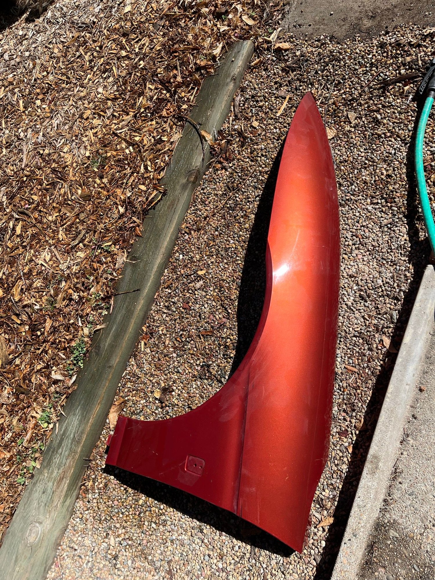

Yep, still available. Went out to take a few more photos. I hosed it off, but didn't wash it, so it's still got some dust. Biggest imperfections are what's left of some pinstriping, a few rock chips towards the front, and a few scuffs and scratches that look like they should buff out.
I still have the badge too, that will go with it if you want it.
Can see some leftover pinstriping - may come off with some buffing.
Some rock chips and shallow scratches
Yellow scuffs look surface only. The little t post at the top is also intact, usually broken off by heavy handed removal.
Nothing broken for the mounting holes
Top coat is in pretty good shape
