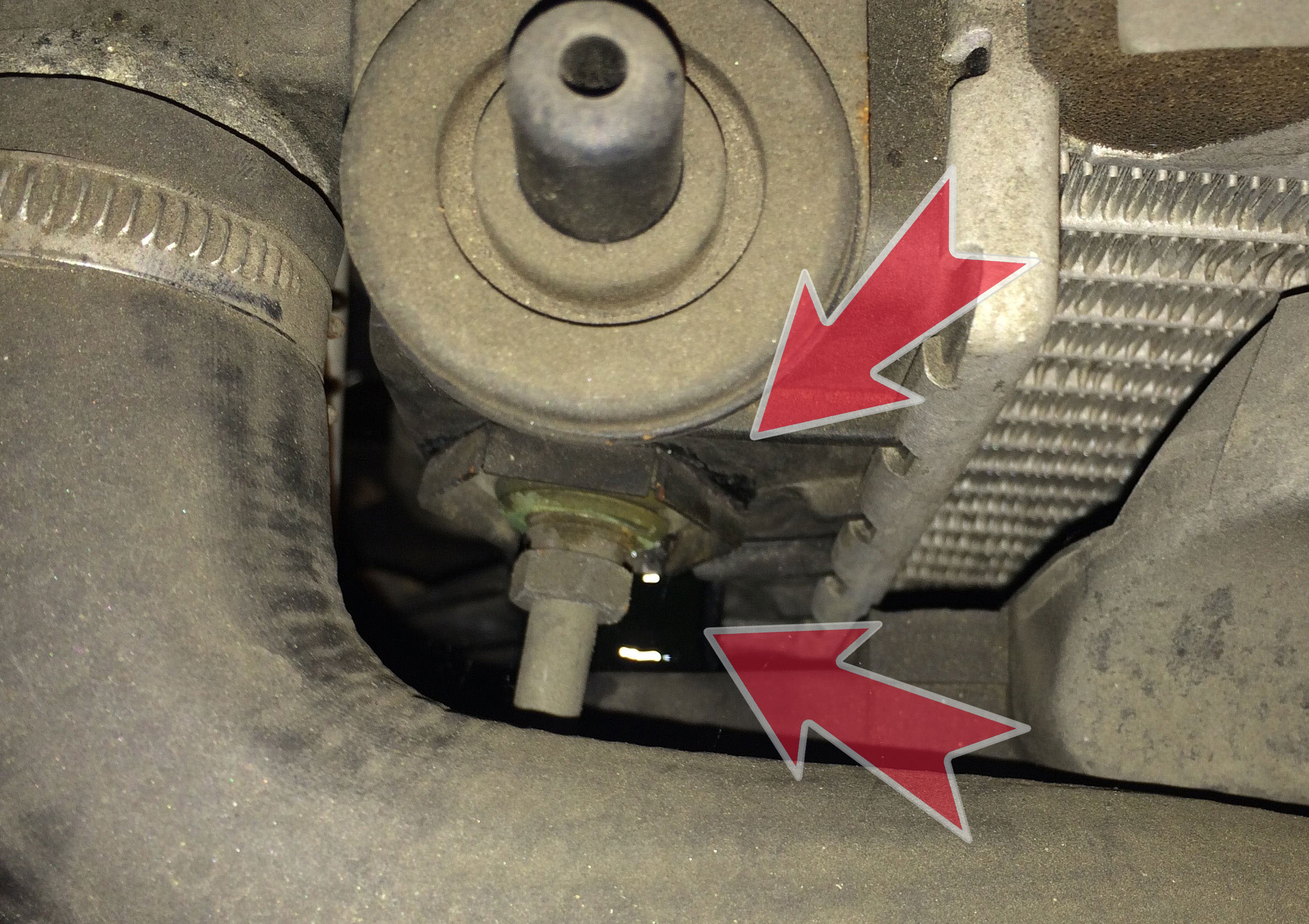

You mean the metal connection between the trans cooler line and the lower part of the radiator (not actual hose, correct)?
To me that, along with other things in your pictures, means several things.
1) Per Octavious, the tranny fluid is mixing w coolant inside the radiator.
2) The dark stuff in the coolant reservoir is a mix of coolant and tranny fluid
3) Since that dark colored "coolant" is circulating throughout the whole cooling system, that is what you see leaking at the fitting (yes? Hard to tell color of leaked liquid)
4) Is the coolant leaking FROM the fitting where the tranny cooler line mates w the radiator, or is there a crack in the rad tank that is causing the fluid loss? If it is the former, it MIGHT not require a new rad, only a new flared end on the tranny cooler line. If the latter, it will require a new rad.
Thanks Derf. Yes. Metal tube thing not rubber hose thing. Sorry. Here's a picture with arrows to point at what I'm referring to. (see image)

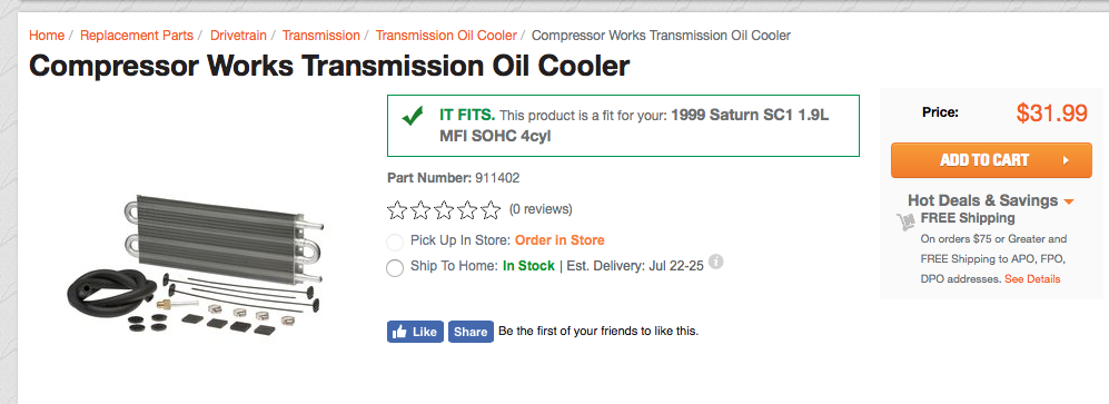

Q: If it is cracked plastic on the radiator.. what are your thoughts about bypassing radiator with an add-on transcooler? (see image)

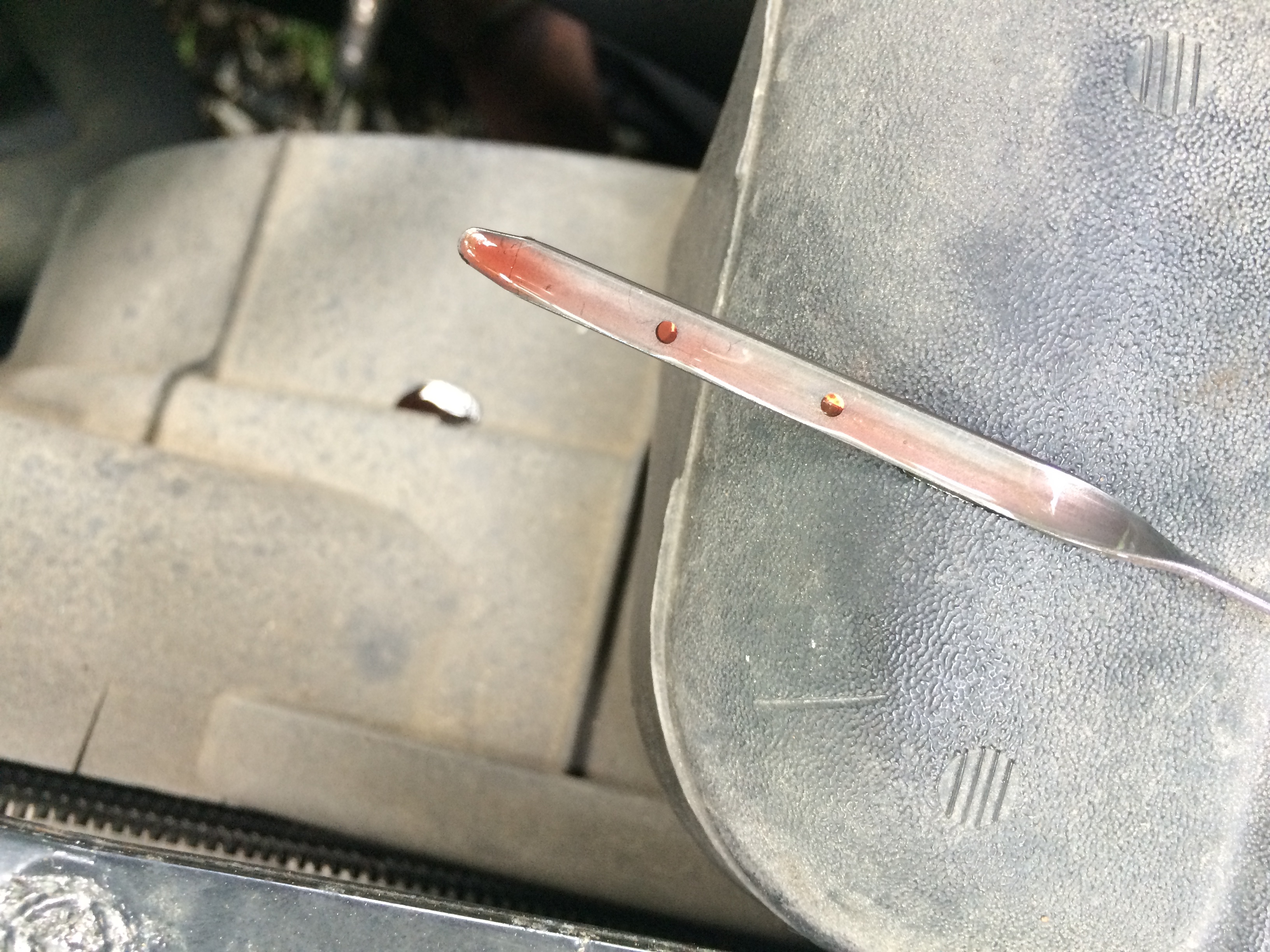

Transmission fluid looked clear and pink when I checked the dipstick (before I started engine though. I forgot to recheck after it was warmed up).
I can't remember if I am supposed to check when engine is hot and running or cold and off. I seem to recall it was the opposite of how you check the oil, but I can't remember what my dad used to say (RIP). I'm probably confusing it with something else.

If it is cracked plastic on the endcap of the radiator, then that says to me the rest of the plastic on both end caps MAY be getting brittle too. Meaning the radiator could crack somewhere else, and then you'd need a new radiator --- which of course comes with the transcooler lines in it. Plus you can get a decent radiator at Rockauto.com for $60.
In fact, you can get almost anything for $20 less than autozone at Rockauto.com.
So I'd say cracked rad plastic = new rad. Don't get a super cheapie.
Also, your present rad has tranny fluid in the passages which may or may not clean out well and may or may not have better or equal thermal conductivity properties than normal 50/50 coolant mix. Plus, depending on age and # of coolant changes, it may have deposits built up that it overall makes more sense to just replace the damn thing if you don't want to worry about it.

Tranny fluid was clear and pink while cold says you likely have not trashed things very far. Check the owner's manual. I think you check it at operating temp w car in neutral and ebrake on -- actually I haven't owned an automatic since 91 so just look it up. You may not be able to tell the difference in the tranny fluid since if the coolant tank looks like it does as a coolant heavy mix, you don't really know what you're looking for.

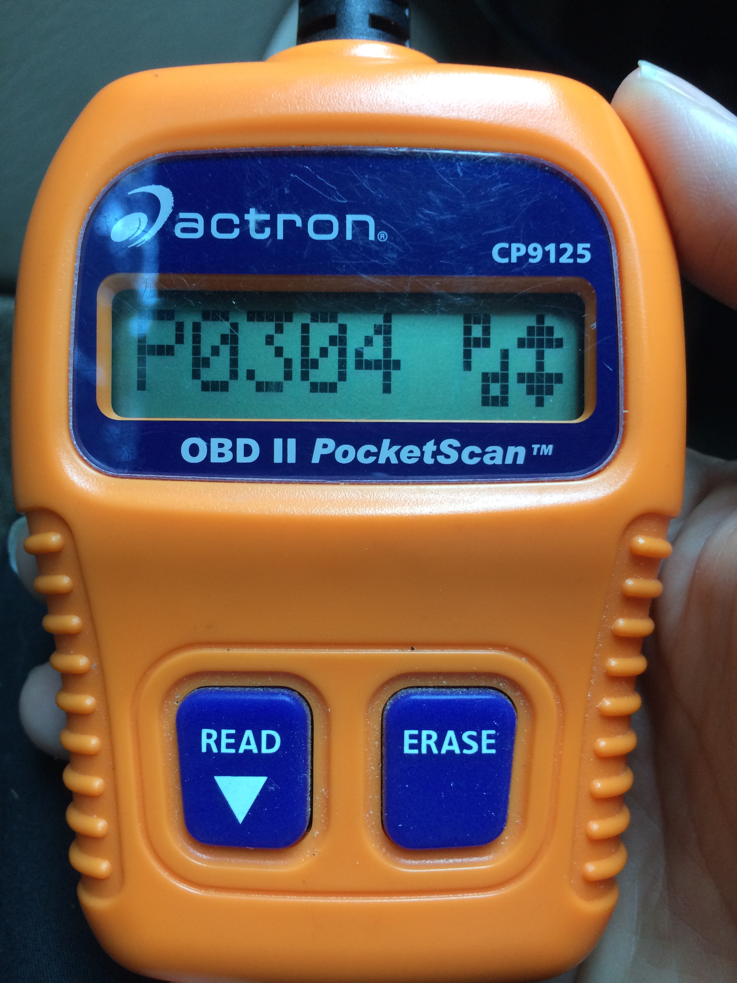

My brother in Afghanistan pointed out this morning that it is possible that the code could be from the rough start from sitting so long and nothing more. (That first start was really, really rough, but then it settled out). I never cleared the code, so it is possible the misfire is a non issue.
Let me clear the code and see if it happens again before I worry about compression testing.

The misfire could very well have been triggered by the rough start. But if you've been driving it and it is still throwing that code, it may be real.
Plus it doesn't hurt to check the plugs -- so I would at least do that for now

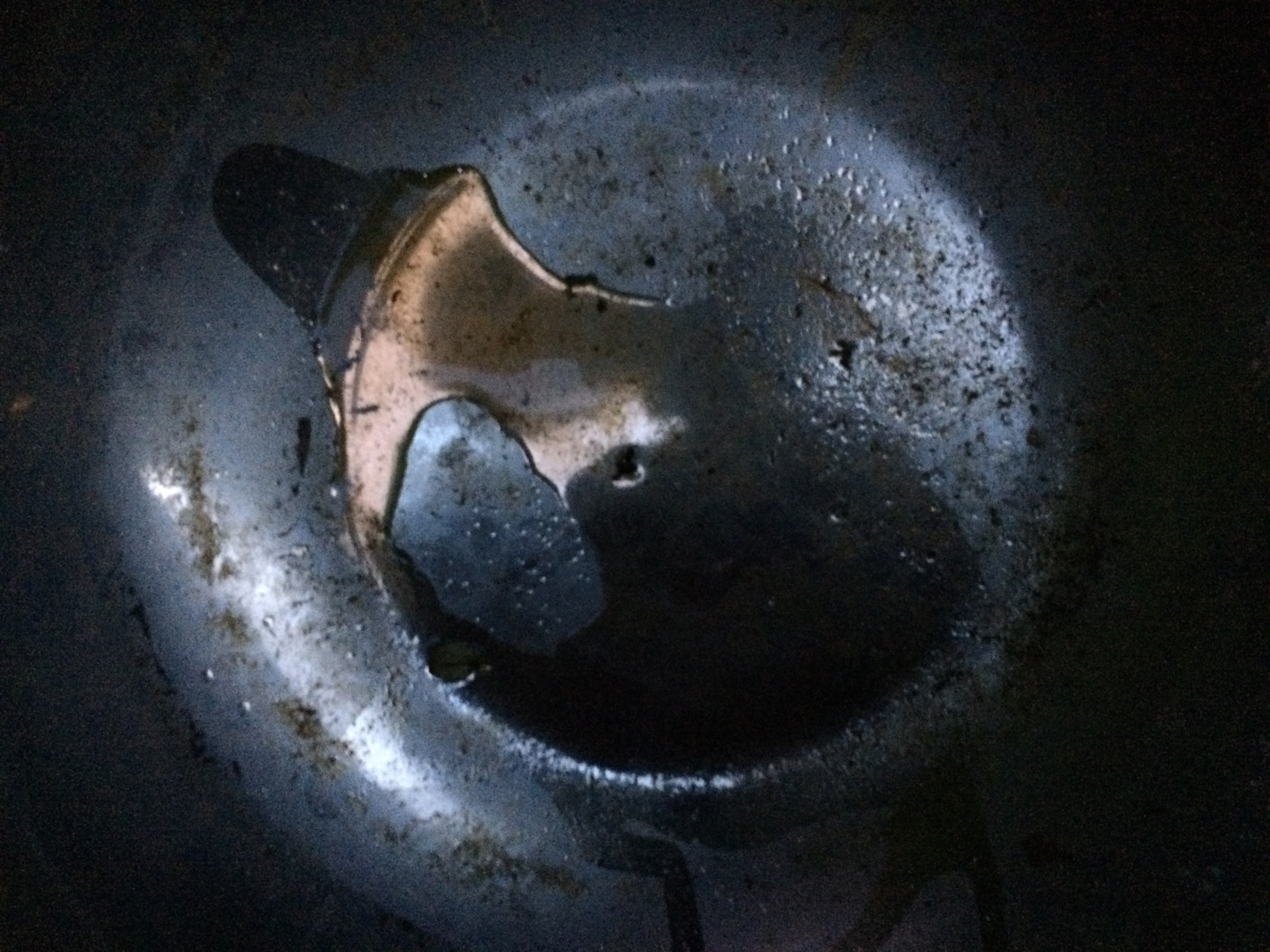

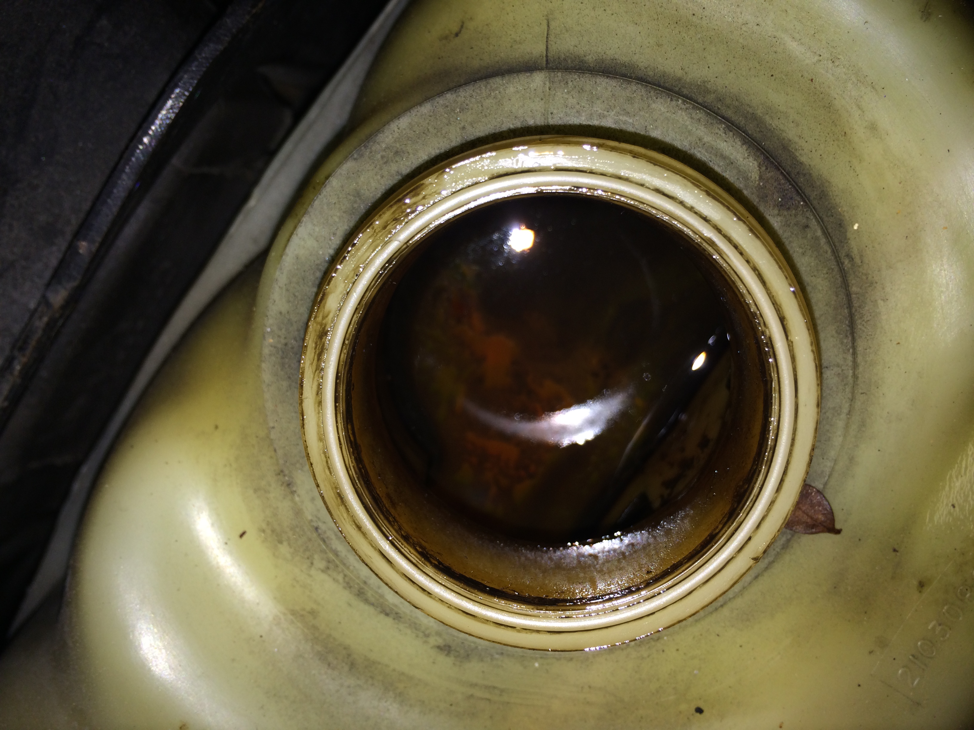

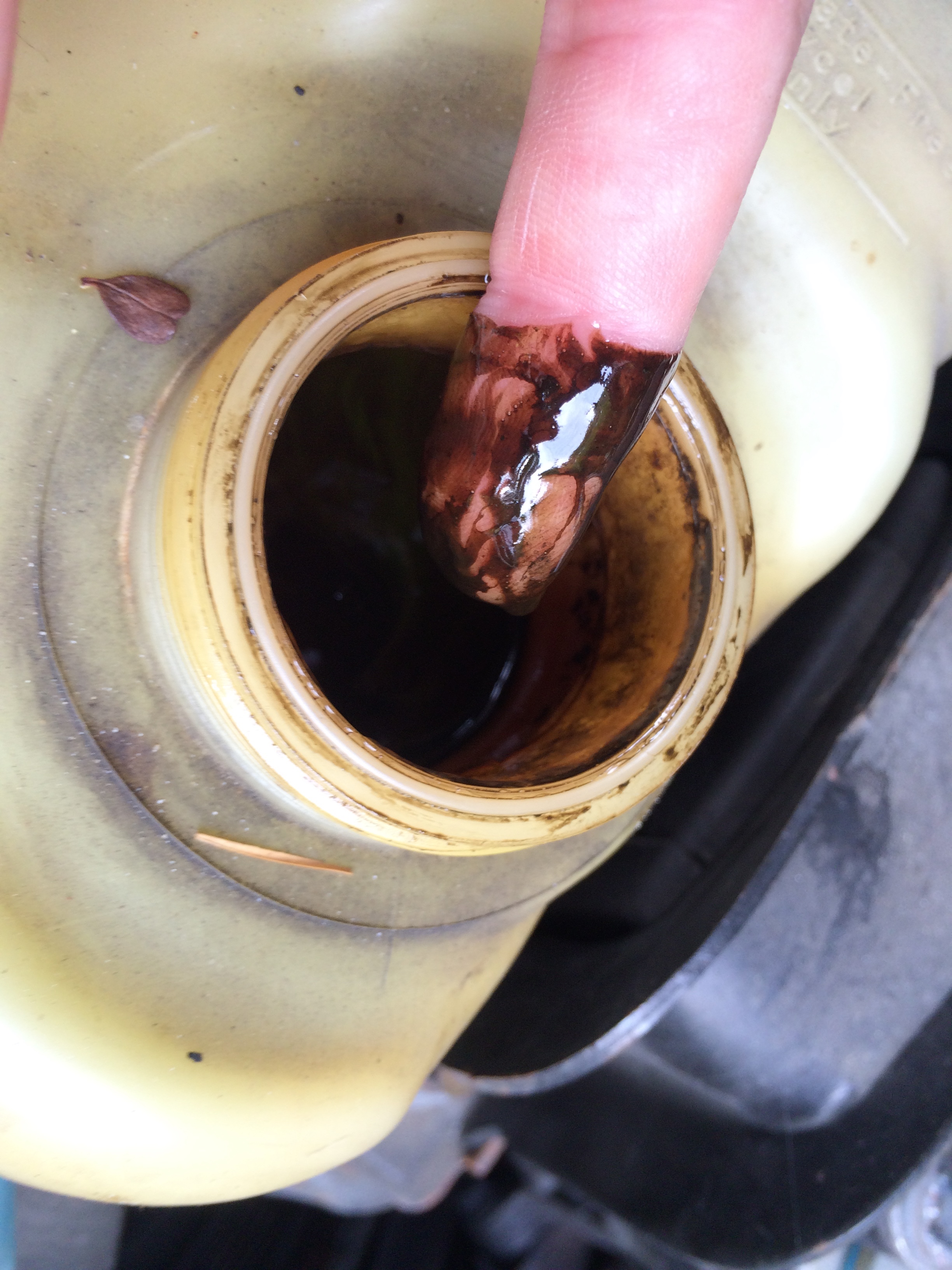

Yeah… doesn’t look good.

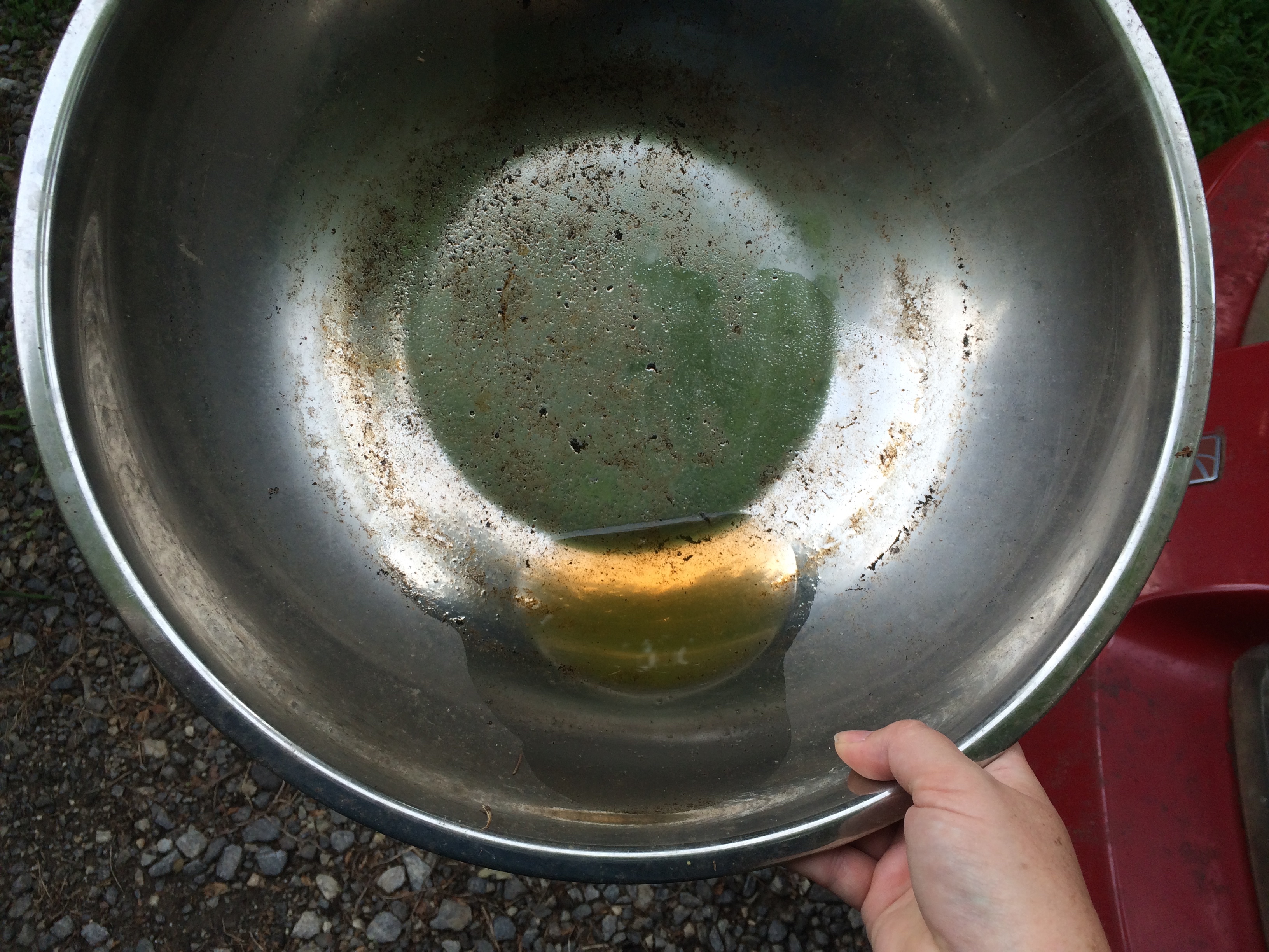

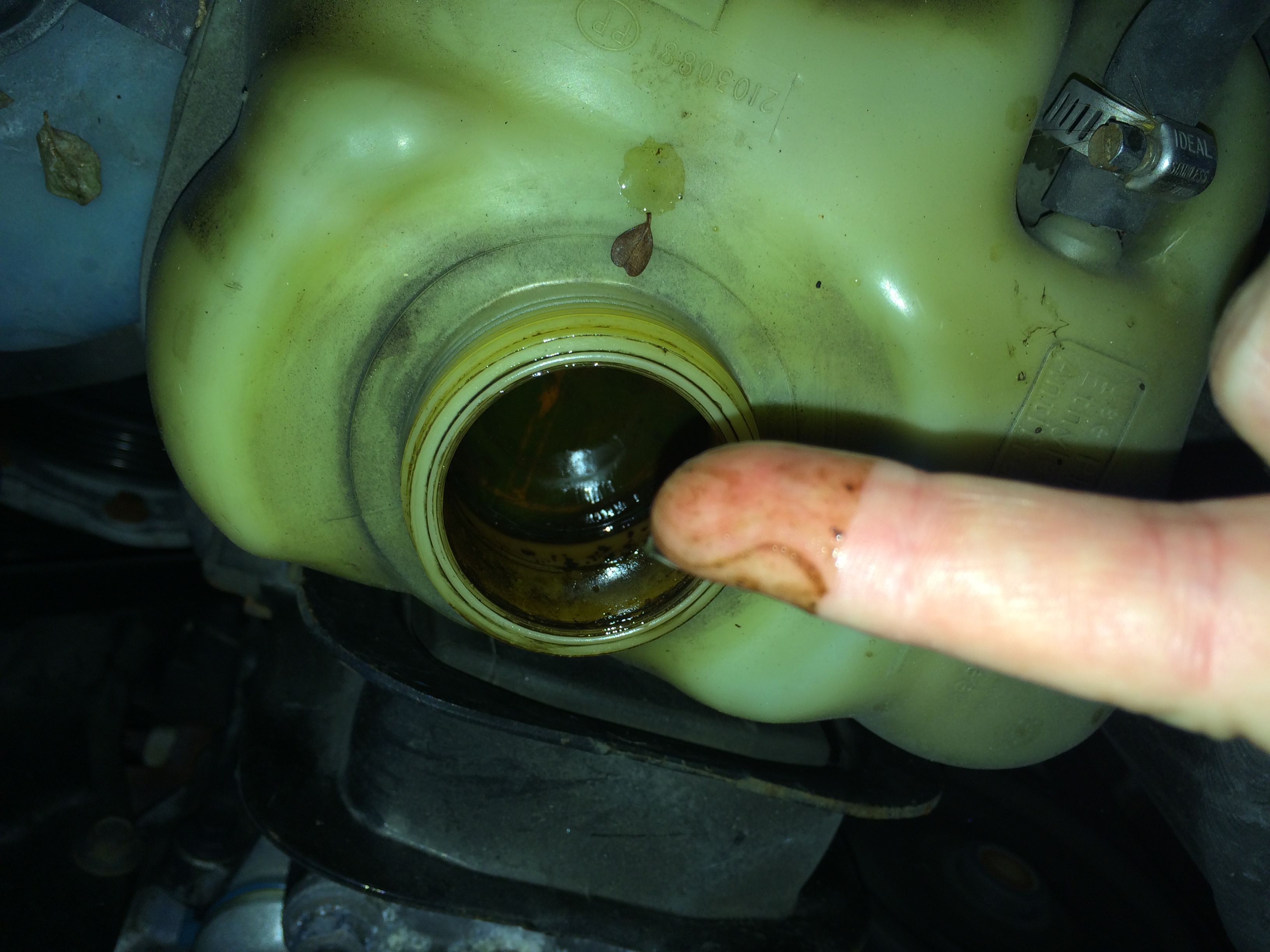

I cleared the codes and let it idle in place till it warmed up. Check the codes again and still getting a P0304 code (pending) with a hesitating idle, like it’s thinking about dying (even after warm). Plus it’s shaking all over the place like I broke a rear motor mount too. Uhg.
I took better pictures of the various fluids to show differences (see images)… and to be honest…. it does NOT look like ATF in the overflow. It looks like old burnt oil. Especially compared to the nice pink, clear tranny fluid on dipstick.
So.. yeah. I think I’ve got my answer. It might be fixable, but I don’t have skills, means, or money to go down that rabbit hole.
