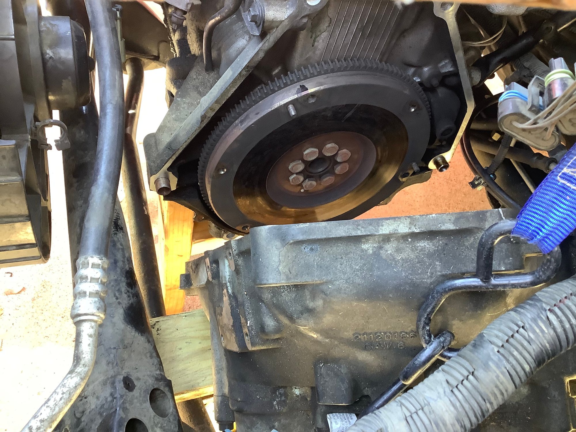

I separated them in the car with plenty of room to work using that write-up you posted ( excellent write-up) . I am having difficulty finding the shifter tower gasket that is referred to in the text . I found that if you remove the shifter tower then the entire trans. Can move towards the driver side enough for plenty of work room for flywheel change along with everything else. I just need assistance in finding the gasket for the shifter tower. Thanks to all for checking for me.

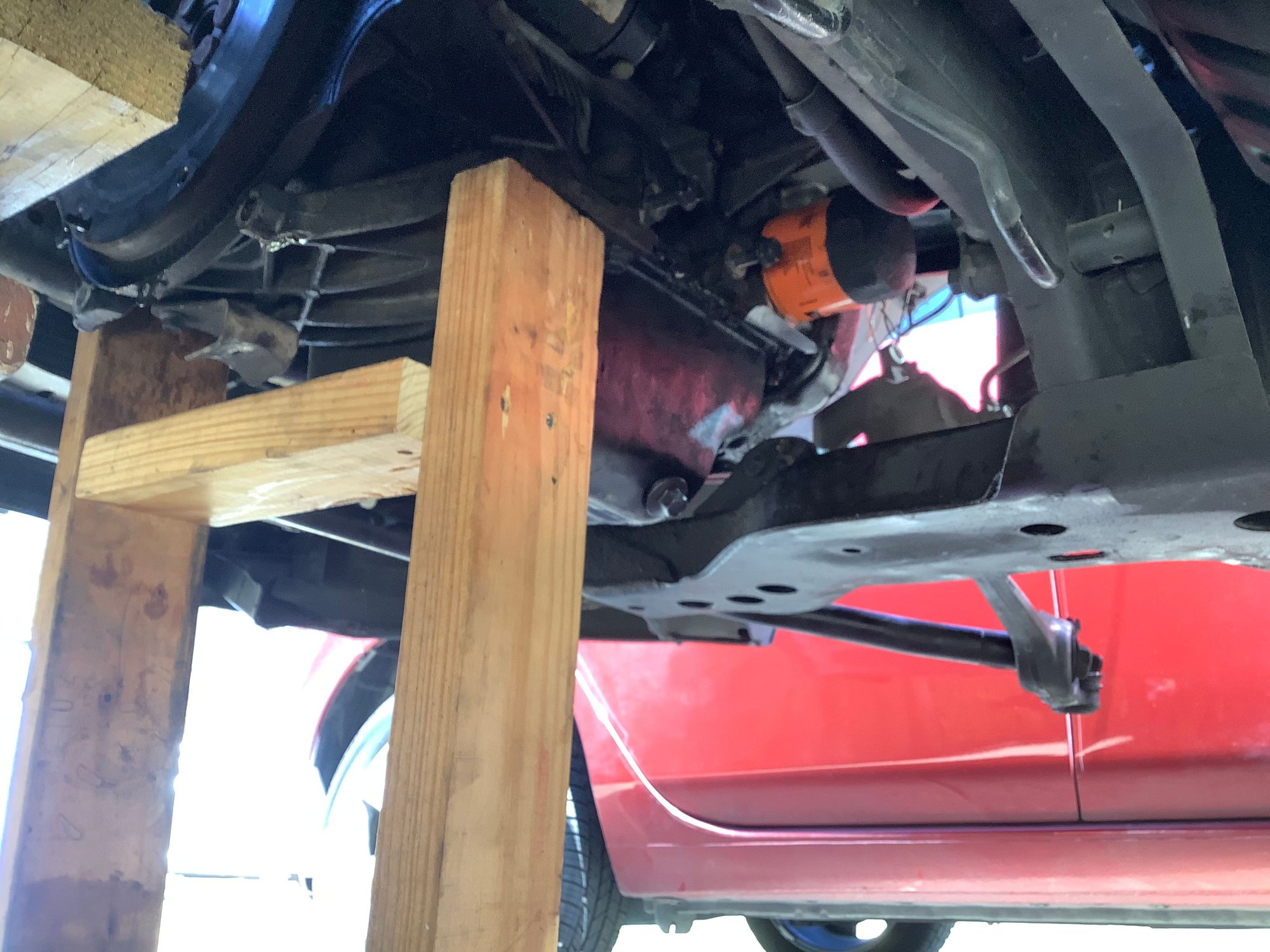

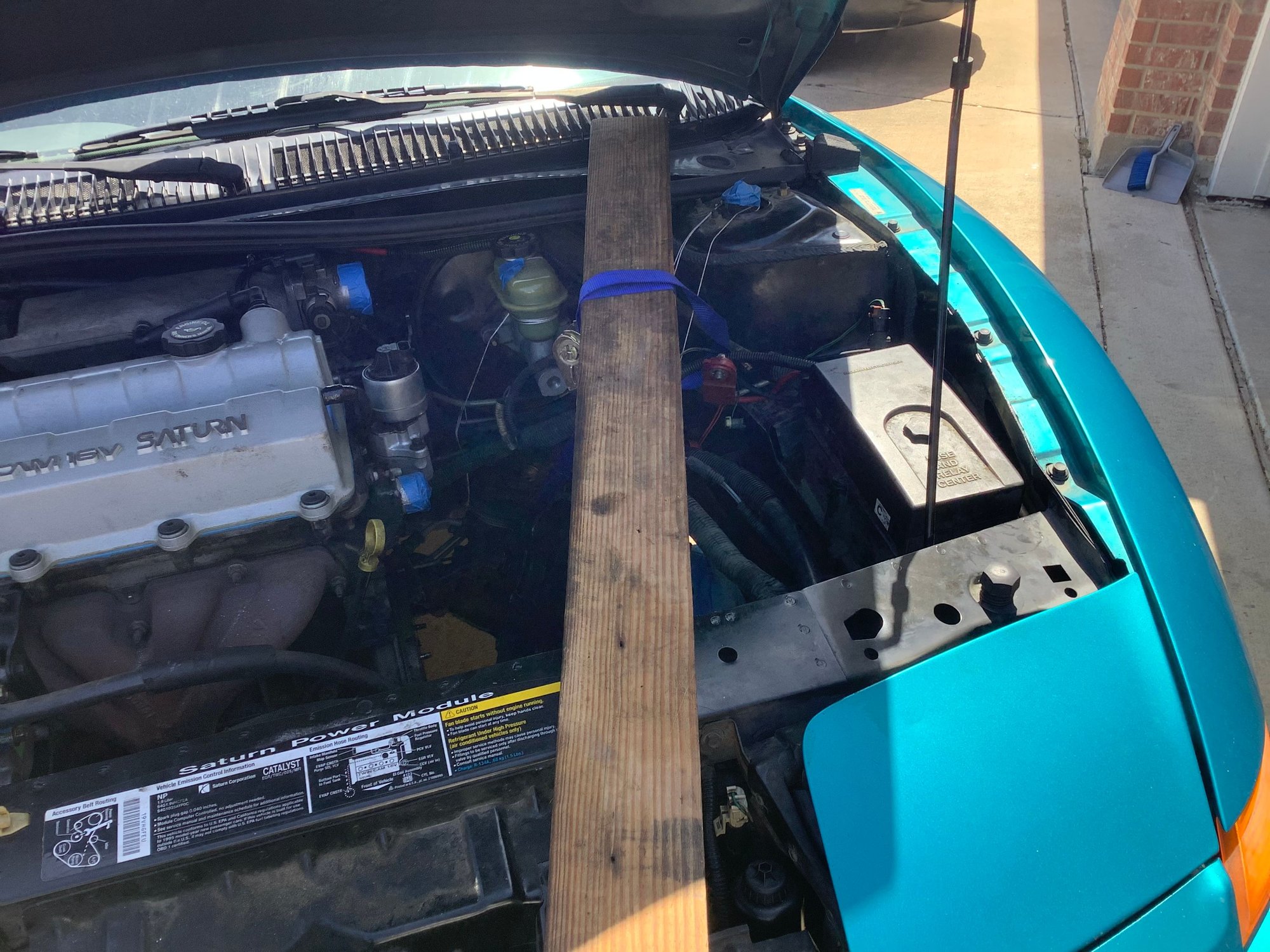

Considering all the help I have received, it is very gratifying to me to help in return. I am going to post a few pictures to assist everyone in seeing this unusual method I used but if all you have is a nice flat concrete floor or driveway, that is sufficient to do it this way. Pictures are coming.
Old Mar 26, 2022 | 03:06 PM
  #55
toby7878's Avatar
Joined: Feb 2022
Posts: 43

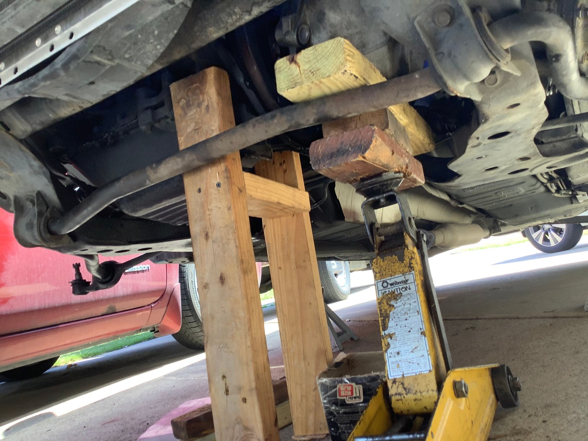

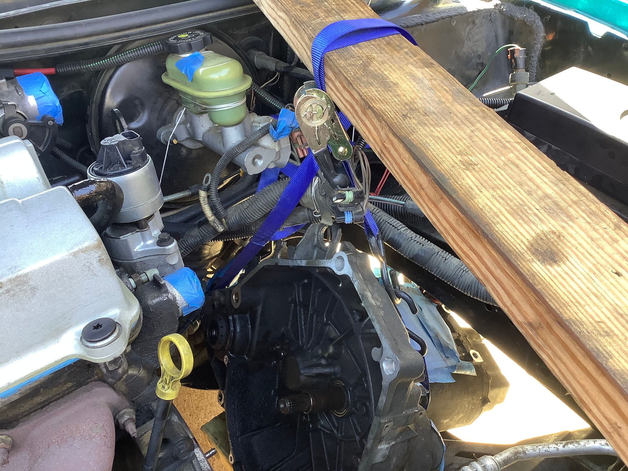

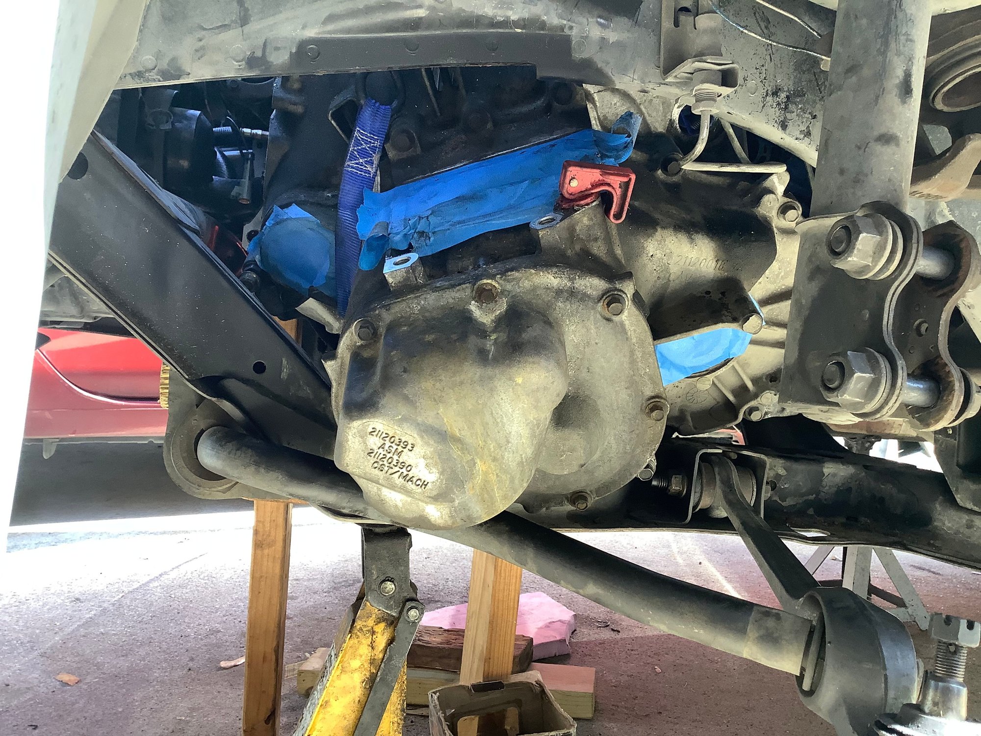

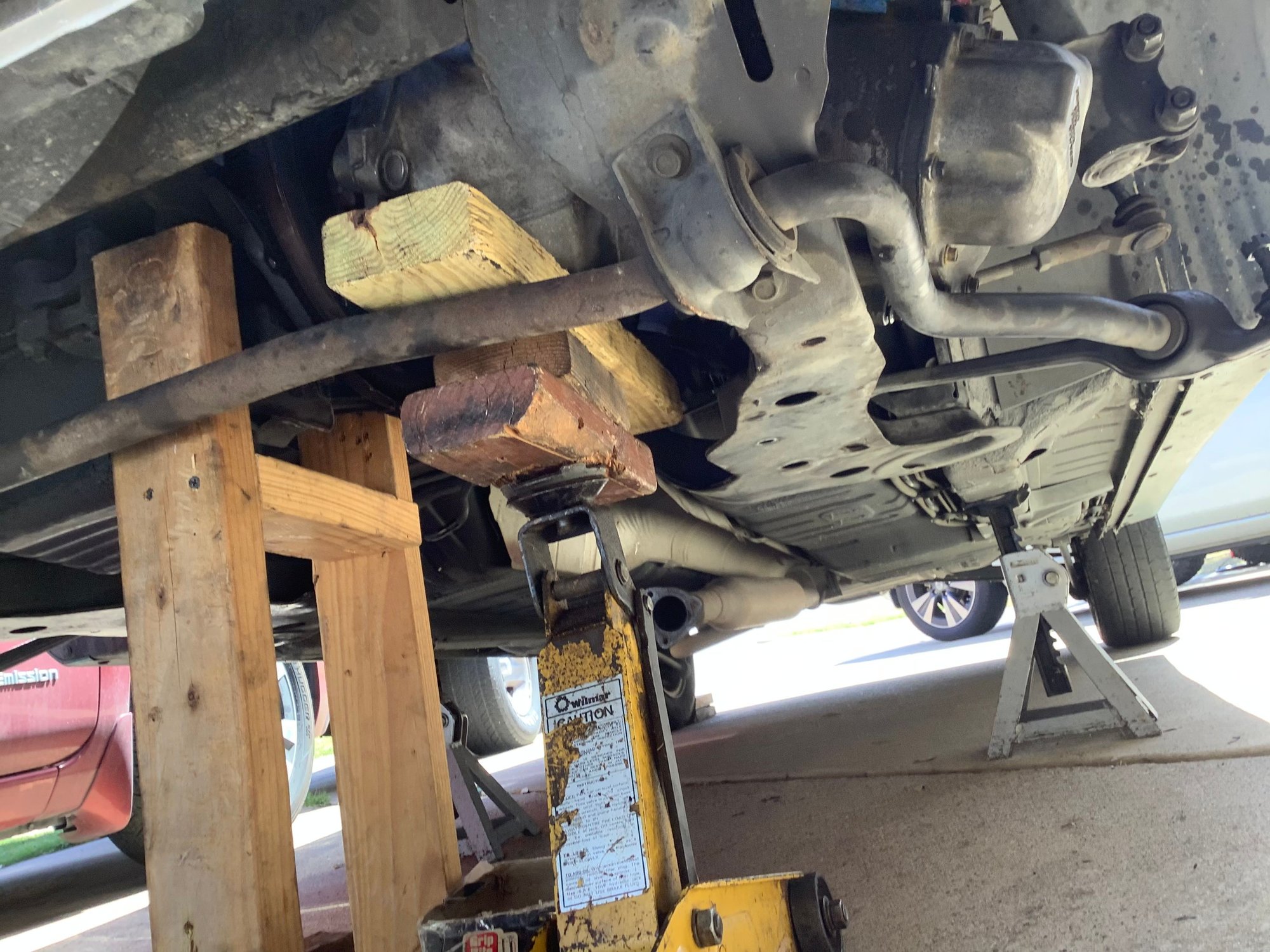

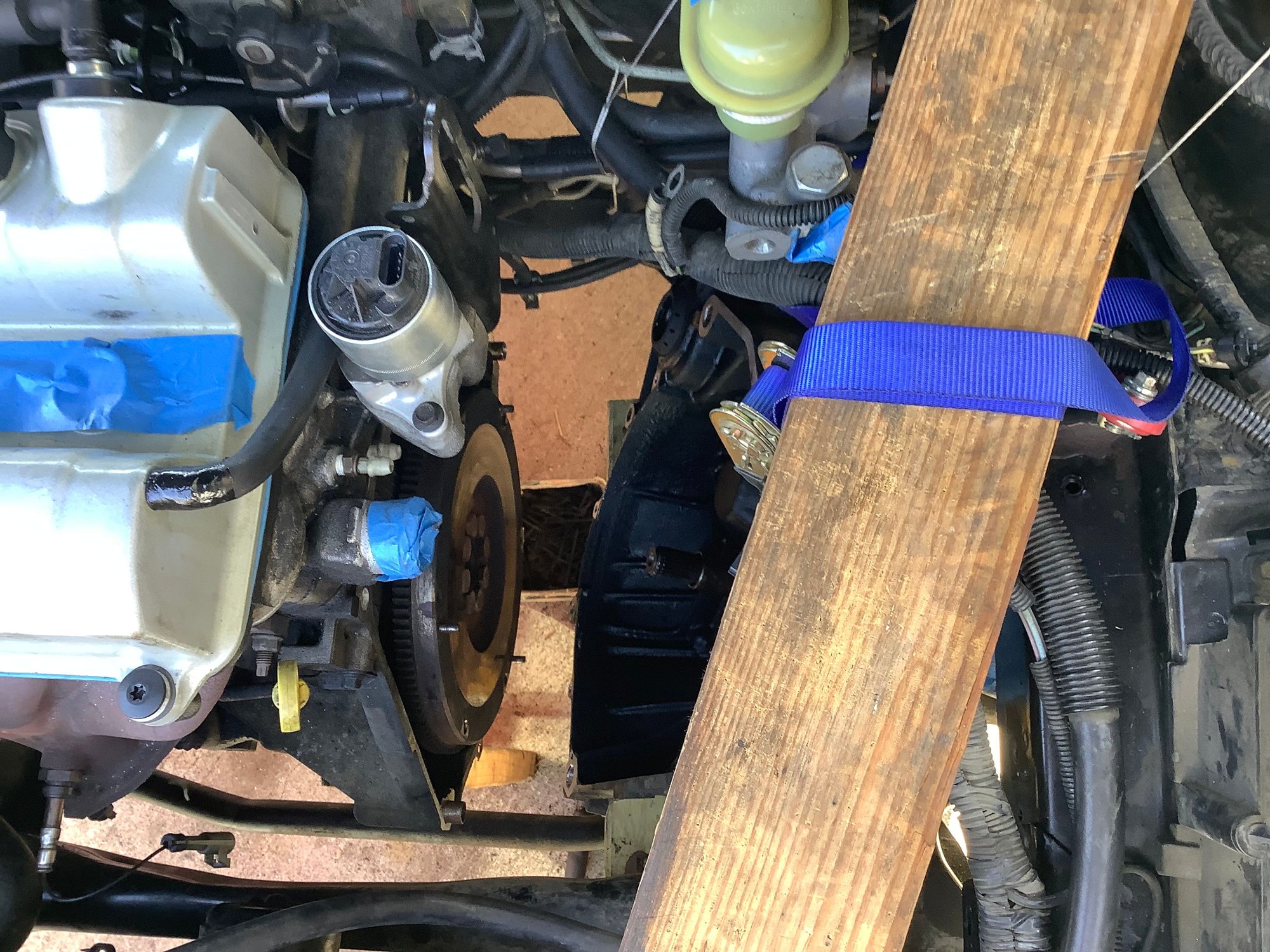

I understand that this could be construed as shade tree mechanic stuff but I have no lift or special tools but I do possess a great deal of ingenuity. So the pictures are showing an alternate method of supporting the engine from underneath. If the car is on jackstands , as it should be, then the car is stable. So how do we keep the engine supported? Measure from a solid flat spot on the bottom of the engine straight down to the concrete floor. Cut a 2X4 , do not cut it too short. You should have to tap it into place with a hammer. Duplicate that process for the opposite side of the engine. Then measure distance between the two boards and make a cross- member. Screw them together with 2 screws at each end. See photo. How do we support the trans. ? Other photo shows a 2X4 laying horizontally from firewall top edge to radiator core support. Don’t forget to remove the rubber weatherstripping! I used a ratchet strap wrapped around the bottom of the trans and over the top of the 2X4. Only tighten the strap enough to hold the weight not lift it yet. After following the steps that Derf provided, the two sections separated easily. Make note that for this to work correctly, you must remove shift tower to allow enough room for the trans to move sideways into driver side wheel well. Photos show all. Just for extra safety I have a floor jack also under trans. See photo. No other support for engine except the new TAM installed and the dog one under the crankshaft.
