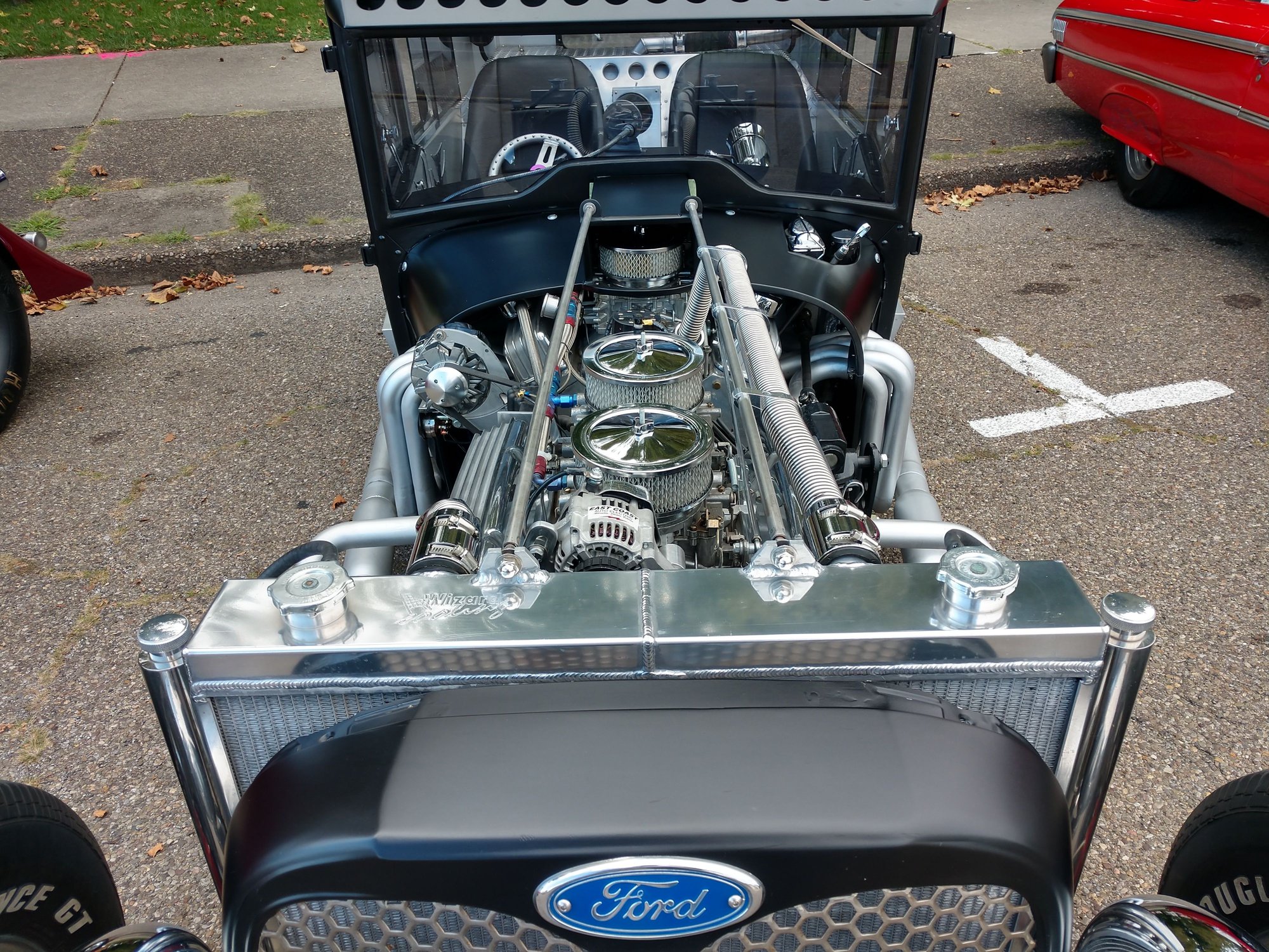

This thing was built years ago by two brothers who live in the town where my wife was born. There are three stores left open in downtown. They closed the coal mine decades ago. If that wasn't bad enough, they rerouted Ohio State route 7 to no longer go through town. To say it has fallen on tough times as an understatement. But then you see things like that that remind you there was a happy time around there sometime
It is also almost undrivable, as if you push the pedal too hard the tires simply break loose from the torque
