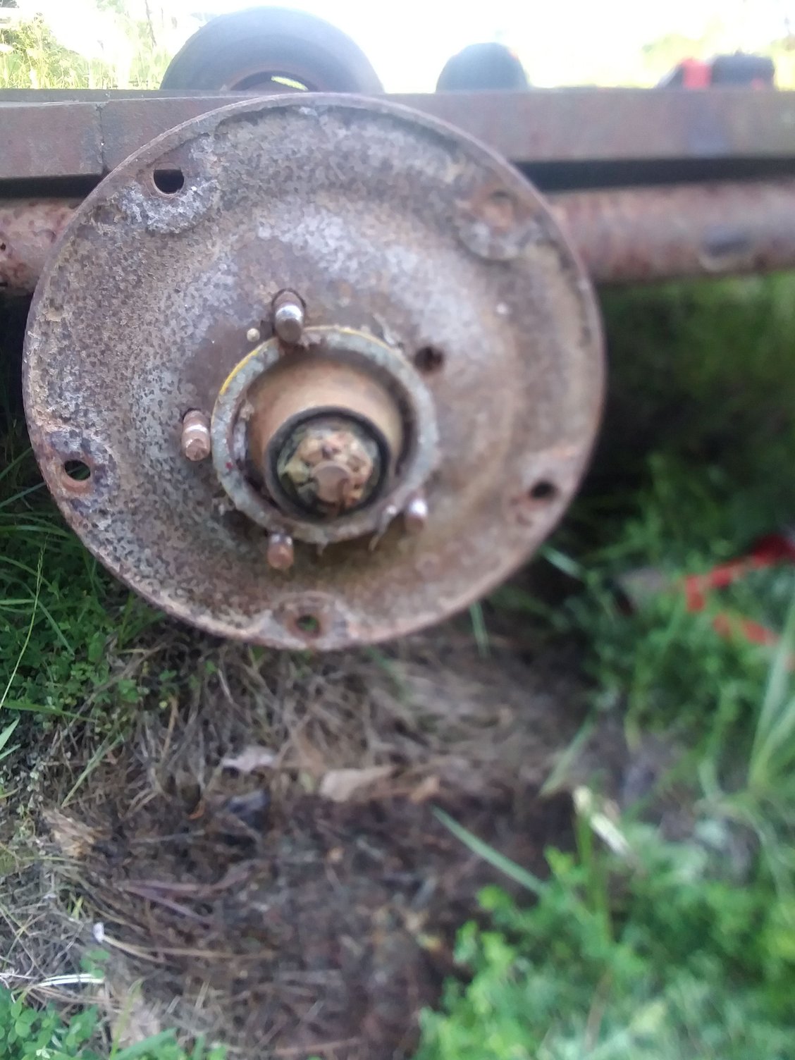

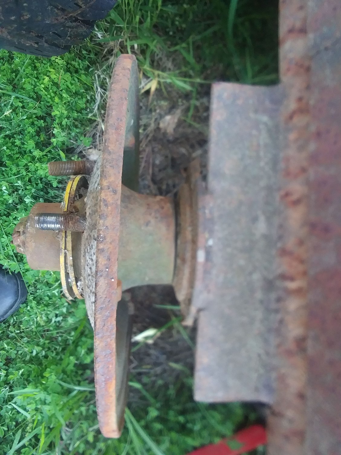

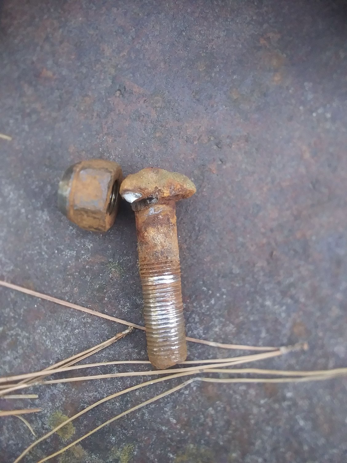

Bought a 12ft trailer off a gentleman a few weeks ago. I knew it needed tires so its been sitting due to weather. Had some time to pull the wheels off to measure and well, wheels are wollowed put and the lug studs are bent.
Trailer was thia guys grand fathers and he believes it to be around 60 years old. I'm going to guess that age is close since 1 tire is a good year stamped 1978.
They seem to be similar to boat trailer hubs but trying to find more info before I go to a trailer specialist and get annoyed by them trying to sell me over priced items.
Some look worse than this one. But either way they are all welded to the back of the assembly

If the wheels roll good and you don't hear any noise from the bearings, I'd just roll with it, Billy. I'd remove the studs and clean the hubs up, paint them and replace the studs with new ones. Maybe slide the hubs off, clean and regrease the bearings and put new seals in, but that's just preventative maintenance.
Old May 10, 2021 | 08:32 AM
That hub looks like a 1930 something wide five bolt pattern that someone added the smaller bolt circle to. And there are no springs so the tires carry all the weight with no give. If you mount a modern axle without springs the capacity is half. If you hit a bump at speed the trailer will go where it wants. Be careful Billy.
