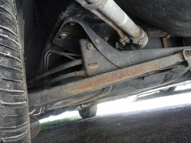

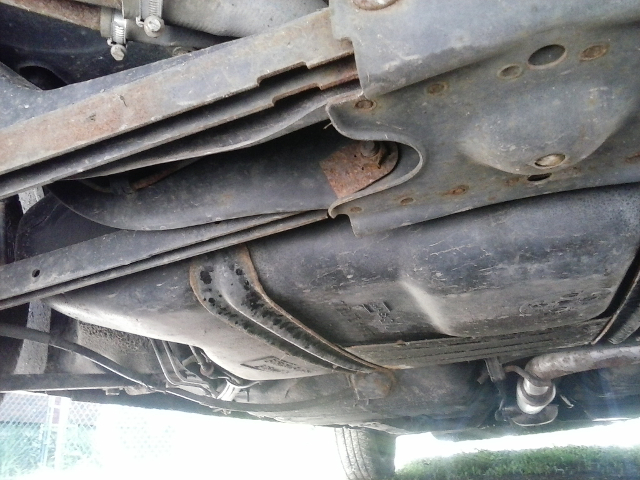

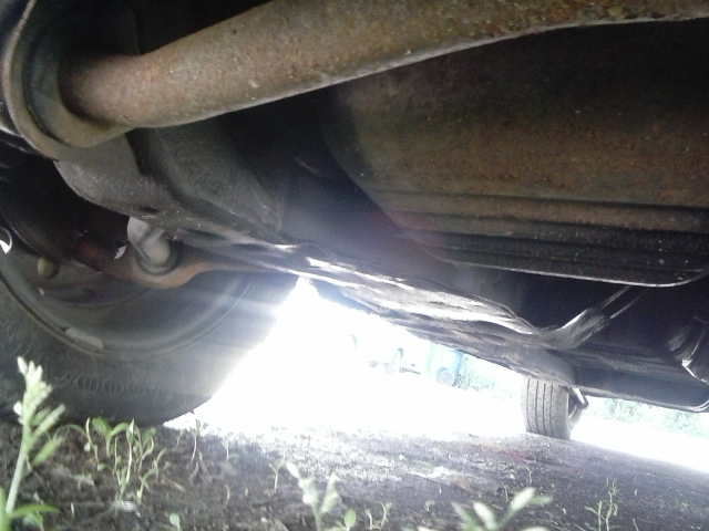

Hey Saturnvrocket,
What's the rust like underneath? Have you had the engine light scanned at an auto parts store to see what the code is?

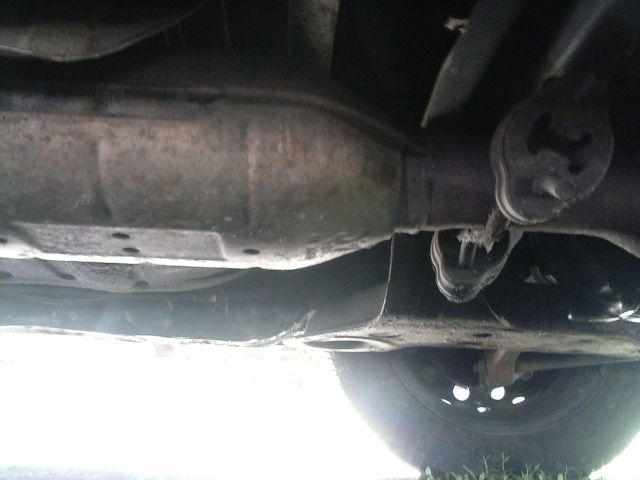

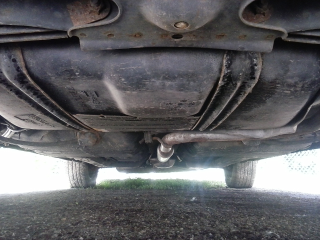

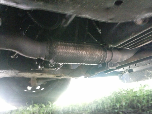

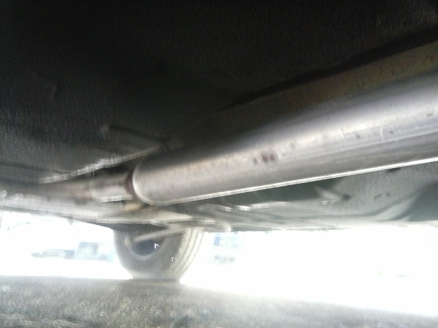

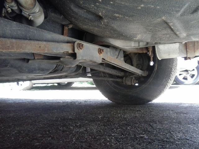

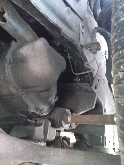

The underside is actually pretty good. This car lived in New Mexico for a long time, I moved to Michigan about 5 years ago. I'll attach some pictures. No, I haven't taken it in to an auto store.
Here's some underside pics. Rear:

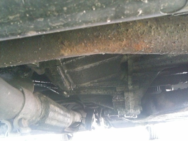

Front

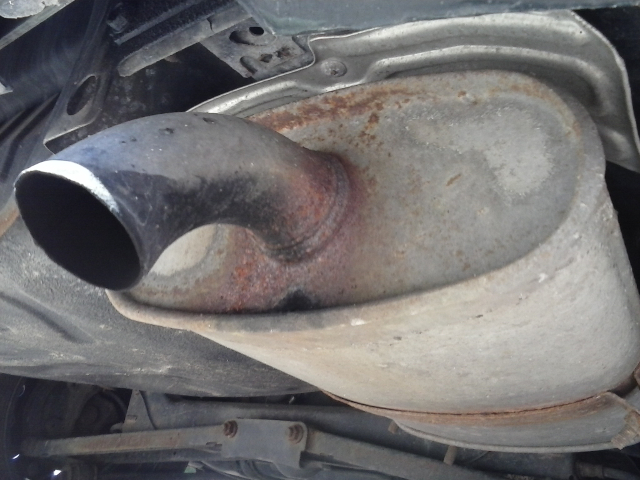

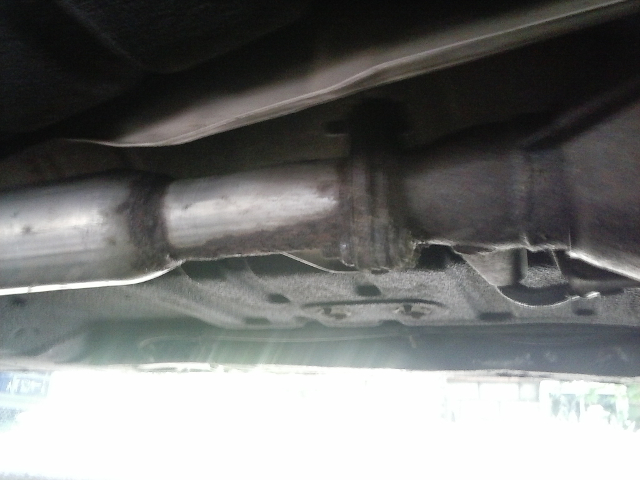

Exhaust

Thanks for your response, I can almost eat off that frame!
