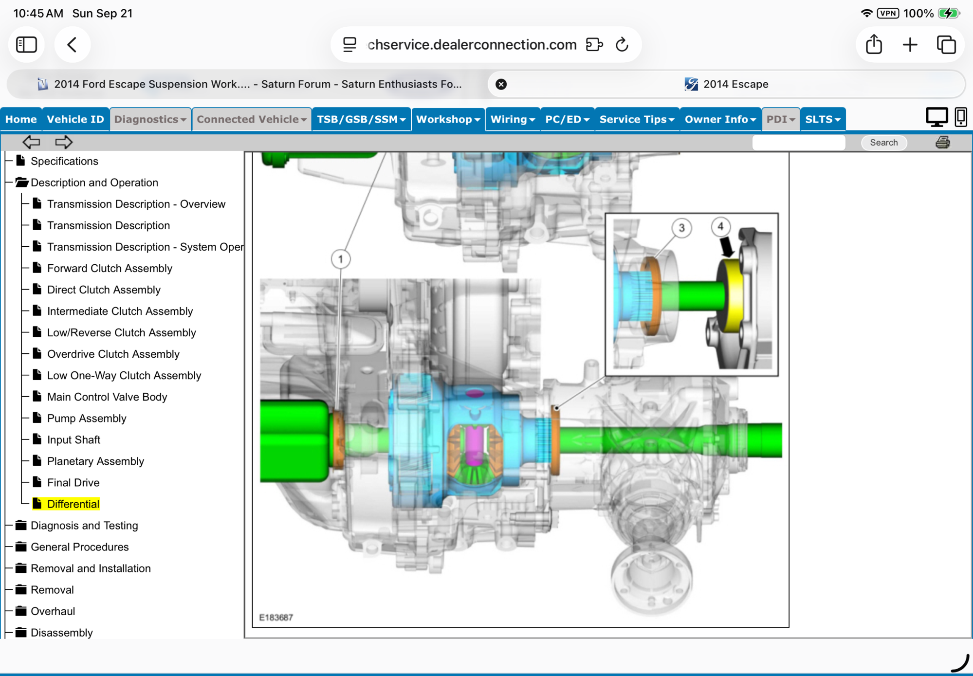

I would look for runout on the driver’s side at the transmission. I suspect a damaged side gear in the differential unit. The side gears are orange in this drawing. The orange gears are in the center, the side seals are also orange on the outside.

Oh, the splines do not fit "into" anything, they mesh with and are driven by the side gears.... . Guess I'm finally learning transmission/drivetrain.. it's about time. Thank you.

Any metal generated by this repair will show up on the transmission drain plug not the transfer case plug. You can see by the drawing that the passenger side shaft passes through the transfer case and is driven by the other differential side gear. You can take the driveshaft running to the rear diff out and the Escape becomes front wheel drive. The transfer case is driven by splines on the side of the carrier itself. You can see the external splines in the drawing on the blue carrier. They mesh with and drive the transfer case.
