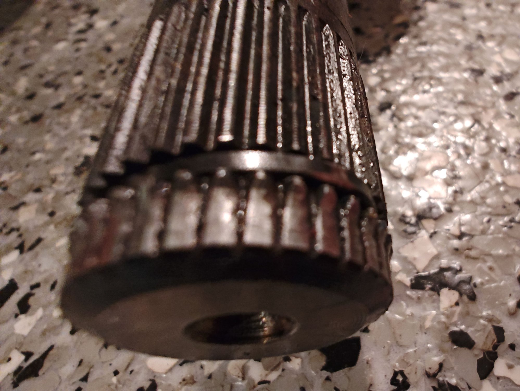

Yes I do. I meant CV axles or not installed properly, not the struts. I will attach a few pictures but the driver side one actually has the splines worn off of the very end up to where the circlip comes. Not completely worn off. I did have trouble getting that one in but it finally went past where it was hanging up. Apparently not far enough. As I was changing the oil today and the transfer case fluid, I realized that when I was tightening the axle nut on the passenger side, I had a crowbar across the studs to keep it from spinning but while I was tightening, it's like everything momentarily slipped, like the rotated maybe 45° but then immediately caught again. I didn't realize at the time that this told me that the axle was not properly seated.

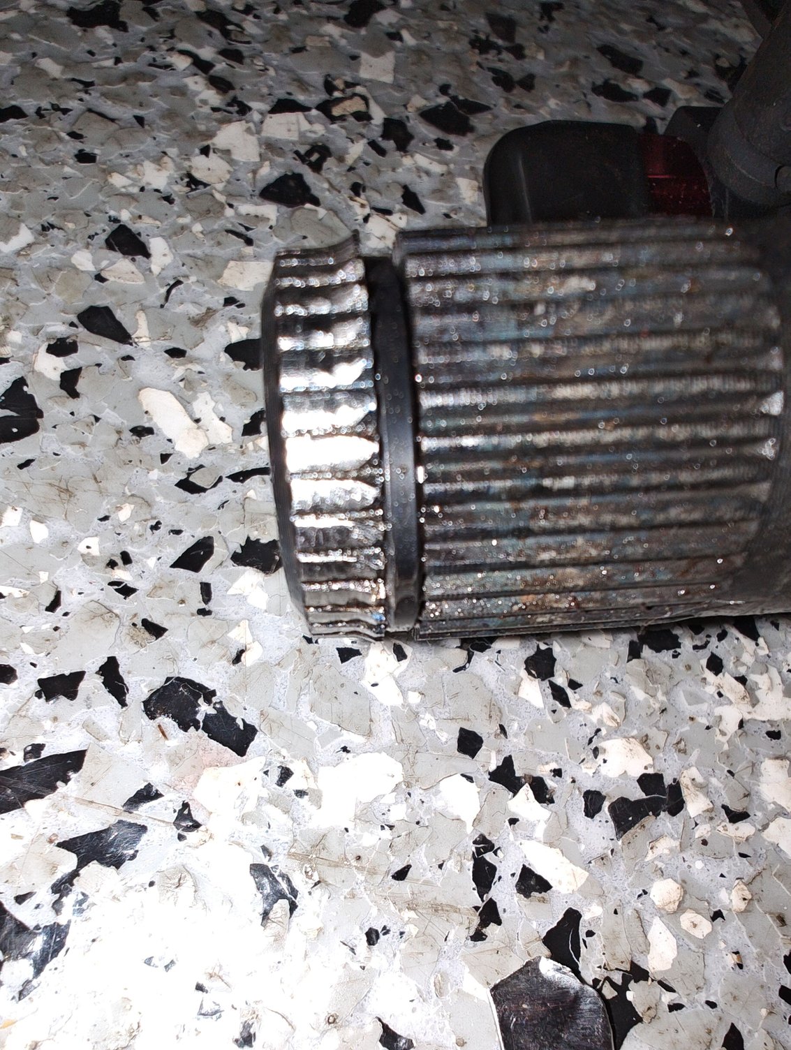

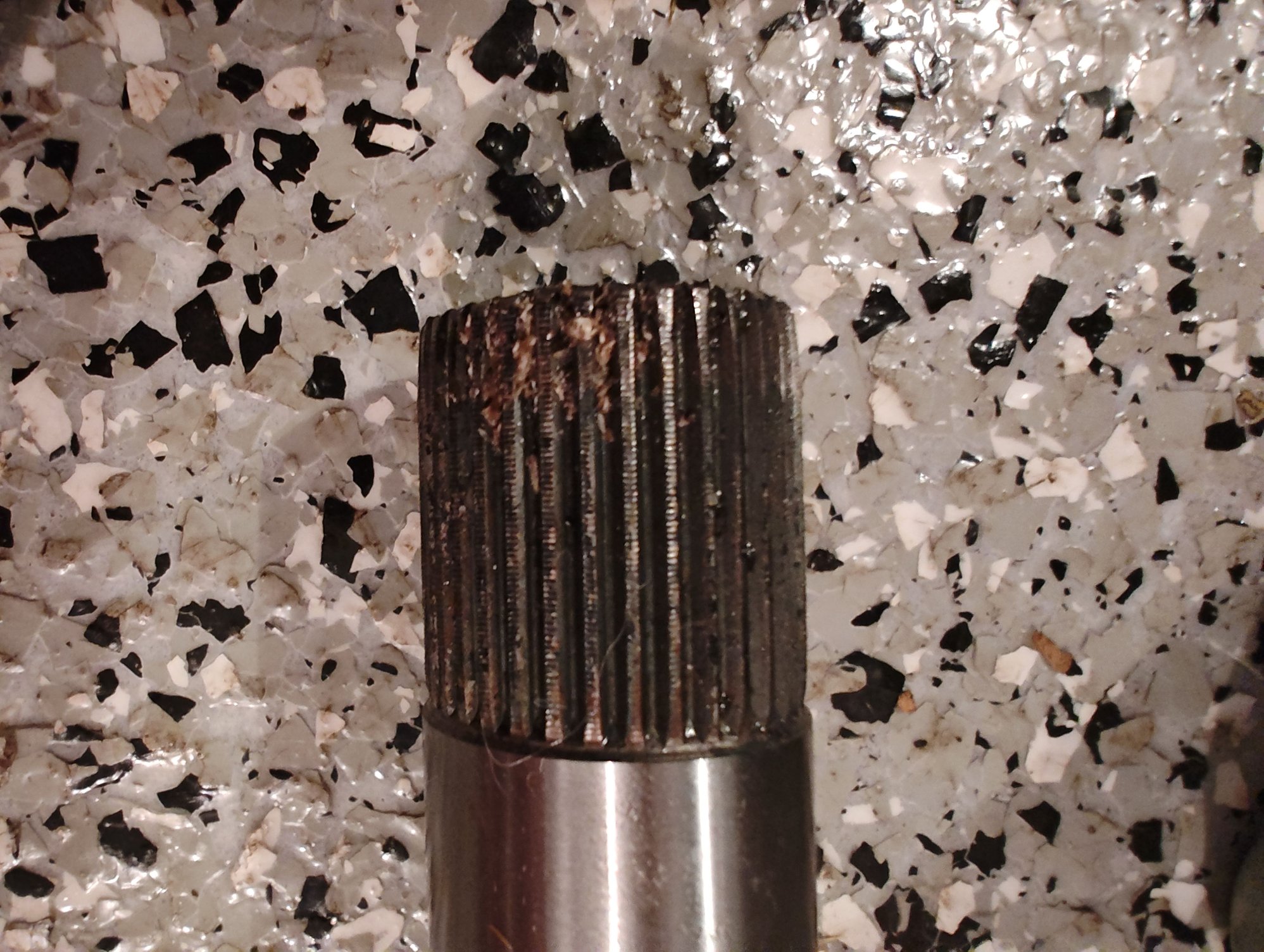

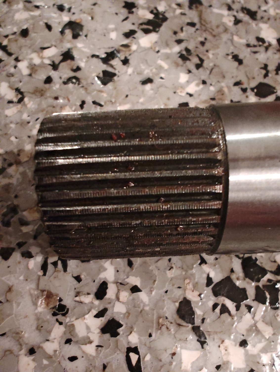

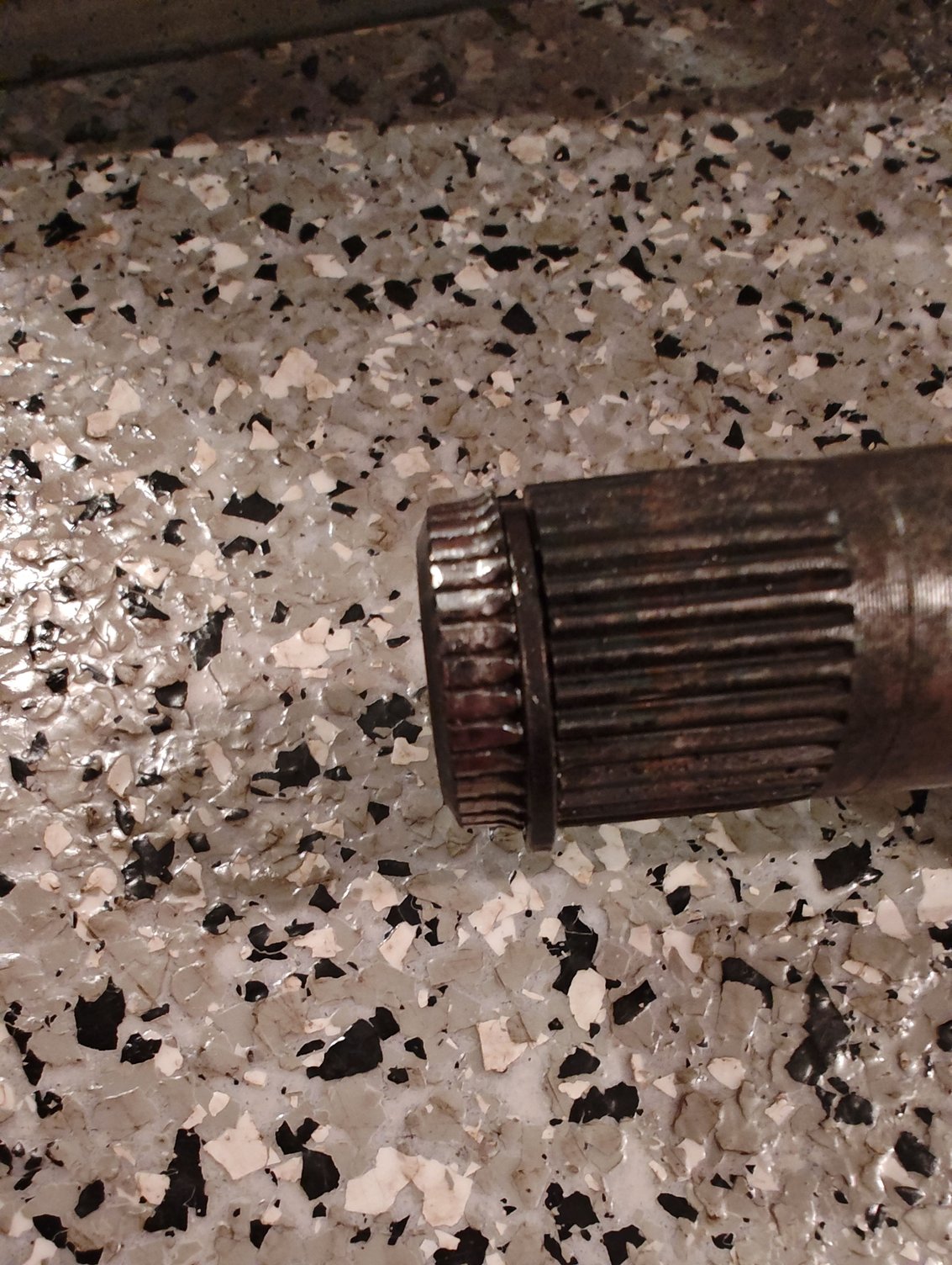

No, I have not yet had that discussion (officially). I'm trying (as always) to understand what I have in front of me before I discuss with him, so I understand his response, my options to remedy, and whether this is a derf-inflicted issue or a new parts/installation issue. Since it is AWD, the pass side cv shaft seats in the transfer case. I already mentioned the "slip" while tightening the axle nut, so it wasn't seated..Here's a pic of the damage.
Pass Side CV splines ----previous statement was incorrect -- major spline damage is driver side, not passenger (sorry)
Pass side (oh how magnification reveals......)
cv axle splines --- passenger side
cv axle splines passenger side - rotated

I drained the transfer case and refilled yesterday. There were no metal shavings on the magnetic drain plug. The gear oil was thinned and in need of change.But that stuff is sufficiently thick I suppose it could have been suspended in the draining fluid......

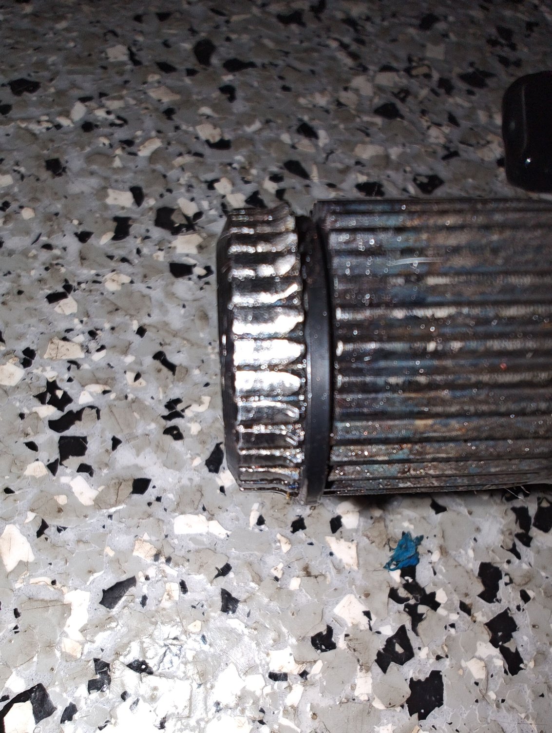

Old Sep 21, 2025 | 11:39 AM
driver's side cv axle splines
drivers side cv axle splines rotated
driver's side cv axle splines rotated
drivers side cv axle splines end on
driver's side cv axle splines end on
So it appears I never got the circlip to engage -- axle must have frozen cockeyed in the splines. I did have alot of difficulty getting this one even to where i did hear it go "plunk" and further and could not be tugged out.
But it was not seated either.
I am learning alot of how NOT to do this. **** happens and we learn from it.
Enough of that.
Your thoughts?
