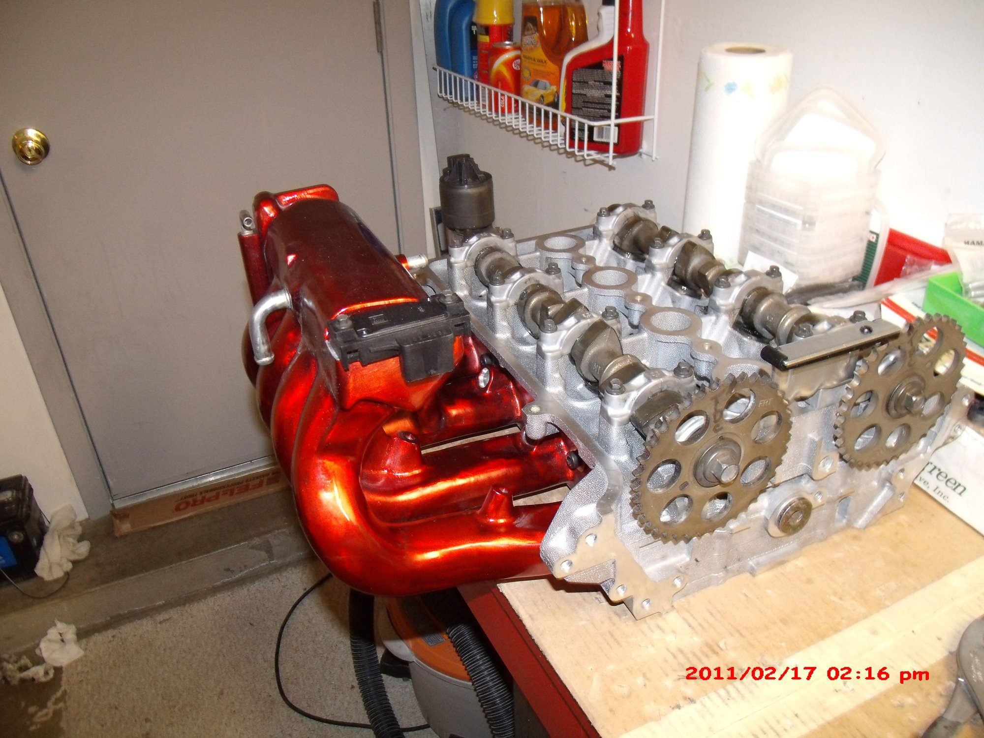

Hi, I'm Thor and my username is Thor4SL2 (catch isn't it). I bought my first Saturn from my step-sun before the turn of the century. He was in the Air Force and had been transferred to Germany. It was a silver SL2 1995 and was just sitting at Wright-Paterson air base in Dayton, Oh. I fell in love w/ its sporty performance and economy. A few years later I snagged a 1995 SC2 w/ a sunroof that I still have. I still think it is one of the best-looking cars for the price. Cars today all look the same to me unless you spend huge bucks. I purchased it off E-bay for $900 from a lady in Ky. It smoked like a coal burner and used about 1 qt of oil evert 100 miles. It was a miracle made it back home to Cincinnati. I still had the SL as my daily driver so off came the head only to find 2 burnt valves in #3
Burnt valve
Burnt valve
cylinder. This started me on a journey to performance modify the SC which I still work on today.
Finished head
Finished head
Head w/ cams & intake

What did you use to paint the intake? I'm about to get mine Media blasted. I haven't considered painting it but I may in order to keep it from getting ugly again.

The paint is Dupli-Color Metalcast Anodized Surface Color System. I used it on the alum valve cover and front timing chain cover. as well. It is like a poor man's powder coating.
NO to turbo, NA all the way.
Other mods include the dual intake cam swap, early Saturn Tri-Y header (heat wrapped) and larger Geo throttle body.
