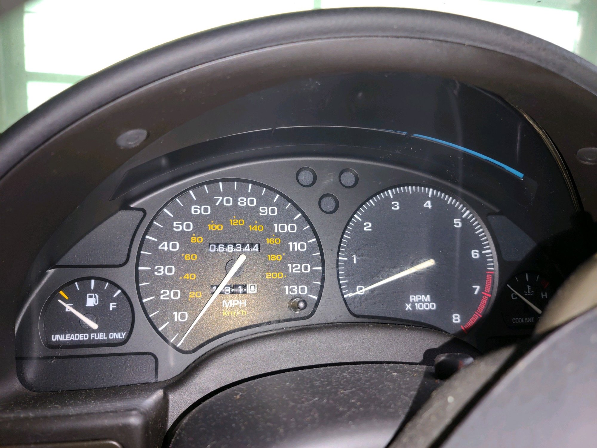

I'm just getting ready to start rehabbing a 1998 SC2 . The car was parked about 5 years ago in a garage, and we're getting ready to move it into our working garage and I have no information of the cars history (i.e. suspension condition etc.), other than the car shows 68000 miles and interior appears in good shape but for the headliner over the rear seat is falling down some. Maintenance is reported to have been regular i.e. oil changes etc.

That's a 98 SC2 I do believe.
Black gold metallic DOHC, automatic.
I would drain as much oil as you can cold before starting it for the first time while changing the filter Measure how much you took out and add back whatever it takes to make a total of 4.0 quarts in the vehicle.
