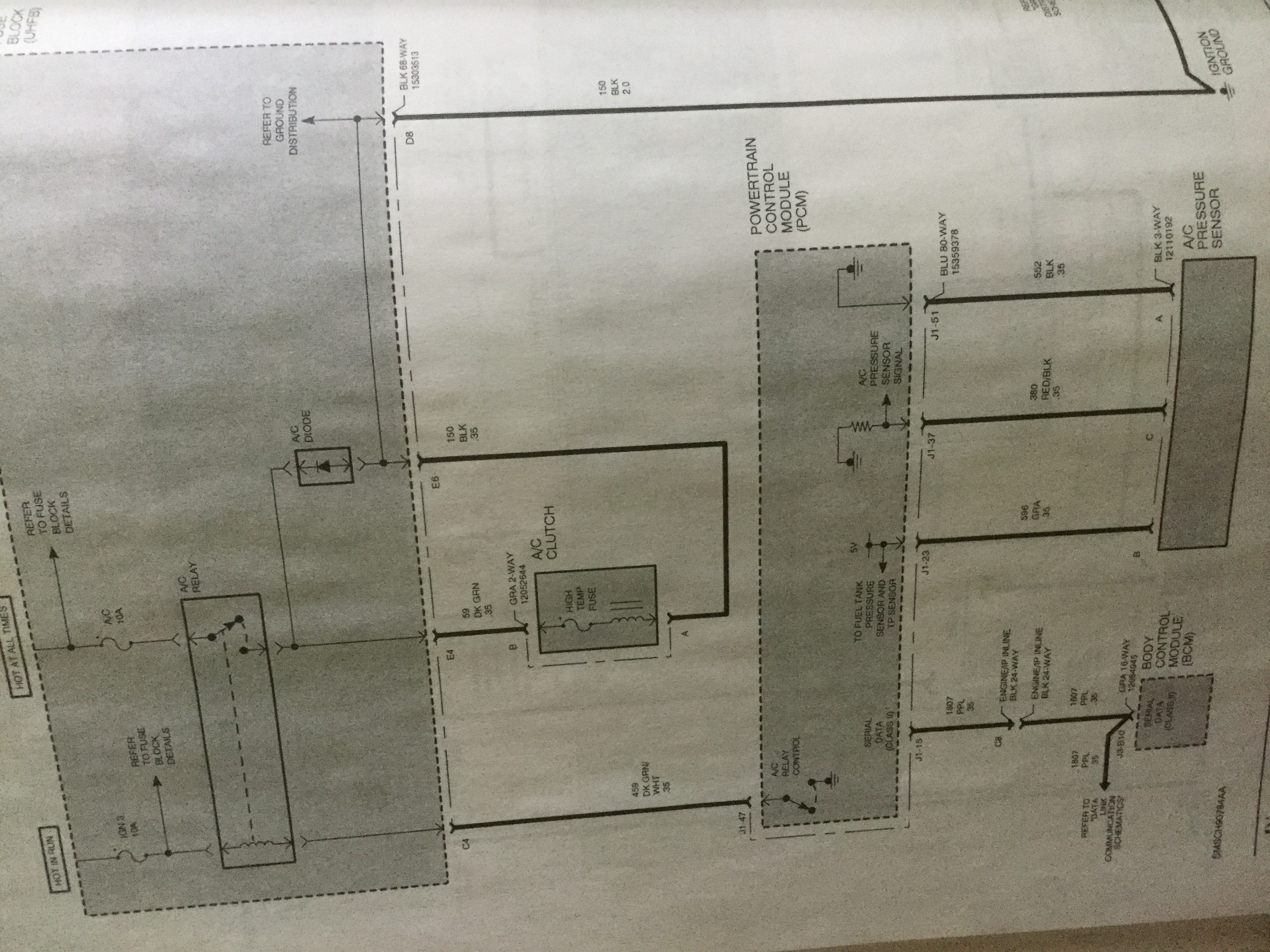

When The air conditioning diode on a 2002 L series in put in backwards, it should just blow a fuse. However in the real world when you connect 12 volts + to the 12 volt - problems can cascade back upstream.
Attached Thumbnails I am new to this forum. Hope you all can help me out!-e34d0b74-e698-4a18-a3b9-edebbd9a0396.jpeg
Old Jul 4, 2018 | 10:58 AM
Yes there is a fusible link in the system down by the starter.
